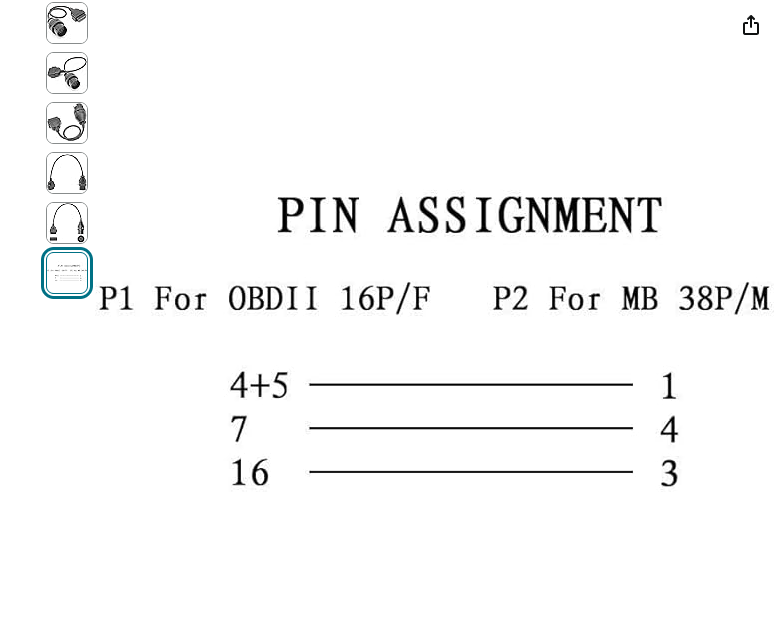

Im still curious if the vehicle has the 38 pin in the engine bay and also a 16 pin under the steering wheel? From other forums it may appear only US and Japanese spec Mercedes have both?

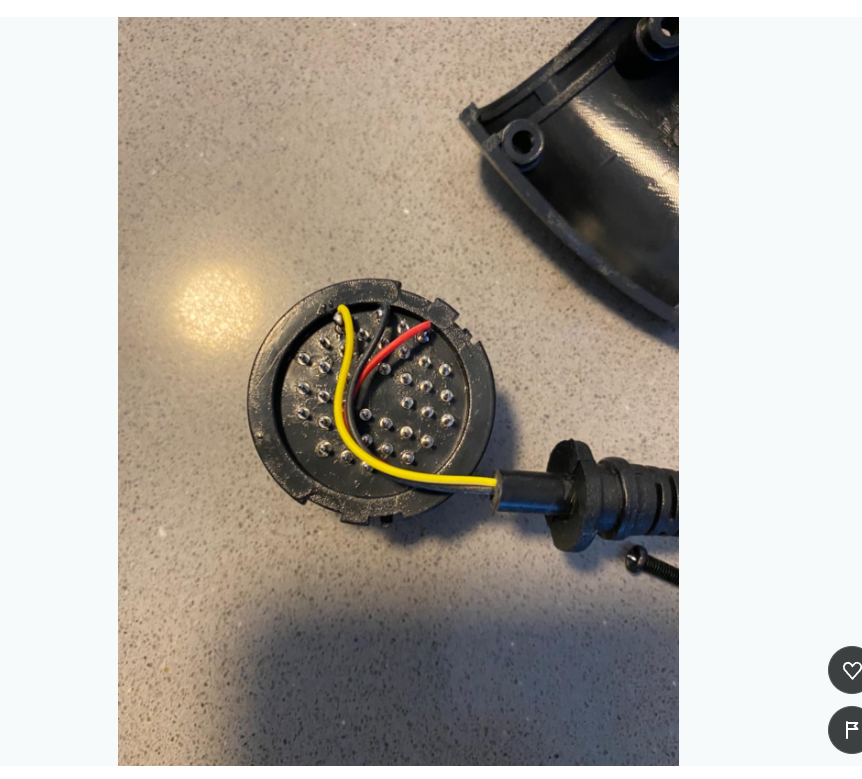

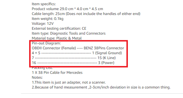

I was looking around at what the 38 pin adapters actually do, looks like it is only 3 wires in them, or at least the cheap ones.

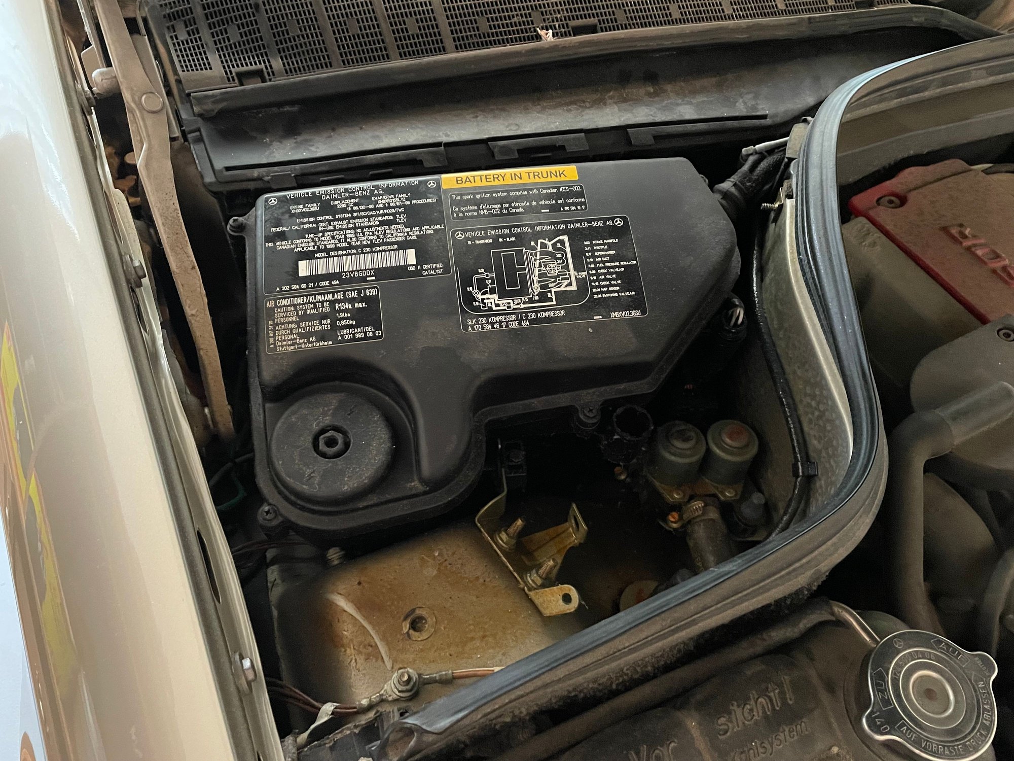

I've never seen that (38 pin). Can you post a pic? Thanks

Sure, car is not at my house for the winter, however I plan to go there this week and will take a picture

I do wonder how the 3-wire 38 pin adapters work and how useful they are.
I dont even know how my obd reader really works so did more reading. I keep seeing people with early 96-2000 MB's saying that the obd port under the steering wheel isnt that useful, that most diagnosing is used at the 38 pin. But then if that adapter only sees k line how much can it really do? I dont know.
I did come across an Godiag GT108 tool/adapter that shows it connecting to more pin outs. I think that may be why some say the MB Star C4 is a great option for earlier Mercedes, it has the right software needed.

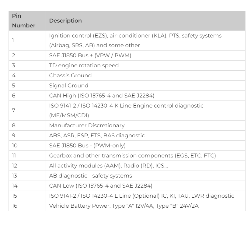

Heres the MB obd2 pinouts:
Heres info on that Godiag GT108 adapter:

38 pin connector
I
38 Pin connector
38 Pin connector
38 pin connector
38 pin connector

Thanks. I'm guessing the receptacle is under the round black rubber (?) cap in the second pic.

Yes that’s correct, It’s right rear (passenger side) under the hood.
