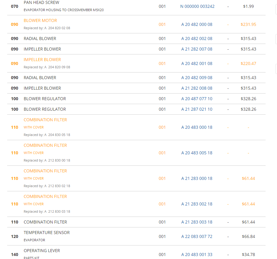

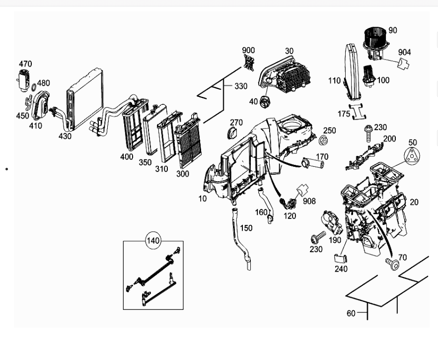

May be a failing blower motor resistor.
I see they call it "Blower Regulator". Part 100. if it is faulty make sure to check the part# of the one installed in the car before replacing.
