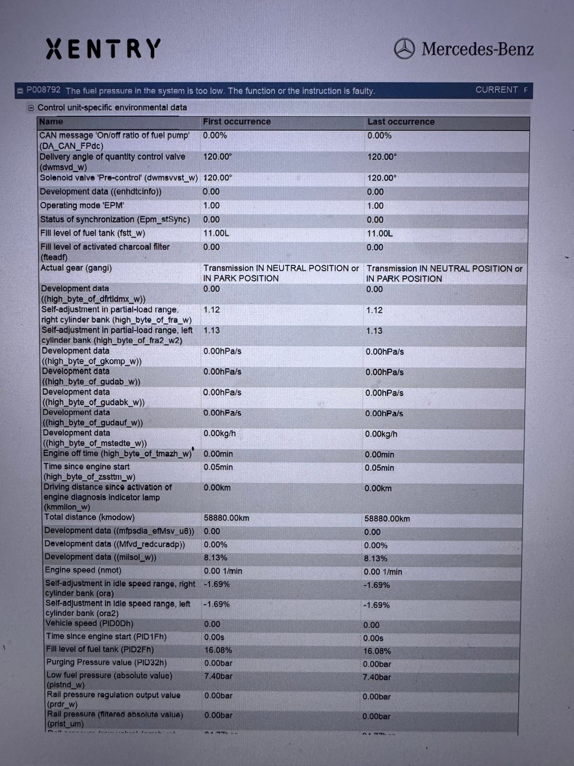

Error Code P008792 (Fuel pressure too low) since 60km occurred and not found yet the problem!! (Changed Fuel Pump, Fuel Filter & Fuel Pressure Sensor that is in fuel filter but didn't help) W204 C350 2011 1313/BTE ... Can someone tell if someone faced same error code and found a way to get rid of?!

I read your screen cap showing 100Bar pressure
with a low pressure fault
​​​​​​at 60k.Km
What engine type: a GDI?

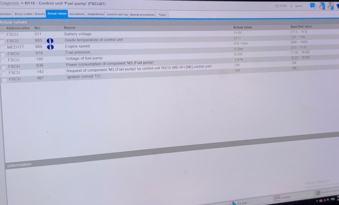

You've replaced in-tank hardware and sensor without improvement.
Let me ask you WHERE the fuel pressure is low?
On the common fuel rail itself, right?
> False low pressure:
How is the engine running??
-- nearly normal ??
-- super bad ??
The answer will help you focus on bad sensor or bad pump.
I side with bad rail sensor.
Confirm this with a dial gauge.

Engine runs nearly normal but sometimes, not often, is stalling! its CGI motor code: m276.957 (V6 Engine)! I cant find really where exactly where is the Fuel too low coming from!

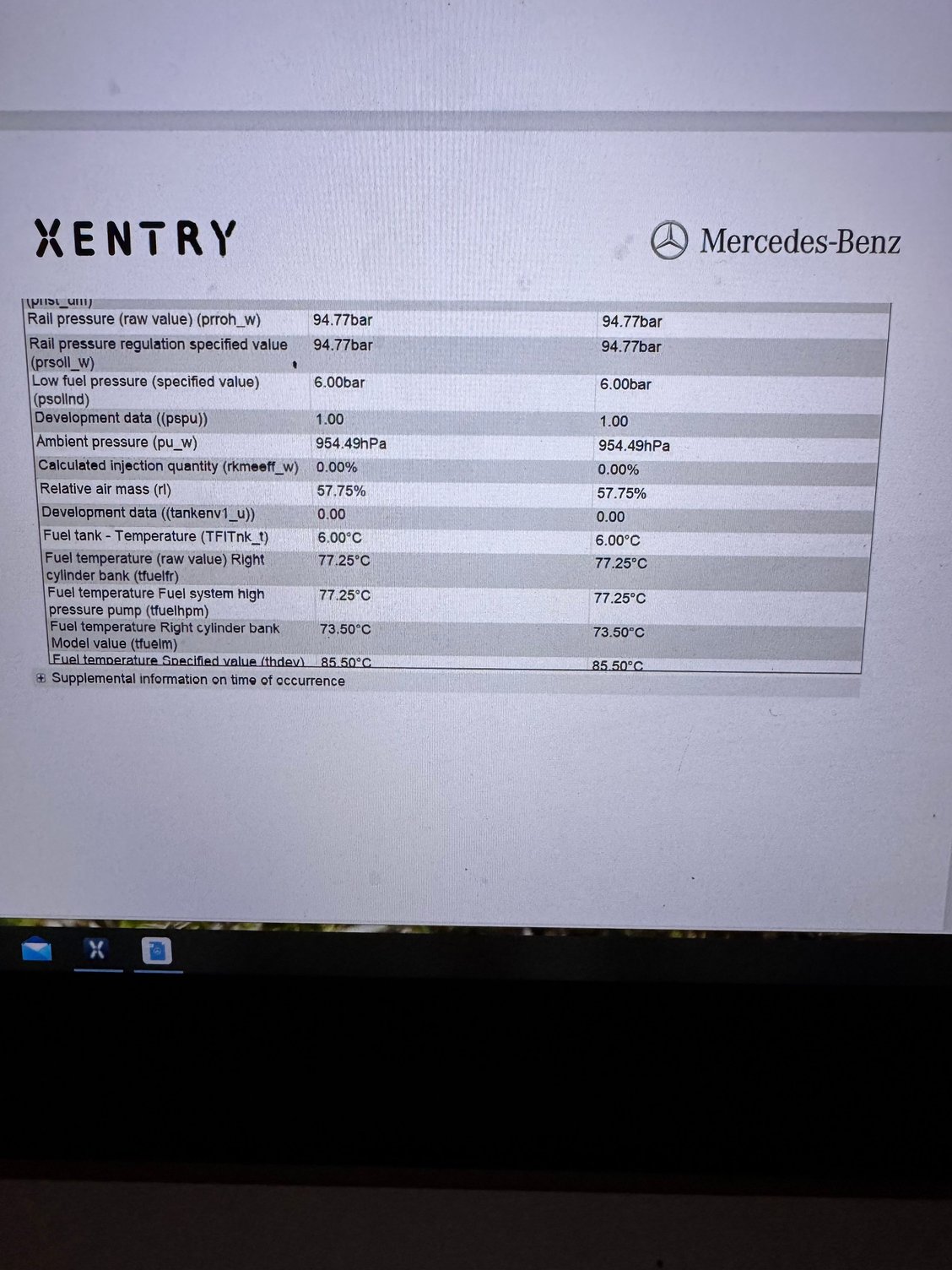

Nice... W204 sporting M276 GDI: 4 timing chains, 3 fuel pumps!
-- This fault is called directly by the Bosch ECU itself!
-- M276 has a high pressure pump managed directly by the ECU with a pressure control.
-- You can read the pressure sensor under the ECU heading.
> What makes this the fuel rail sensor and not the pump is... the engine runs nearly well.
> While you're fixing your fuel sensor...
-- Do inspect cam sensors for oil leaking in harness
-- and install a set of cheap sacrificial pigtails to prevent $10k repairs
-- Furthermore consider replacing your 2x limp chain tensioners, CPS sensors (inspected above) and upgrading to better oiling. Stock uses low pressure under 3500.Rpm: not good!!!
Better oiling will protect and quiet your HPFP Roller, camshaft lobes and VVT Gears before lick pins start rattling terminally.
