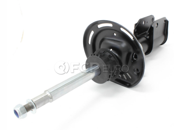

Strut looks like this with 2 bolts holding it to knuckle

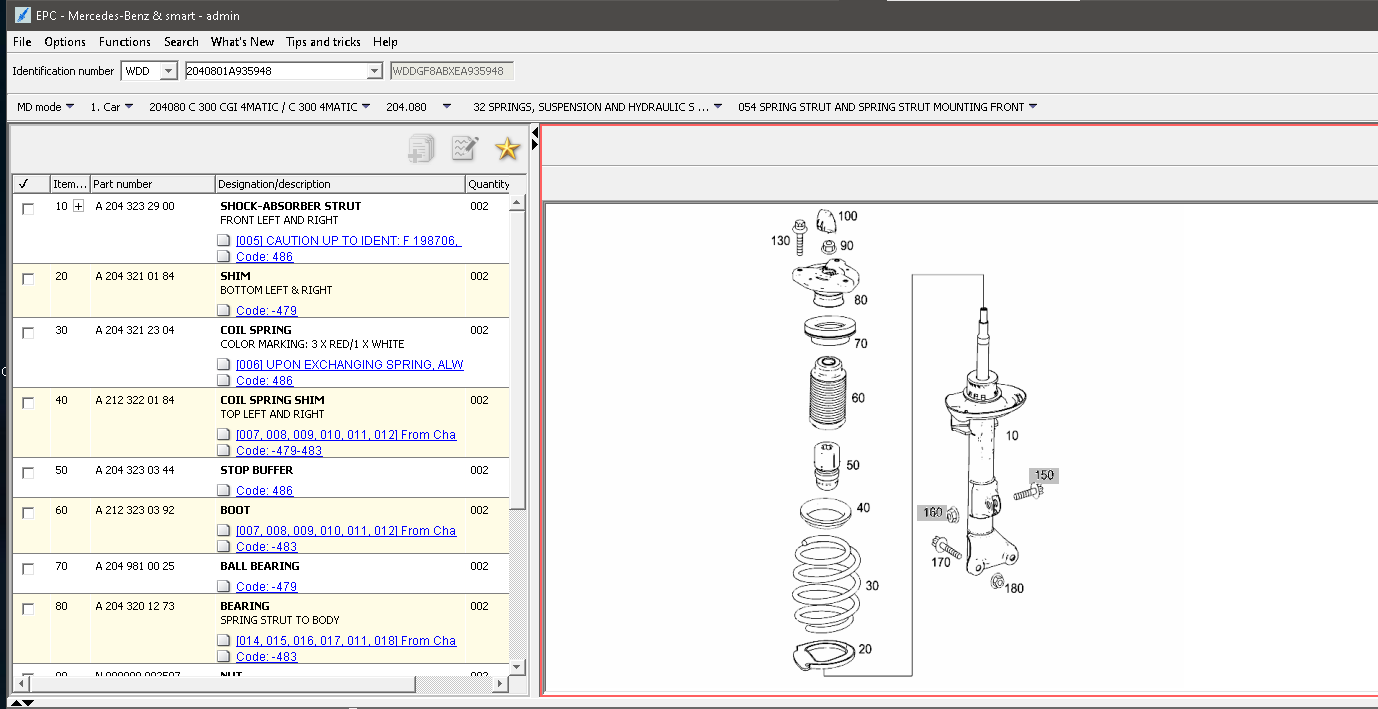

Here is the diagram from the EPC. It's for a W204 C300 4matic. Looks nothing like your picture. That's why we need your VIN.

Apparently, you have the Luxury model. The above is for the Sport model. Your VIN will help finding the part.

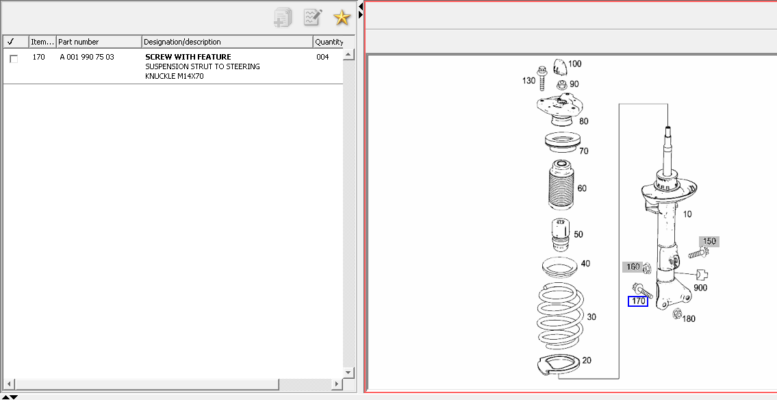

The bolts are part# 0019907503
Nuts part# 0019908454
Old Jan 5, 2025 | 02:57 PM
TimC300's Avatar
Joined: Aug 2023
Posts: 3,847
Likes: 1,172
From: MA Coast
M14x70
Sway bar link torque spec 98nm.

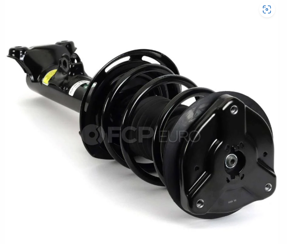

Heres the strut:

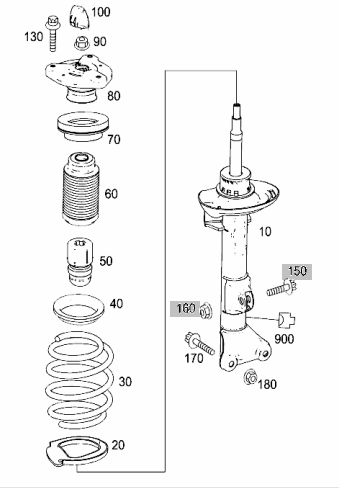

@TimC300 here is the problem with what you posted, not that you are wrong, but something doesn't align. Item #170 has the part number for the bolt you are showing, but I would see that as the "strut to body" bolt which is torqued to 33 Nm (or is that item #130?). The bolt and nut are torqued to 120 NM + 90 degrees. Unfortunately, we need part numbers for items #150 and #160, which I can't get without the correct VIN or model designation.

They use the same diagrams for the 4matic and the RWD suspension.
Heres the part #'s for the 4matic.
Heres the part #'s for the RWD: (RWD does not use part 180)

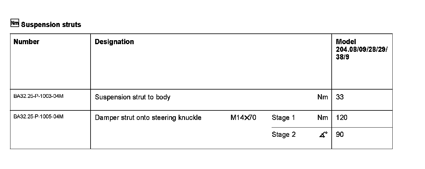

Here are the instructions from the WIS. It at least provides bolt dimensions and torque specifications.
