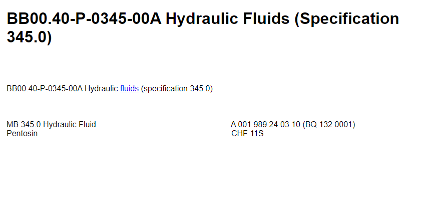

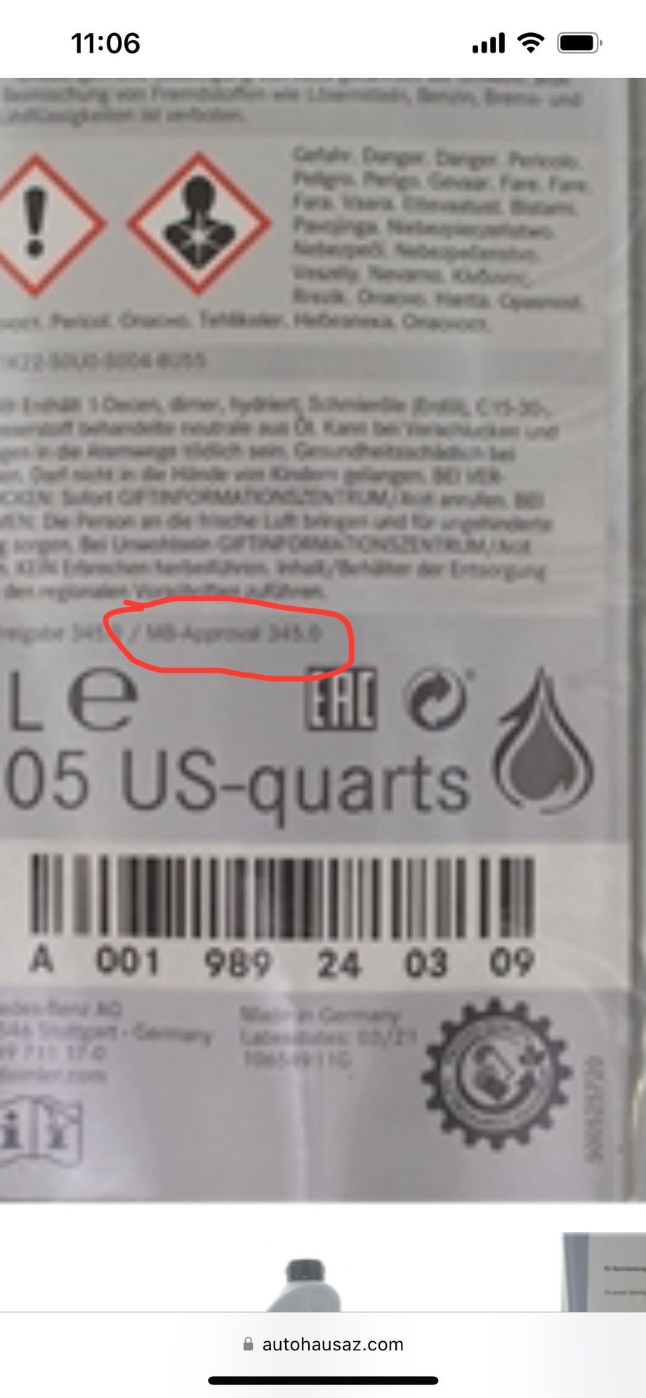

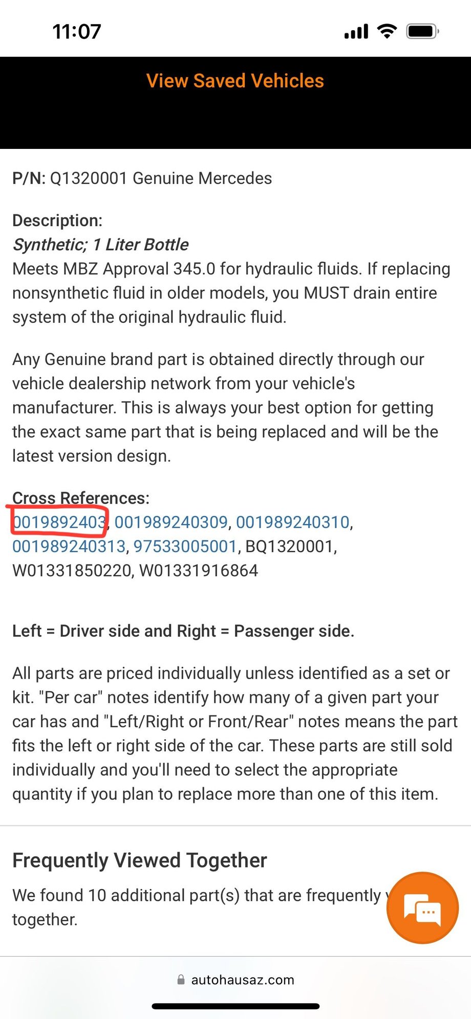

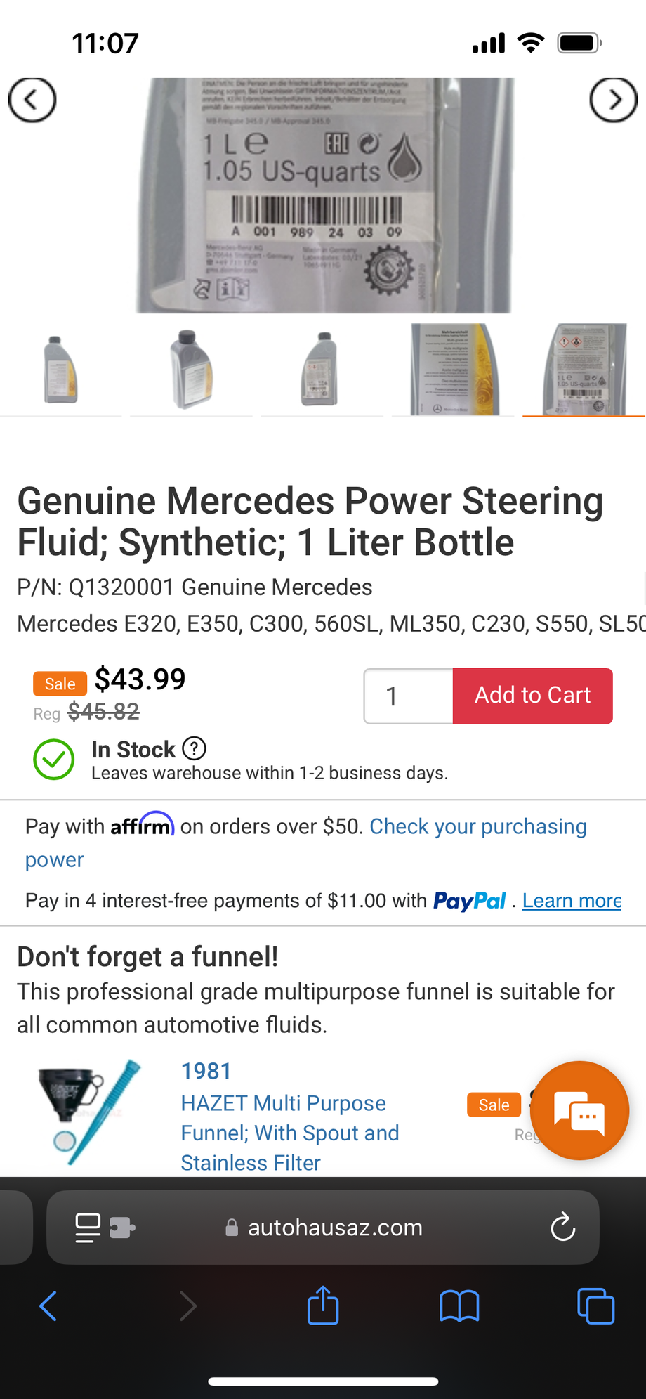

I have a 2008 C300 4Matic. I have read the forums on here with the other brands that are recommended, but I’d really like to use genuine fluid. I read a lot of debate between if MB 345.0 or 236.3 is correct for the power steering as well, but I couldn’t find any one clear answer.
Is this fluid the correct one to use? It has MB 345.0 approval in small font on the back. And for those of you who have “flushed” via extracting fluid from the reservoir, letting it mix, and then repeating, how much total fluid did you use? Should I get 2L to be safe or is just the one ok?

just use Pentosin CHF-11s. It meets the 345.0 and is a very well known fluid. It is synthetic.
That genuine MB fluid is fine if you hate money.
That 236.6 spec is for much older cars up to around W202.
