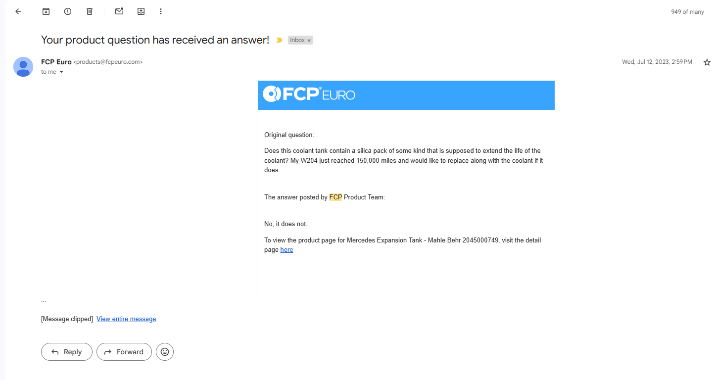

I heard there was some type of silic packette in the cooling system but I can not find it mentioned anywhere in the repair/maintenance manuals. I came across alot of VW people who shows some type of packette in the coolant reservoir. I wrote to FCP Euro asking if any of the replacement coolant reservoirs they sell come with a packette and was told no.

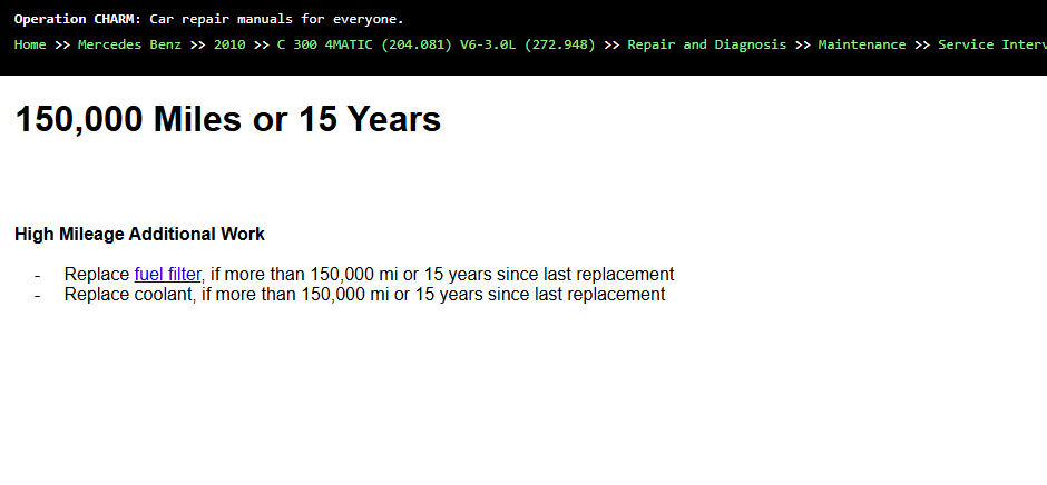

My 2010 Maintenance manual says replace coolant at 15yrs/150,000 miles. Then after that the next time it mentions to replace the coolant is after another 15yrs/150,000 miles.

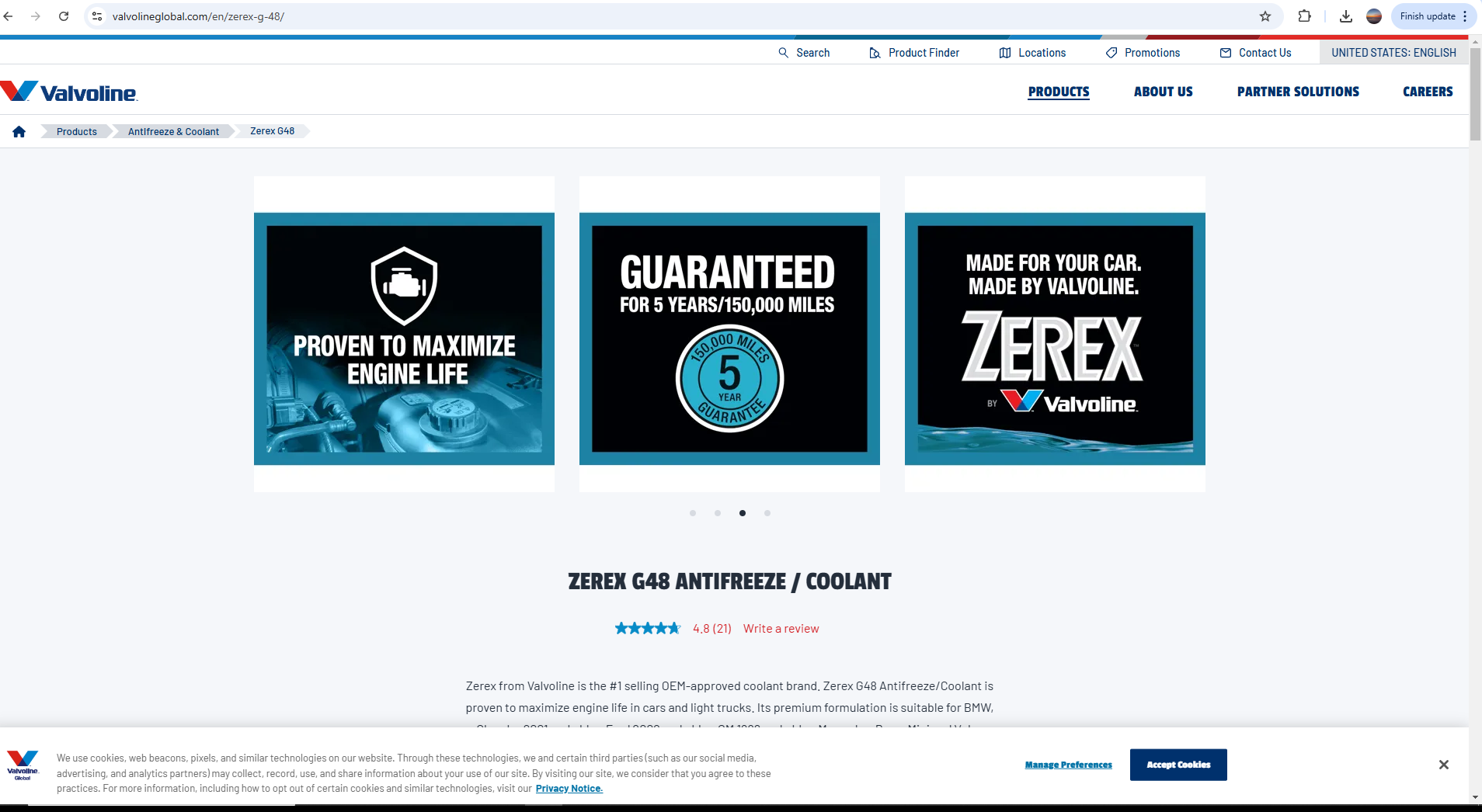

I find it interesting that Zerex itself shows 5yr/150,000 miles guarantee, not 15 years. Mine is now over 150,000 miles so i will be replacing the coolant sooner just to be safe.

I'll have to search more for the silica pack. I went back and looked and I guess I asked about the Mahle branded reservoir, not the genuine MB.
