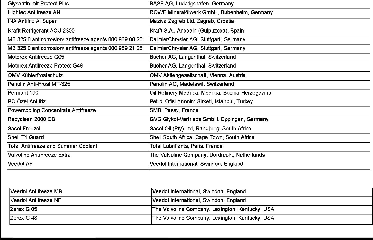

Zerex G05? Is that what it calls for? I only ask because my 2010 4matic M272 engine uses the G48. Its the blue/green color. When I replaced the oil filter housing gasket/oil cooler gasket I bought two jugs of the G48 50/50 pre-mixed and had some left over.
Nevermind, i see it at the bottom.
What’s in my engine right now is a blueish green as well, but when I was searching online it said that 2008 model year in the US used G05 coolant from factory. I haven’t cracked open the current bottles I bought to see what color they are. Should I go exchange for G48? I am a regular at my local advance auto and they’ll definitely let me exchange them without a hassle of getting refunded and having to buy again.
I see you updated your post since I replied, but I might go exchange for G48 anyway. What’s in there already is definitely that same color, and it seems G05 is a gold color from my quick research. I’ll have to fix that tomorrow, and good to know about how much coolant you used as well. I may return one of my bottles as well.

Im not sure why the G05 is listed in that list. I got it from the 2008 c300 4matic manuals. Under Cooling here: https://charm.li/Mercedes%20Benz/200...d%20Diagnosis/
I looked it up on the Zerex website and plugged in 2008 C300 3.0 and it shows "Does not fit". Mine is a 2010 with the M272 and the blue/green was in there and I used the G48. When I had my car worked on recently at the MB dealer they billed me for Zerex G48 coolant.
I did not drain the entire cooling system when I did the gaskets. I didnt even touch the drain at the bottom of the radiator. I simply removed the thermostat out of the way then removed the oil filter housing from the engine. I just let the coolant flow out. Then with the oil filter housing off I replaced the oil cooler gasket. I wasnt sure where the leak was coming from so I changed both gaskets. I made a thread with all the parts i used, tools and torque specs. It turned out to be pretty simple.
My car had over 150,000 miles so the manual says the coolant needed to be changed anyways. The old coolant looked to be in great condition so I wasnt worried about not completely draining it all out.

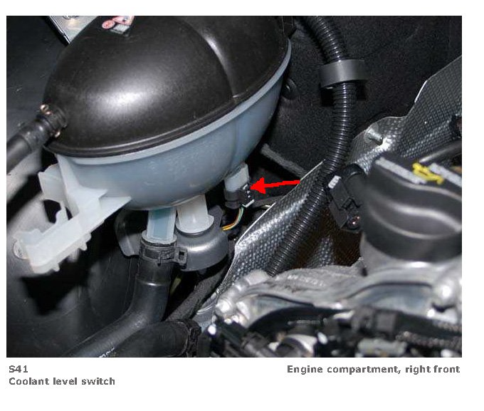

While we’re on the topic of coolant as well, does anyone know if it’s normal for the coolant hoses (all of them) to feel thinner than other manufacturers do? This is my first Mercedes, and every other car I’ve ever had before had some fairly firm radiator hoses all around. I noticed that all of mine feel rather thin and are easy to squeeze, but they’re all exactly the same feeling. Unsure if I should replace them all or if MB just uses a more flexible material than I’m used to.

Also its never completely empty. Some oil sits in the cooler, and the bottom edges of the pan.
Check coolant level is because the sensor is RIGHT there at the halfway mark so if you slosh it around it can think its empty when its really not. Whats funny is the fill level mark is up to slightly past the sensor anyway. You'll know when the sensor is going out because itll start leaking and itl fail electronically. MB hoses probably just feel different to you. They last a really long time though. I've never had to replace a hose on anything so far. If you need some stuff to replace right now, you probaly have the PCV cover thing on the back that is leaking, the cam caps, and that big 65mm cap on the right side. Inspect your cam magnets and sensors and buy an 8mm wrench so you can tackle them without removing the power steering reservoir on the right side.

Yeah it sounds like your sensor is going out, I'd replace the tank, cap, and sensor in that case.

My understanding is that the sensor is built in to the tank, is that correct? I ordered a new cap and am holding off on the reservoir for now while I research more. If I need to order the sensor too then I will but I want to confirm that they’re on piece.

Looks built-in to me. Im not seeing a separate part # for the level sensor, just shows the tank then the connector for the sensor.

My Audi had the same issue with my coolant tank. Was saying level was low but it fine. Sensor was built into the tank. The sensor gets gunked up or corroded.

I wonder how the sensor works, is it a float type sensor? Someone should cut the reservoir open if they replace it to see what it looks like in there.
If the sensor is going off may check the connector for any corrosion. I was searching around to see what the sensor looks like and came across some photos of other Mercedes in general where the plug was corroded and needed to be cleaned off.. Looked like most of those were leaking so had to replace the reservoir anyways.

I work on multiple makes, Porsche's is a sealing sensor for some reason so it develops leaks and goes out.. same logic would apply here though yeah. Honestly there are pretty inexpensive fixes, the URO tank has worked in a pinch for me
I ordered a new reservoir last night. When I replace mine, I will cut it open and try my best to show you all how it works. I’ve been wondering myself, and I think that a float sensor makes the most sense. I ordered from 3 different websites for the best prices on everything I needed, so once it all arrives I will be tackling the project.

We're talking about the coolant level sensor here? (The opening thread was about oil.) My coolant level sensor is a simple 2-electrode arrangement that uses the coolant's electric conductivity -- no moving parts. But it's possible that electrodes could develop corrosion and malfunction (although I would think coolant corrosion inhibitors would prevent this).
We got a little off track, lol. My original question was answered quickly and then found out I bought the wrong coolant so here we are. And that’s interesting, mine is (I believe) beginning to fail. I wonder where it has failed in that case.
