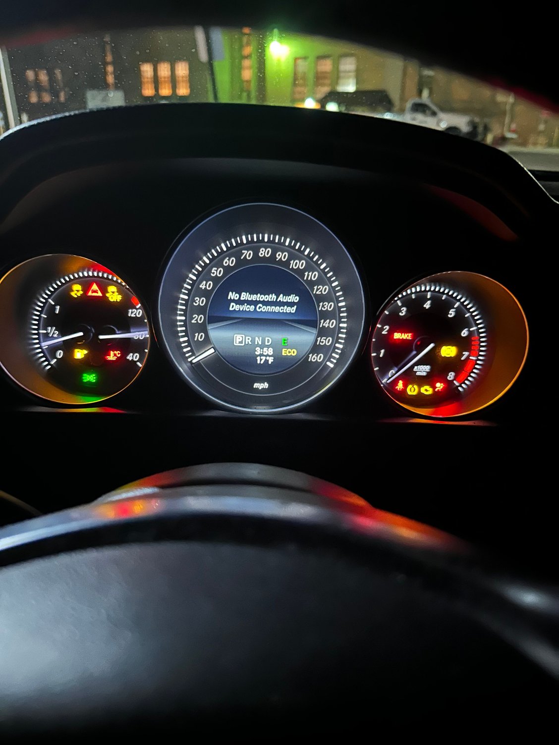

I checked my 2014 c300 and it looks like pretty much every light lights up on unital key turn/lamp check

Ahh thank you for the excellent picture.
I must book time at Mercedes dealer to fix this.
My local mechanic have paired the tyre sensors. But this seems not enough.
