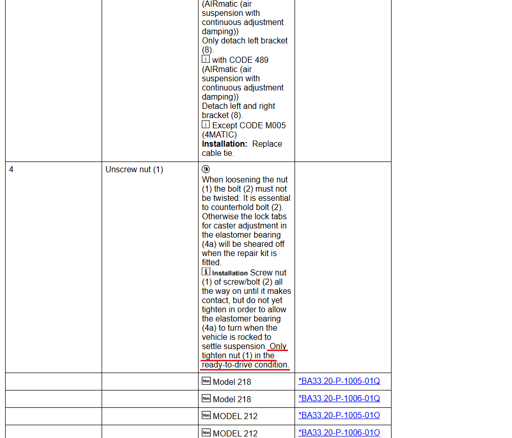

I hope you tightened the suspension arm at ride height.....otherwise the bushing life will be short when and if it was tightened during full suspension droop.

As noted above make sure the nut and bolt at the inner bushing side is tightened down in ready to drive position- car resting on its wheels.

I did mine with a floor jack in my driveway. It is just a ball joint and 1 big 21mm bolt. You need a long ratchet, 21mm wrench, and a ball joint separator from AutoZone. If you tighten the control arm at a 90 degree angle you don't need to torque at ride height. I put my car on ramps and torqued it at ride height anyway, but it is not required if you do it right.
