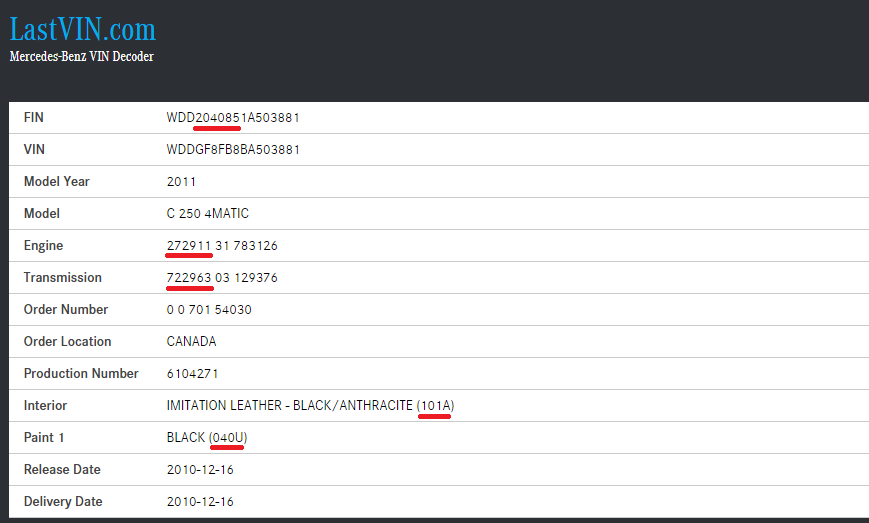

VIN: WDDGF8FB8BA503881

Tires should be replaced at six years, regardless of tread depth. That is because the rubber will rot in that amount of time and the belts may begin to separate. Be sure to check the insides of the tires as they may look fine on the outside. (The inside side of the tire, not the interior of the tire.) You can find out how your car was equipped from the factory by entering your VIN in www.lastvin.com.
https://www.lastvin.com/vin/a8NMV2ozZ4KEQln9y
You have the 722.9 (7G+) transmission (build code A89) meaning you use the ATF-134FE (blue) fluid.

There is alot of useful info from looking up the vin. Mainly it helps when looking up the correct part 3's since there are all different variations.
When I looked up my vin I printed all the pages out so I can look at it easily whenever I need it.
You have the 204.085. Bookmark this website, it is your specific parts diagrams: https://nemigaparts.com/cat_spares/e...fg/204085/62p/
- Engine 272.911
- Transmission 722.963 with code A89. This is the later version, useful to know when ordering trans fluid and filter.
- You have option 486 Sports Suspension. Good to know when ordering replacement struts, springs.
