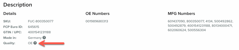

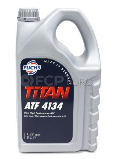

Originally Posted by hmclaughlin67
Edit: On that note as well, what transmission fluid do you guys recommend? Genuine fluid or has anyone had any luck with that Fuchs Titan 4134 stuff?
The Fuchs stuff is OE, meaning it's what Mercedes fills its jugs with. Previously it was sold under the Pentosin name (and still is in some quantities). I've used it and when I last had my tranny serviced by the local Mercedes dealership (they let me provide my own parts), the tech said that Pentosin/Fuchs is what is in the Mercedes bottles.
Just make sure you get this stuff and NOT the FE.
