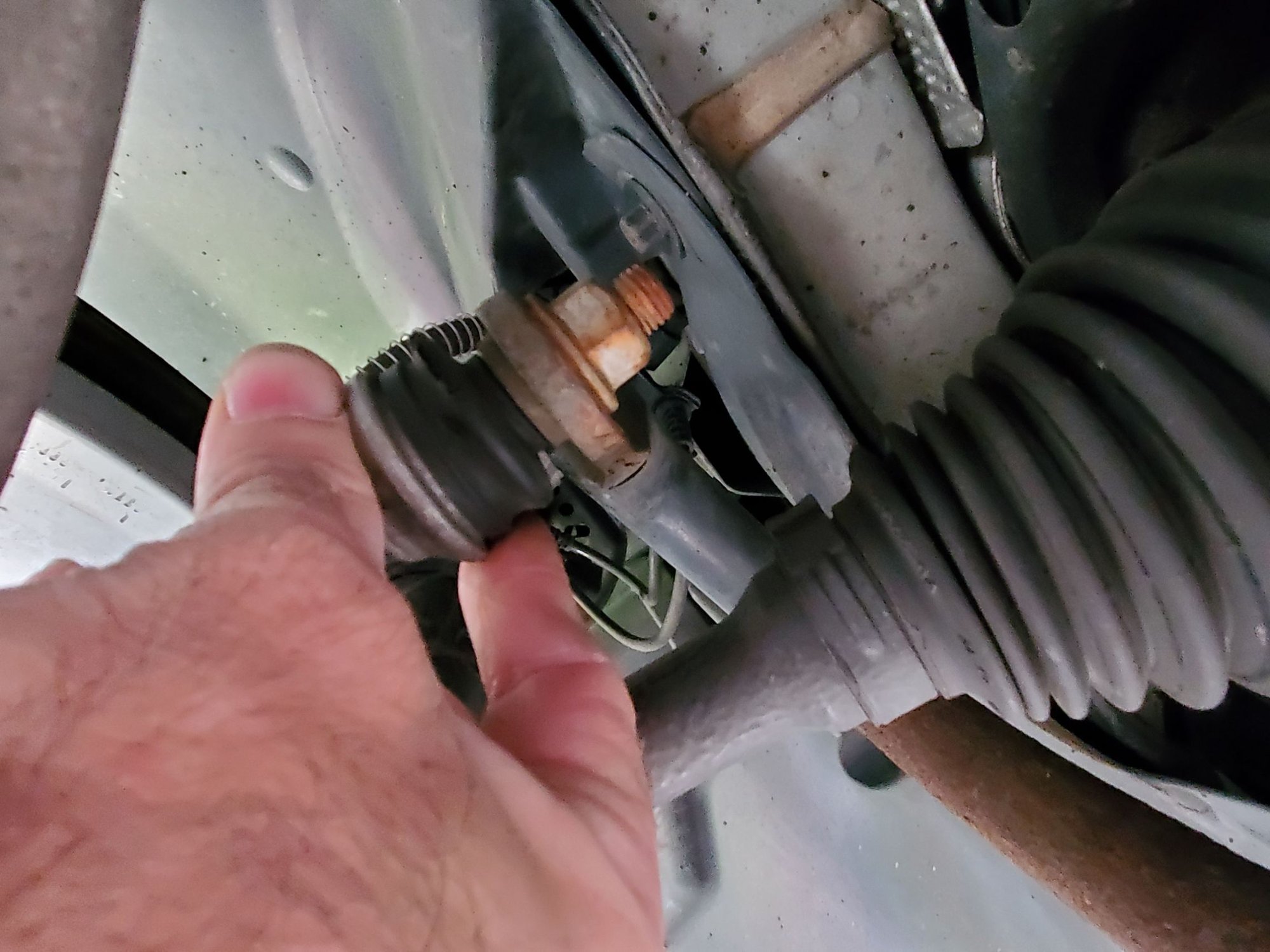

I wanted to update this with a resolution to the issue...
It was the Sway bar links. They looked relatively new, the boots were intact, and still grease in the ball joints, but they were so loose that I could move the ball joint with one finger with little effort. It's nice to drive when people outside the car don't think something is about to fall off of it and run for cover.
