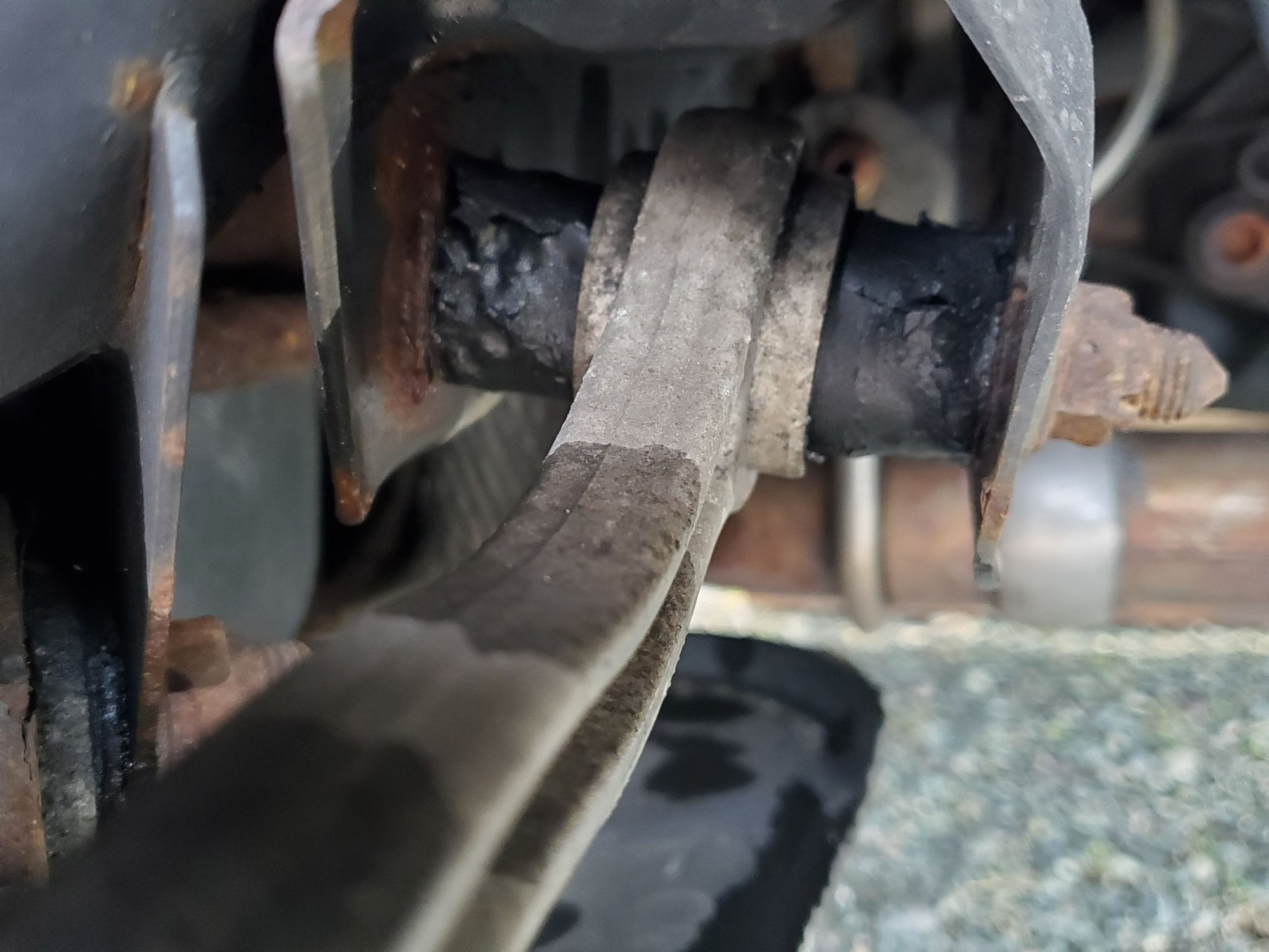

Have you inspected the control arm bushings? The bushings may be worn. The bushings on mine are looking pretty deteriorated and will need to be replaced at some point.
Below is the thrust arm bushing in the wheel carrier.
Wheel carrier with spring arm bushing and thrust arm bushing.
Inner tie rod bushing:
Great, thanks!! Do we need a press for these or can we tap em in/out with a few hefty hammer swings?

Originally Posted by knavejack
Oh and this one has ~155k miles, I picked it up at ~140k in 2020-ish. I don't have to drive it much, obviously.
I will be really be surprised if you don't need bushings.
