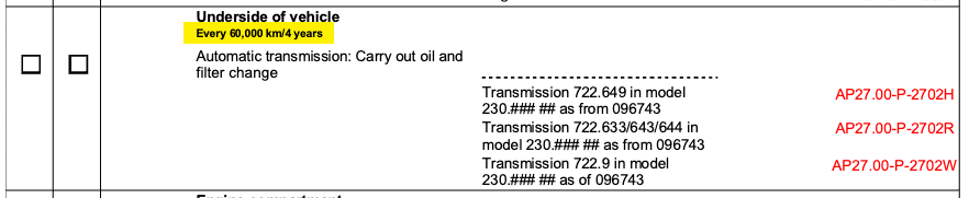

Not sure why this is so complicated. It's the same concept of changing your oil. You drain the fluid, and then you re-fill the the fluid. And change the filter.
In the exact wording of the MB W204 service sheet: "Automatic transmission: Change oil and oil filter."

2011 Service Booklet. It says: "Service 20 - once at 60,000 km, or 3 years"
I concur with what @BlackML550 said. 60,000 km is approximately 37,000 miles, which is the interval you want to use for the 7G tranny (not 7G+) which you have. To know for sure, enter your VIN on www.lastvin.com and look for Code A89. If you don't have it, then you DO have the red fluid (MB 236.14).
