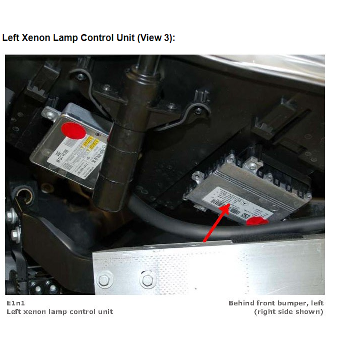

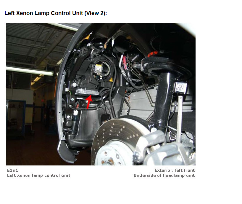

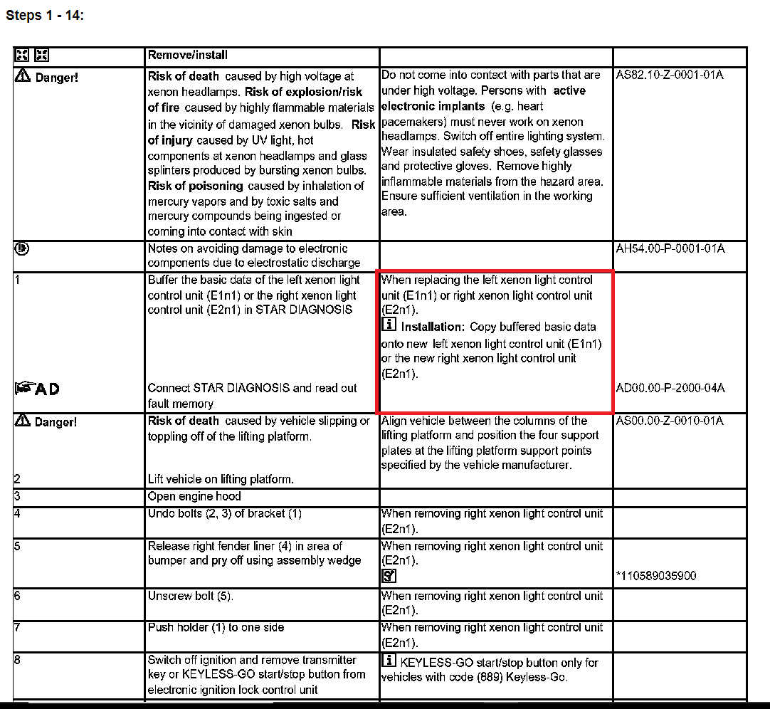

Looks like removing the forward section of the wheel well liner will give access to the headlight control units. Im assuming the unit directly below the low beam bulb is the lamp control unit or the "ballast". In the manual it mentions transferring data over to the new unit. i cant find the reason why though, what it does.
