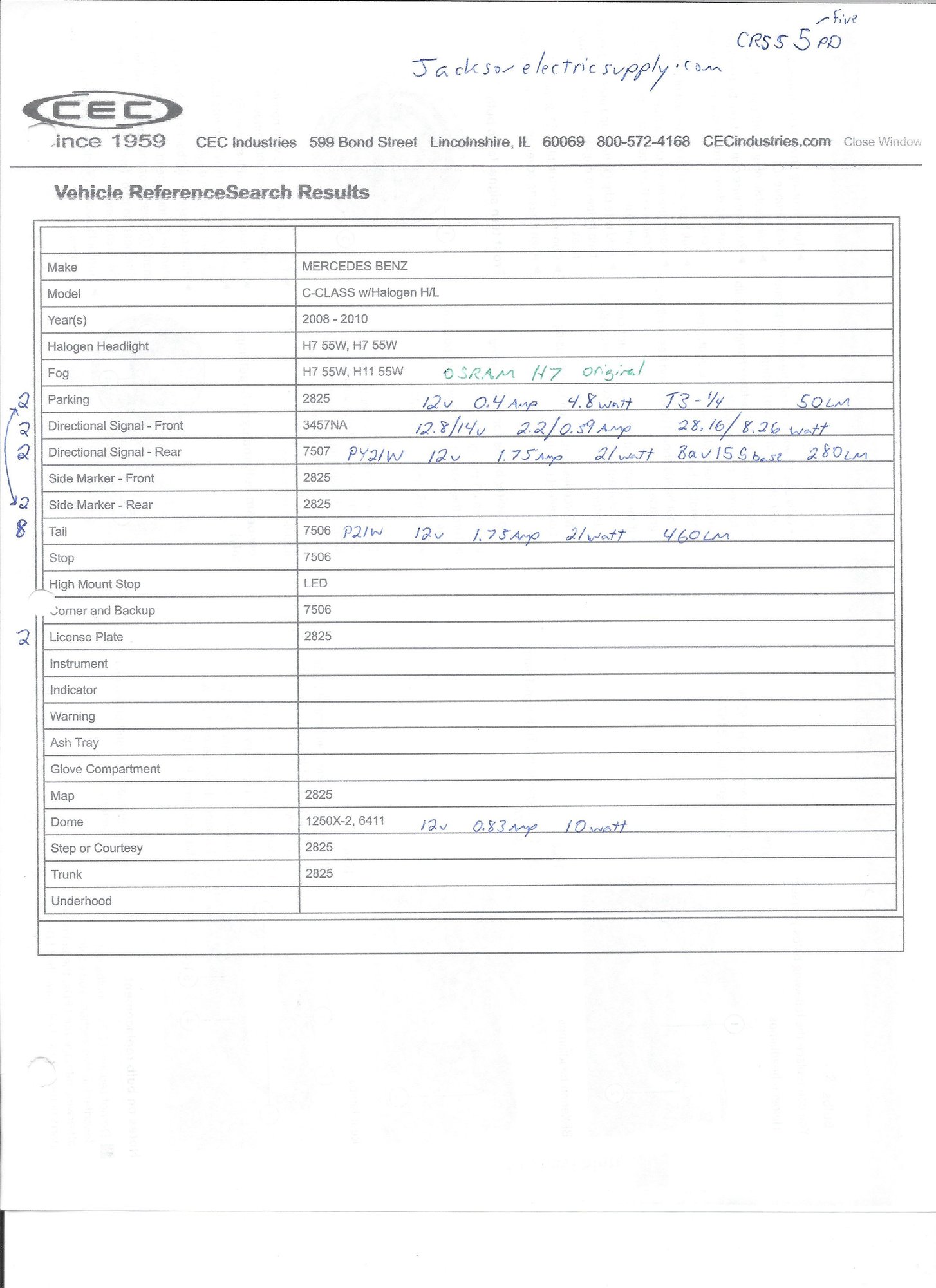

When LED bulbs were first coming out years ago i installed some in my car and had to experiment with different resistors to get them to work/flash properly. I remember they got screaming hot. Now i just stick to the recommended bulbs, except for the low beams where i replaced the halogen for an HID kit.
Im guessing the LED bulbs you installed arent the correct ones. I have no idea which ones would work. i would stay away from the low priced ones.
You will have to match the voltage of the original bulbs. I wrote them down on the bulb sheet.
