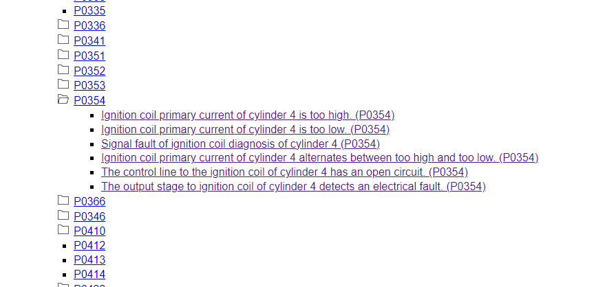

Curious about the MB code.
This is what I have for M272 engine:
0987 - Ignition coil primary current cylinder 5 (P0355)
0986 - Ignition coil primary current cylinder 4 (P0354)
Your initial problem was posted as P0354.
Could something else be going on? You cleaned the coil connectors with electrical contact cleaner. Does the battery voltage hold steady at 12.6V or more? It’s usually about 13.5V with the engine running.
Have you cleaned the ECU connector? <- First disconnect the battery, and only spray the wiring harness connector.
Can you monitor the fuel trims? That can be diagnostic for a problem with injectors, but it only shows performance by cylinder bank. One leaking injector will cause the ECU to lean out that bank maybe starving the other two cylinders.
I skipped from M112 to M276, so I’m not familiar with M272 idiosyncrasies.

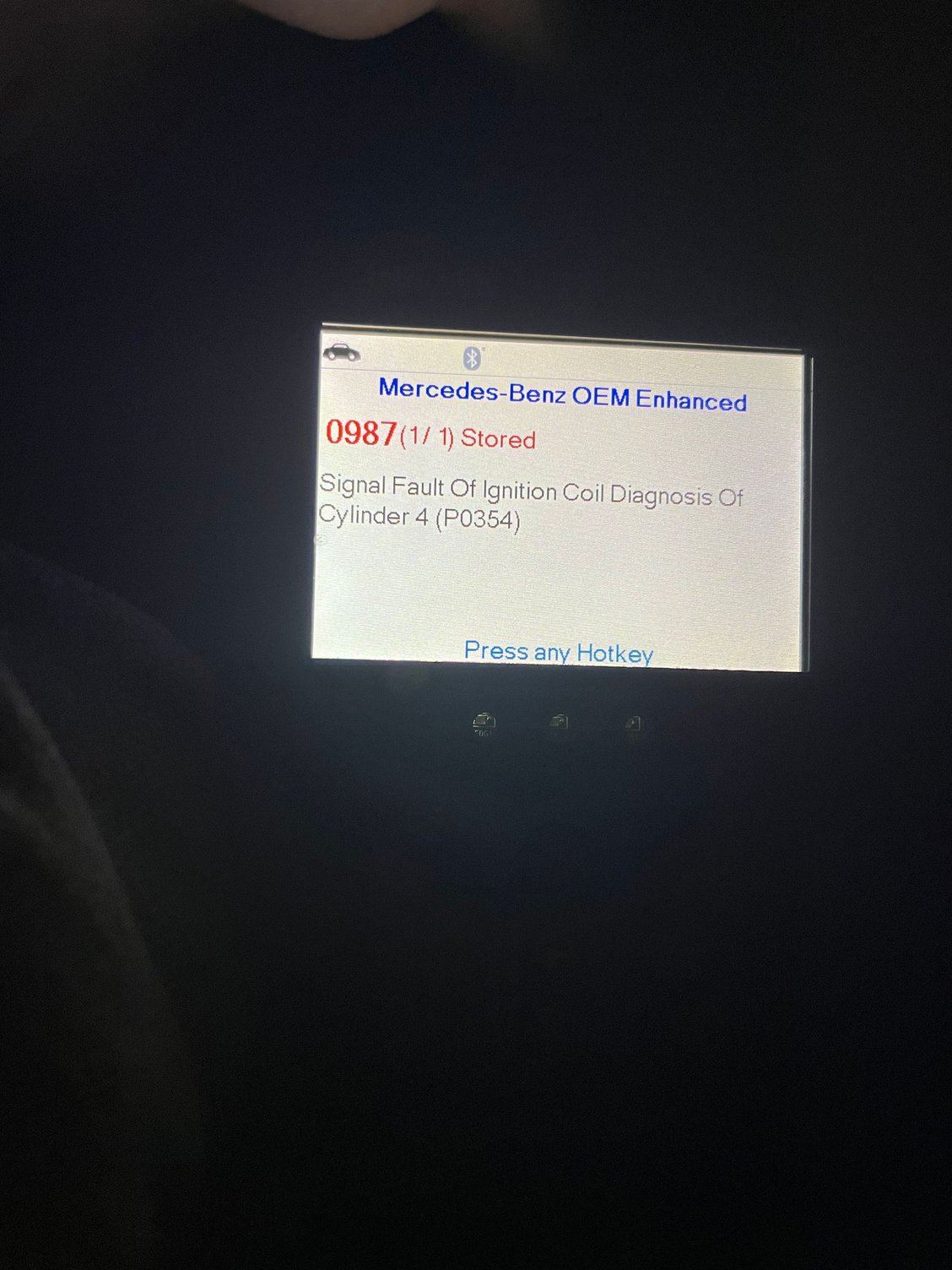

Originally Posted by JettaRed
It's always helpful to provide the descriptions for codes when posting them here.
Here’s a photo from the scanner.
I haven’t checked the voltage yet but I have a back probing set I can break out somewhere in my tools. I haven’t checked fuel trims yet either but my scanner does let me.
As for the ECU, I did think about trying it a few weeks ago so I disconnected the battery and pulled the plugs off, but they seemed perfectly clean so I decided to hold off to avoid potentially damaging it on accident.

I just reread your post and I understand what you were saying about the codes now. I see what you mean that 0987 comes back to a cylinder 5 circuit issue but P0354 comes back to a cylinder 4 circuit issue. That’s very strange and now I’m going to try just swapping the cylinder 5 over as well to see if it makes a difference. That’s very strange.
That’s what I’m getting from a thing called Xentry Tips. But it’s not official MB. It could be wrong but it’s never led me astray before??? Since your ECU is not detecting misfires, the electrical discharge characteristics must be normal. Most of MB’s DI engines can detect a cylinder leak like a valve or head gasket problem. Not being completely familiar with M272, I don’t know if it does. Have you done a compression test?

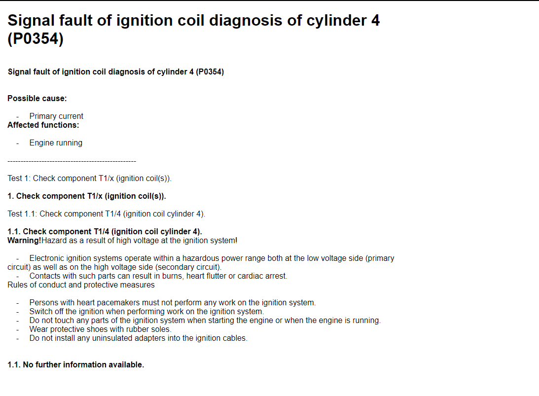

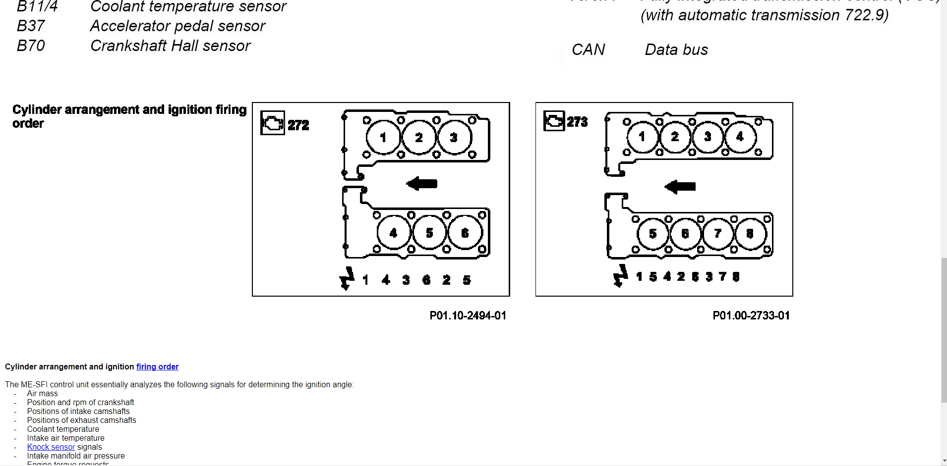

Heres what I see looking up those codes for an M272.
0987 shows Cyl 4 (P0354)
Under that specific code it mentions "Primary Current" under possible cause. Not sure what that means.
Just triple checking, cylinder 4 is drivers side front.
