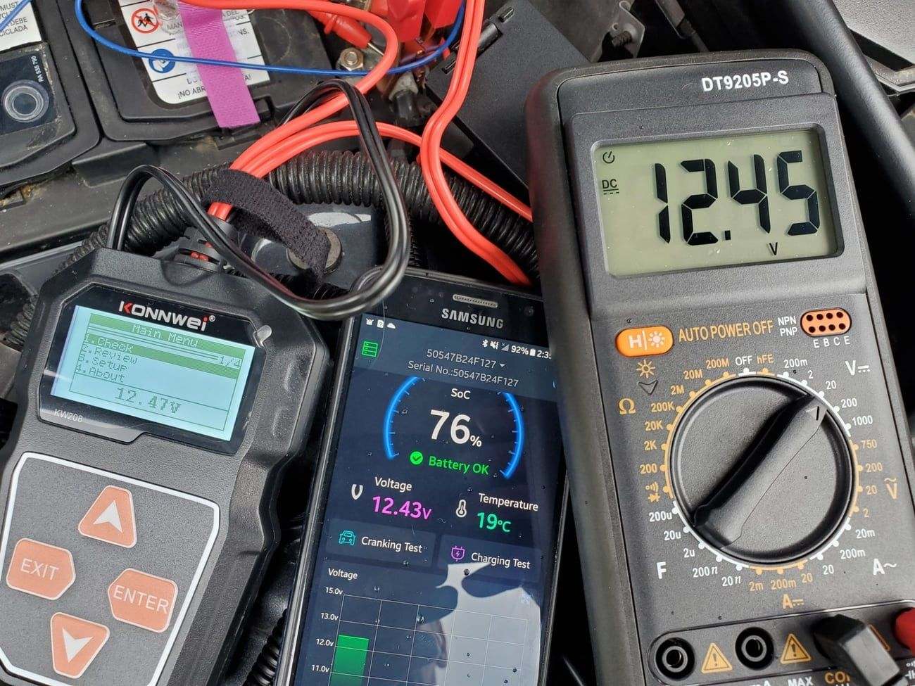

Okay so here is a question for all you out there who are a lot smarter than I am. I checked 3 or 4 different ignition coil plugs, measured with my negative on pin 3 and positive on pin 1. They mostly all stabilized at 11.9V, all the same to the hundredth decimal place.
With the possibly faulty alternator, could this still be my issue? Given that the car had been sitting overnight even?
I’m new to the Benz world but on all my old cars anything under 12V was concerning and was most likely the problem. Is 11.9V really ok? And if it’s not, do I have a faulty battery as well? I’m just struggling to understand why I only get the code on cylinder 4 of all things if the voltage is the same across all cylinders.

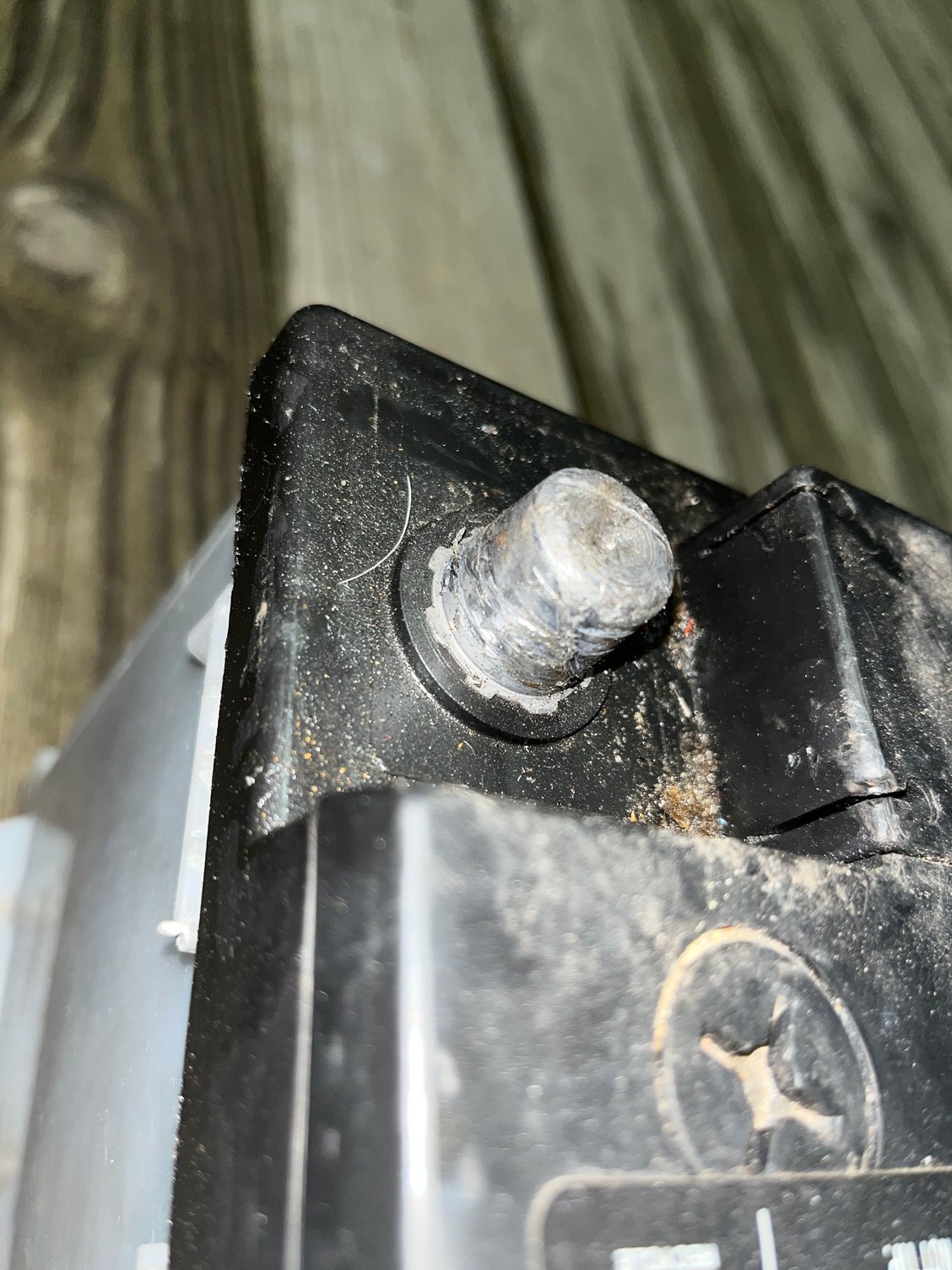

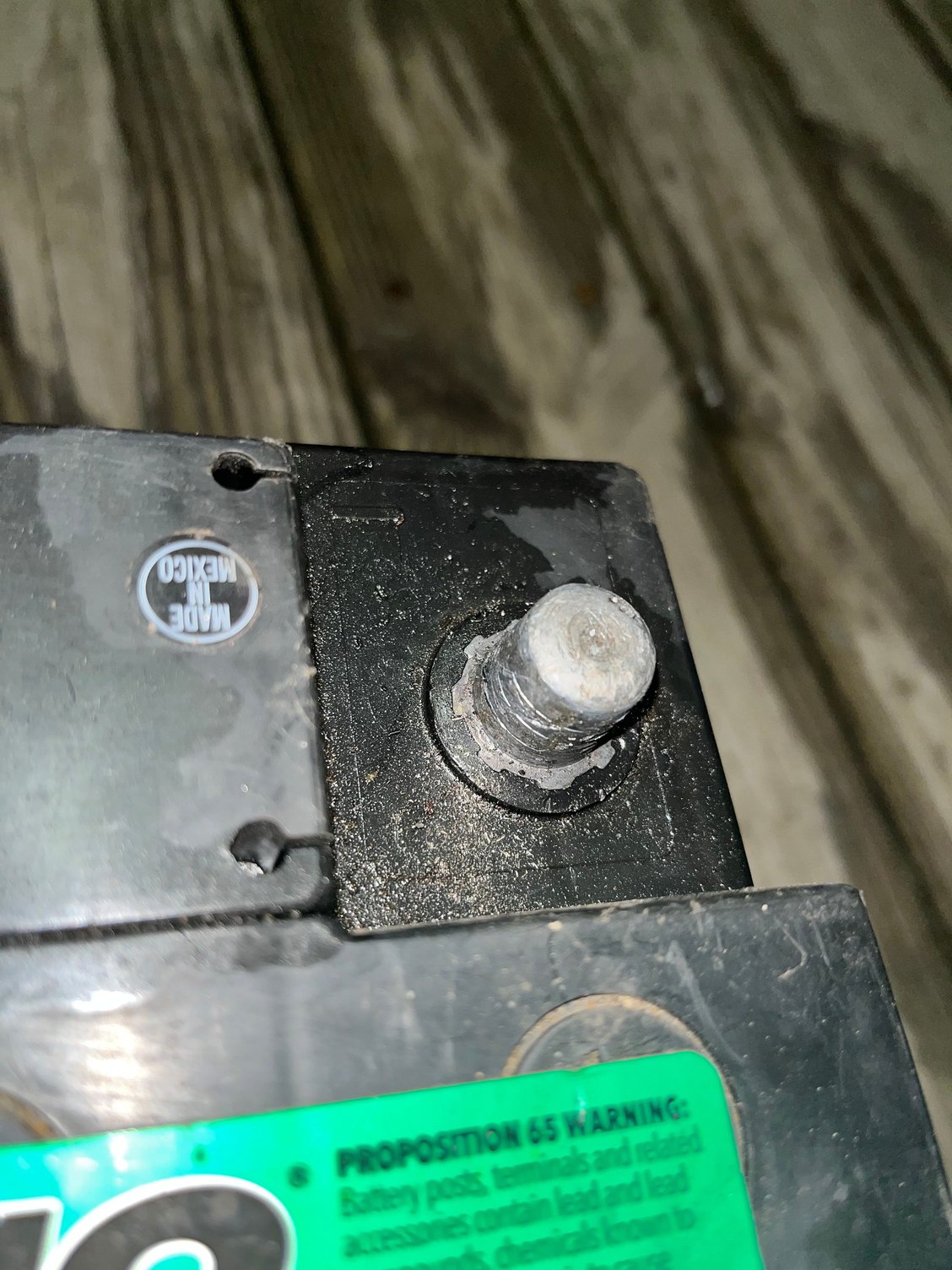

I got some photos of my battery terminals. First is the negative and then the positive. These look pretty scratched up to me, also there’s a weird substance built up around the top of the battery. Hard to tell what it is. It’s some brand I’ve never heard of but it’s dated early 2023 so it’s doubtful it’s bad? May just replace it anyways given the state of the terminals. Also may try a wire brush to clean it up a bit as well as the connectors.

That's weird stuff on the battery terminals. It would probably be a good idea to replace the battery. Make sure it is an AGM battery. Do you have a second battery in the trunk? You will if your car has ECO Start/Stop. But it doesn't show on your datacard. If you happen to have a second battery, consider replacing that too. Second (auxiliary) batteries are usually needed to run a lot of the electronics in the car, but mostly for ECO Start/Stop on newer cars.
How long did AutoZone test the battery and alternator? A load test usually takes a while.

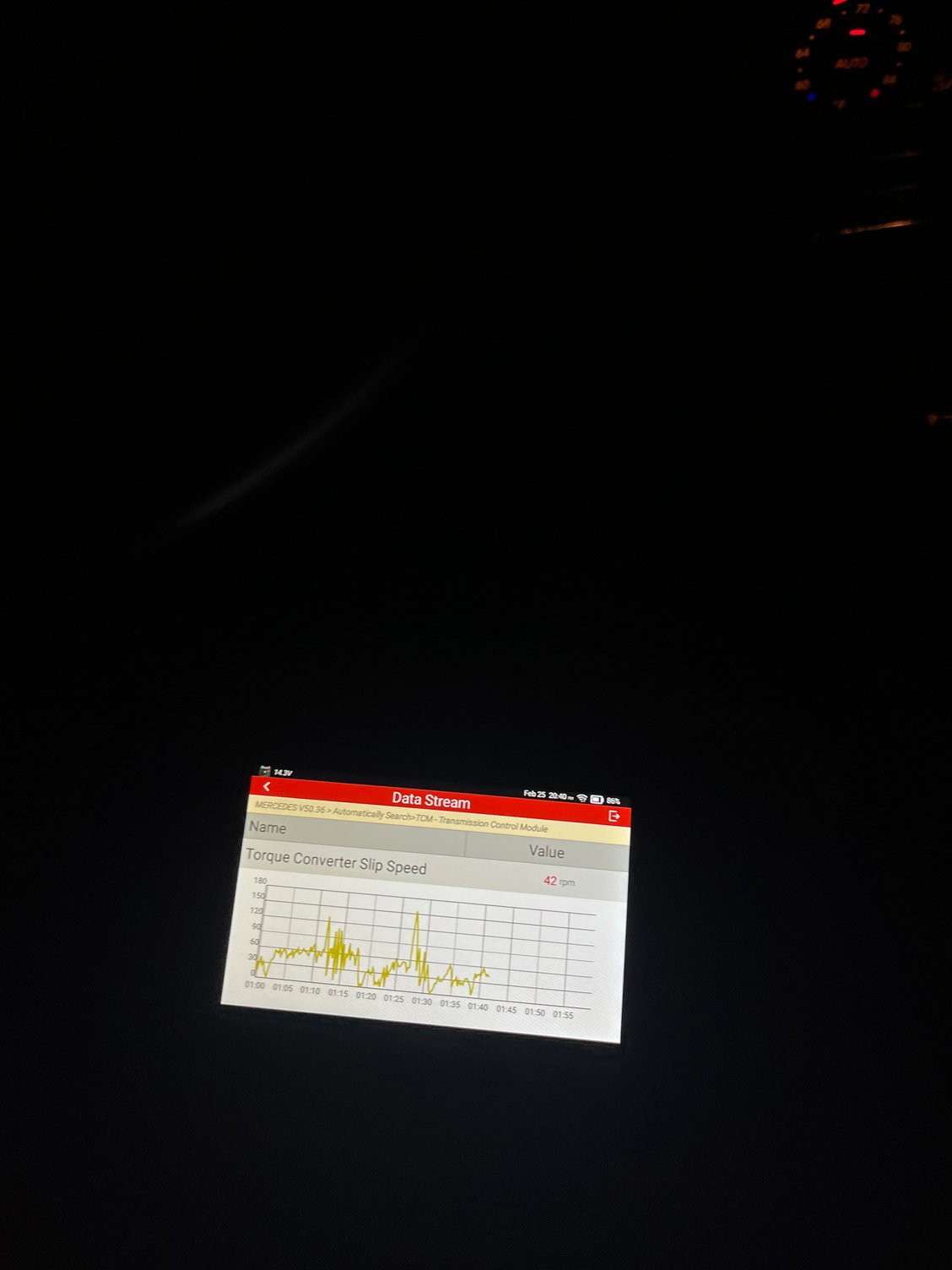

Also, I tested the Torque Converter Slip Speed and graphed it out and noticed the pretty massive fluctuations in it. I’ve been chasing a vibration while driving, only when engine is warmed up, for a while now and many of you who replied have helped me along the way. I believe this all but confirms that the transmission is my issue and hopefully the fluid change will help sort it out.
Anyways, do we think maybe the transmission sort of flipping out like this is drawing power away from the ignition system enough to intermittently set off a code?
Edit: Should have mentioned that the two big fluctuations you see there were when I was purposely making the car vibrate to see how the torque converter reacted.

Is the correct battery installed? My battery is an H7 AGM. My old battery was a Mercedes battery so I replaced it with the same one from the MB dealer, but later i realized they sell H7 AGM batteries right at Walmart for cheaper with better warranties.
You mention 180 amp alternator, is that whats in the car? I think mines a 150amp.
When I was having the red battery warning pop up once in awhile I bought two inexpensive battery testers. One is the Ancel BM200 which is a small bluetooth device that mounts right to the battery and has an app to see the readings. I like it because i can drive around and see exactly what the battery voltage is showing. Its basically a multimeter I think. Then I got a Konnwei battery tester. Im not saying these things are super accurate, but i think they are good enough to show me if there is an issue with the battery or even the alternator. Oddly enough the red battery warning stopped showing up and its fine now.
Also I noticed on the Mercedes battery if you peel the sticker away there is a view port that is supposed to glow green I guess if the battery is bad.

Honestly I don’t have a clue what battery it is. The handles are the same as the MB battery, but weirdly enough there isn’t a single identifying sticker on the battery. Only the logo and date it was manufactured. No CCA, standby amps, battery size or type, nothing. It’s quite odd. And when I check FCPEuro, it says the Bosch 180 is a perfect fit and OE supplier. I was under the impression that the 4Matic’s have the 180 amp and the RWD models have the 150 amp, but honestly not sure how true that is. I know you have the 4Matic as well Tim, but I haven’t checked for a part number elsewhere yet.

Your battery looks like a no name lead acid battery. That substance in the terminals use corrosion. You can clean it with just about anything and some paper towels just becareful not to get it on ya hands. If you do just wash it off with soap and water. You can get a battery post and connector cleaner That's a small wire brush and the terminals will clean right up. If you keep a led acid battery then cleaning should bee a yearly thing you do. With AGM style battery's they don't curious like a led acid does so less maintenance on a AGM but a bigger price tag too.
Check voltage at the battery with the car running and it should be between 13-15 volts.
If there are spikes above and below that your alternator is prolly okay and 11.9 volts after sitting all night is a good reading IMO
Also if you use Grok AI you can send it a picture and it will identify almost any picture. It will also give you repair advice just ask a specific questions. Utt should be able to identify your battery.

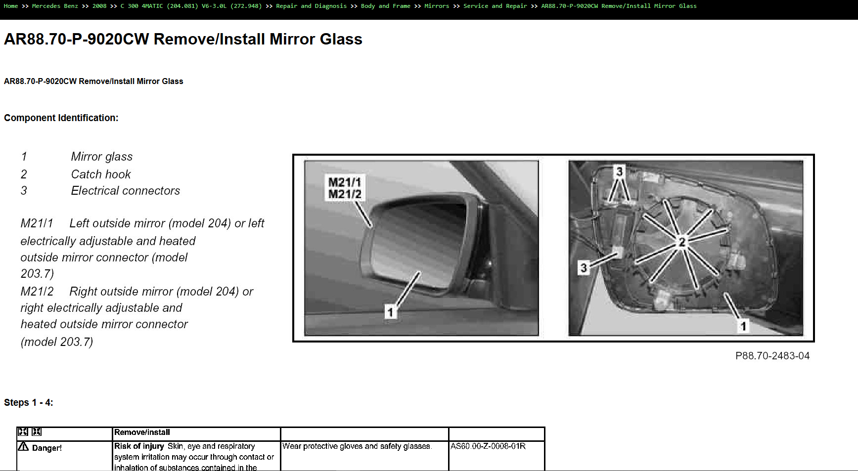

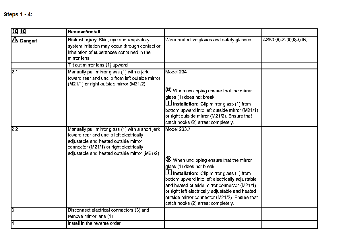

On another note, anyone know how to remove the mirror cap to investigate the mirror heater? It seems like it just pops out as I can’t find anywhere there could possibly be a screw, but don’t want to break anything.

Its all in the online manual link I posted. - Body and Frame > Mirrors . https://charm.li/Mercedes%20Benz/200...d%20Diagnosis/
