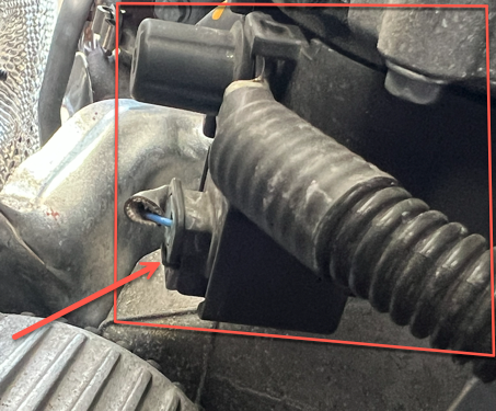

OK, just got done unplugging the SL400 alternator (it got to a balmy 27°F today). I will be going out in a little while to see how she drives. I will report back.

Here's some pics from the bottom...
Plugged in.
Plugged in.
Unplugged.
Originally Posted by JettaRed
Thanks a bunch! Is it the same type of connector as the oil pump solenoid? no dice getting from it on top right? If so looks like I am getting a back workout this weekend crawling down : )
No. It's a different type of connector, a little bigger. But only a single wire.

Are you planning to put a dummy wire to cap it from dirt and debris?
I should. But it's kinda protected where it is, as you can see from my pristine engine bay! Seriously, I don't think it will get dirty, but if I knew that parts to get, I would cap them off. I don't think I can get in there with a heat gun or torch and some shrink tubing.
I was able to on the C350, just not the SL. I guess it really depends on how much room you have in the engine bay. The connector is toward the bottom of the alternator, but facing the wheel well, away from the engine. If you have room to reach, maybe you can get it from the top. I just don't know how much room the turbo takes up on that side. I could reach and feel it from the top; I just couldn't get a screwdriver down there to pop that little gray latching clip and my thumbnail wasn't strong enough.

ACCESS TO ALT-LIN...
You know the passenger side wheel well may be a good shortcut.
Let me look..

Should have done it while crawling around under the car but got distracted by focusing on disconnecting the wire.
Let me look..
I was hoping that too, but there is a heat shield in the way as the turbo is close to the wheel well on the inside.
