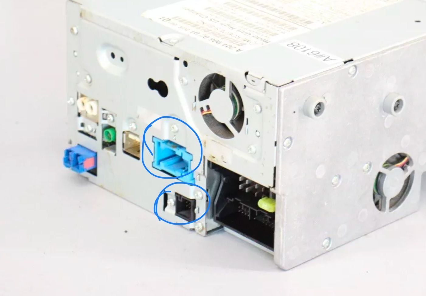

So I have a pre-facelift 2011 c300 and it currently has an aftermarket head unit in it and I’m trying to go back to stock. I have the stock head unit and 7 inch screen and had replaced it with an alpine head unit. I want to go back to stock. I have everything installed, but now the screen will not fold open and with the key out of the car if I push the on button on the Stock head unit the radio turns on. I don’t know what I’ve done and I need help. can anybody tell me, on the back of the head unit there is a blue connector and a small black connector. Should all of these connectors have connections? I’m going to visit the junkyard today and see if there’s one there that I can look at the connections on.

I am reinstalling the head OEM head unit and I am planning on putting in one of the Android upper units as well. The radio itself works but the screen no longer folds up. There is a plug that fits into the back of the 7 inch screen and the head unit has an IDENTICAL plug in the back of it so i feel it’s safe to ASSUME. That there should be at least that plug somewhere in the hell hole behind the head unit but i can not find it anywhere. There is also a blue socket in the back of the head unit as well. Now I don’t have the HK or anything like that so I wasn’t sure if that could be where the amp would plug in

These are the 2 connections that I can not find the plugs for

After some intensive research online and watching a number of removal videos, I found that these 2 connections are not used. FURTHERMORE, the display not opening…..
always check the fuses. 7.5 amp fuse blown.
This is when ya feel really stupid for not doing it in the first place. SMDH
