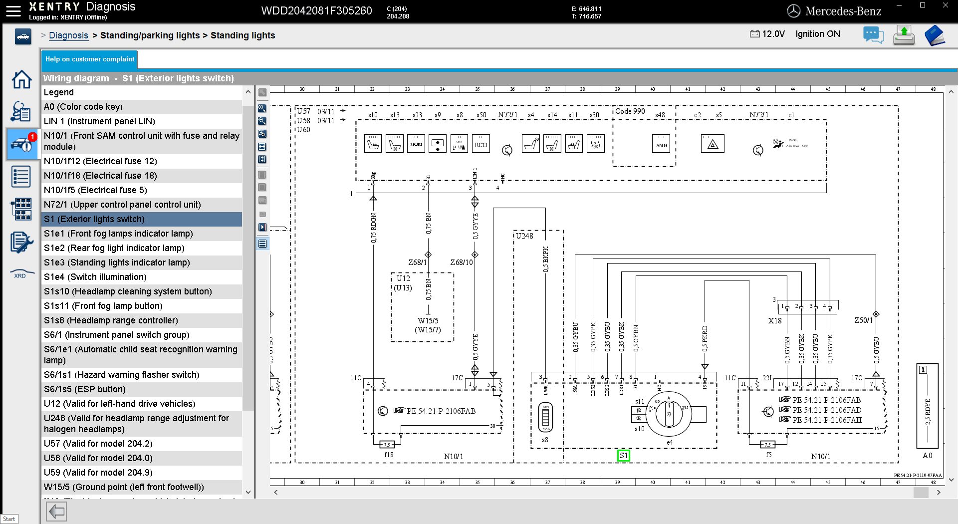

OK, that makes sense about the brake light switch. Scanning for codes will be important. Make sure you are using a Mercedes-specific scanner. Generic OBD scanners are basically worthless when it comes to Mercedes. I will post some schematics.

Old Feb 26, 2025 | 12:07 PM
JettaRed's Avatar
Veteran: Army
iTrader: (1)
Joined: Nov 2016
Posts: 7,847
Likes: 3,498
From: Maryland
Here is the full schematic with legend.
