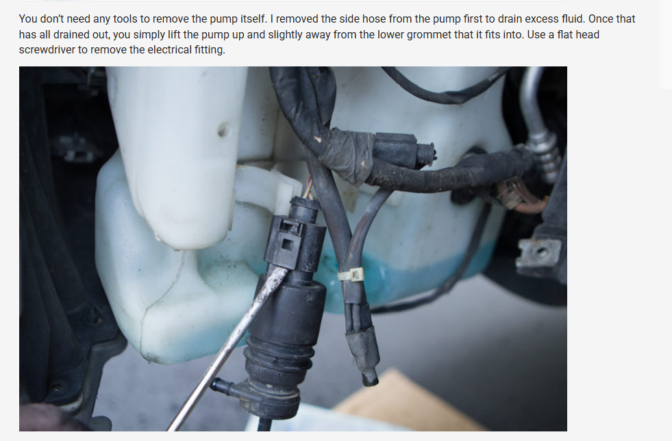

How does the plug unplug from the harness to the windshield washer reservoir motor/pump? It's a head scratcher.

Hope this helps ya
https://www.pelicanparts.com/techart...eplacement.htm

This may help: https://mbworld.org/articles/how-to-...p-replacement/
