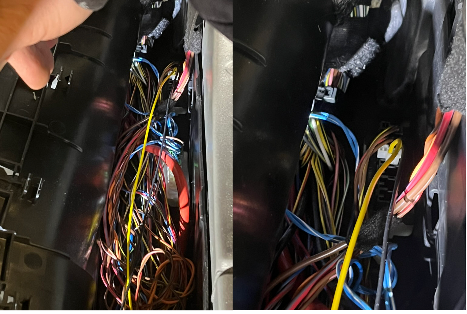

  5. Remove the carpet and find the CAN B Hub and click in the newly created connector. Picture one is zoomed out, picture two is zoomed in. The Yellow and Black wires are the ones I have used
    Drivers side (LEFT) CAN B Hub W204 Location
    Passengers side (RIGHT) CAN B Hub W204 Location
