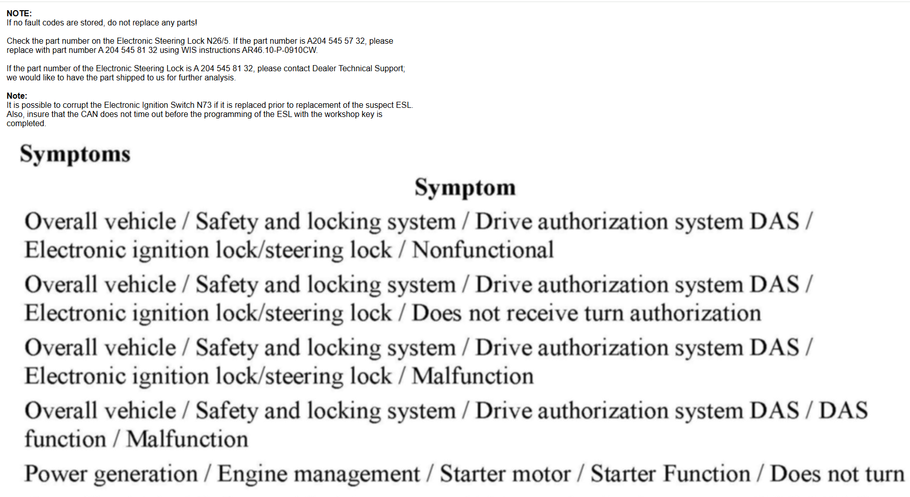

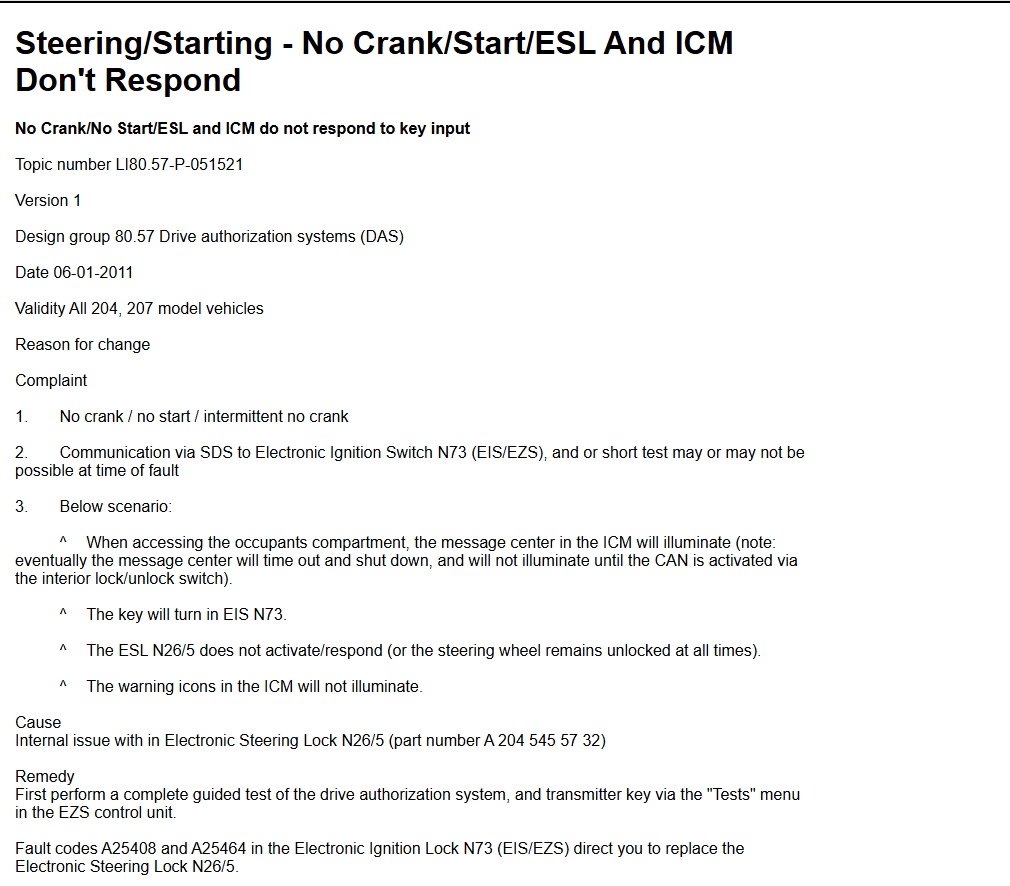

I came across something about the ESL in a bulletin. Im not sure if it means Mercedes will cover the costs to replace it or not.
