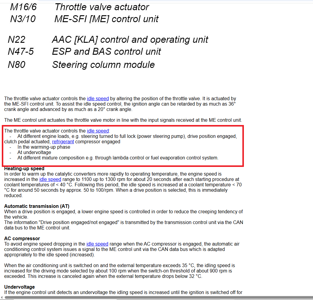

your gonna need a Mercedes scanner and read those codes. or a maintenance item to try is to clean your throttle body blade and housing inside. This is a common problem with fuel injected cars.

I dont know what engine the 220 has.
I would see what fault codes are showing, obviously.
Symptoms may be related to an issue with the throttle body. But im purely speculating.
