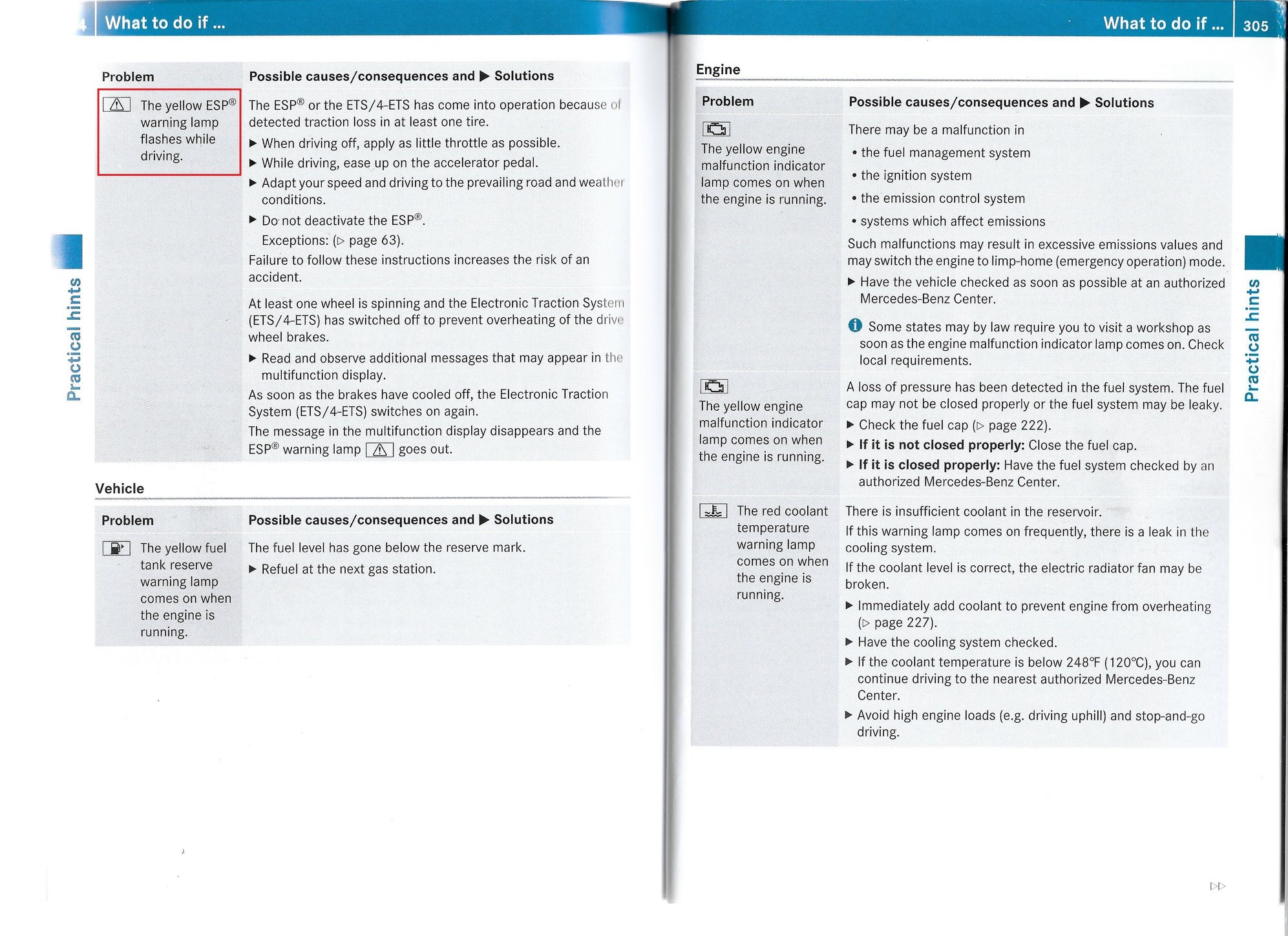

The symbol you’re describing—a small triangle with a car profile inside it—typically appears on a car’s dashboard as a warning light. While the exact meaning can vary slightly depending on the car’s make and model, it’s often associated with a collision warning system or automatic emergency braking system.
This symbol usually indicates that the car’s sensors have detected a potential collision risk, such as another vehicle, pedestrian, or obstacle being too close. It might flash or light up with an audible alert to warn the driver to take action. In some cases, it could also mean the system has engaged or there’s an issue with the sensors (e.g., they’re dirty, blocked, or malfunctioning).
For example, on some Mercedes-Benz models, a red triangle with a car inside it is tied to the Collision Prevention Assist system, alerting you to a sudden hazard. In other brands, it might relate to similar safety features like forward collision warning.
To be certain, I’d recommend checking your car’s manual, as symbols can differ between manufacturers. If it’s persistent and you’re unsure, it might be worth a quick trip to a mechanic to rule out a sensor problem. What kind of car do you have? That could help narrow it down!

Handbook Description

Thanks for the replies fellas....sorry about the video quality but that is the best I could do at the time.
The engine light is due to the emissions air pump. That stupid thing goes bad often and I'm honestly tired of replacing it.
My scan tool is able to scan every Mercedes module and other than the air pump related ones there were no codes.
My scan tool also allows me to monitor data real time. Based on the earlier comment about the wheel speed sensor I looked at the live data for that.
It was giving RPM's while driving and I'm not sure what a good number is for the mph but when I was parked it said 24.9 rpm. So it would seem to me that its bad.
I also found a youtube video about putting the car in dyno mode to take ABS/ECS/ECS nanny controls out of the equation. So I did that and the car drives completely fine.
At this point I think I'll throw a few bucks at new ABS/wheel speed sensors and see what happens. They seem pretty easy to replace.
What do you guys think?
