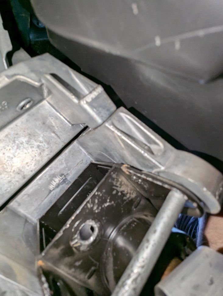

After looking at the many Mercedes forums I decided to remove the ESL and lo and behold to my surprise no ESL was there to be found. It turns out the car had this issue before and the ESL was replaced with a bypass.
Next thing I was thinking about was replacing the bypass and here is where you guys may be able to help me.
  1. how do I know the bypass is faulty ?
  2. can a broken ESL/BYPASS cause remote unlocking to stop working ?
And lastly here are some photos:
No ESL at all
No ESL at all
Bypass
Bypass

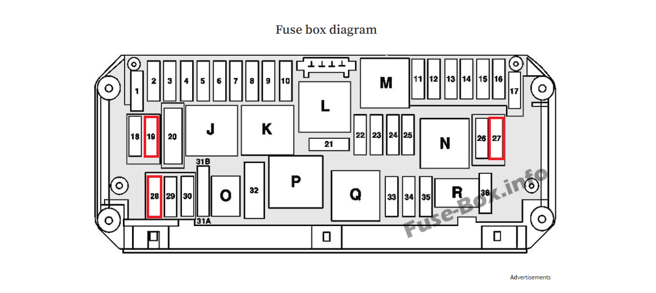

I was thinking some more about this issue. I noticed when I open the door the display in the middle of the instrument cluster turns on and shows the vehicle mileage. Without the key in the ignition the middle display is the only thing that comes on.
When you open the door does the middle display turn on? Im guessing no. Makes me wonder if its an issue with the instrument cluster, maybe the fuse. It seems to have its own fuse in the front sam in the engine bay.
How did you check all the fuses, visually or with a multimeter? I would scan the car first for any fault codes. I would also check the fuses, focusing on the instrument Cluster fuse, also it looks like the Ignition Lock and the Electronic steering lock share the same fuse, im seeing two seperate fuses for both of them.
Heres a link to the fuse box diagrams: https://fuse-box.info/mercedes-benz/...uses-and-relay
- f19 ESL/EIS
- f27 ESL/EIS
- f28 Instrument Cluster
The key fob doesnt work to unlock/lock the doors, but when you press the unlock on the key fob does the fuel filler door unlock? Can you open the trunk using the key fob? Can you open the trunk using the button on the door?
When you insert the key and turn it to On can you hear the fuel pump kicking on under the rear seat? Do the windows and sunroof work?
What voltage are you getting for the battery? Have you tried hooking up a battery charger?

- f19 ESL/EIS
- f27 ESL/EIS
I have checked all the fuses using a multimeter

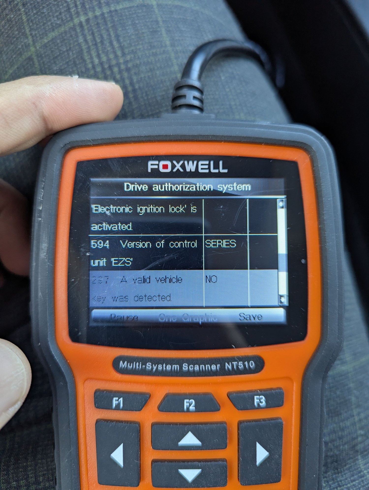

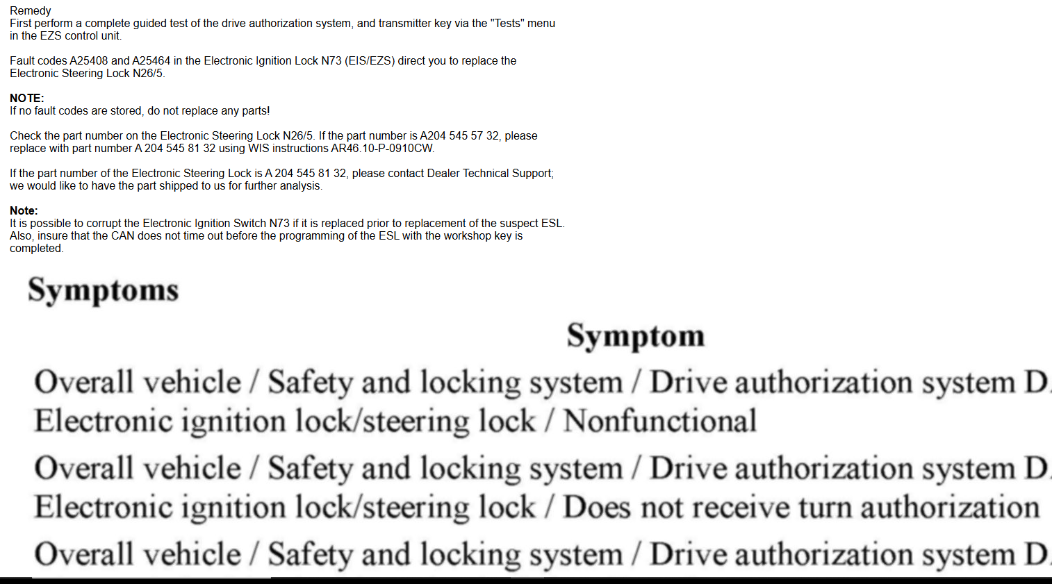

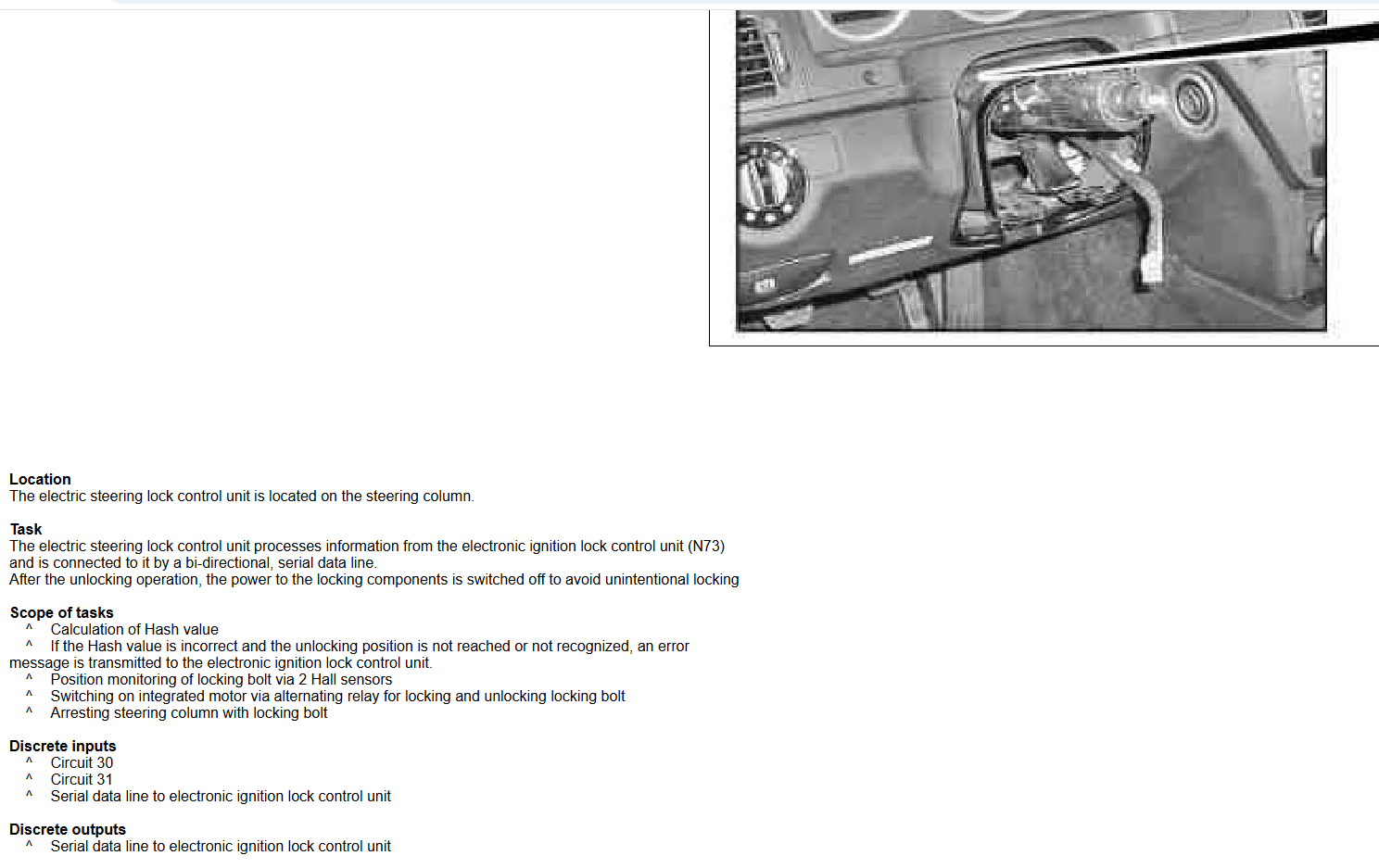

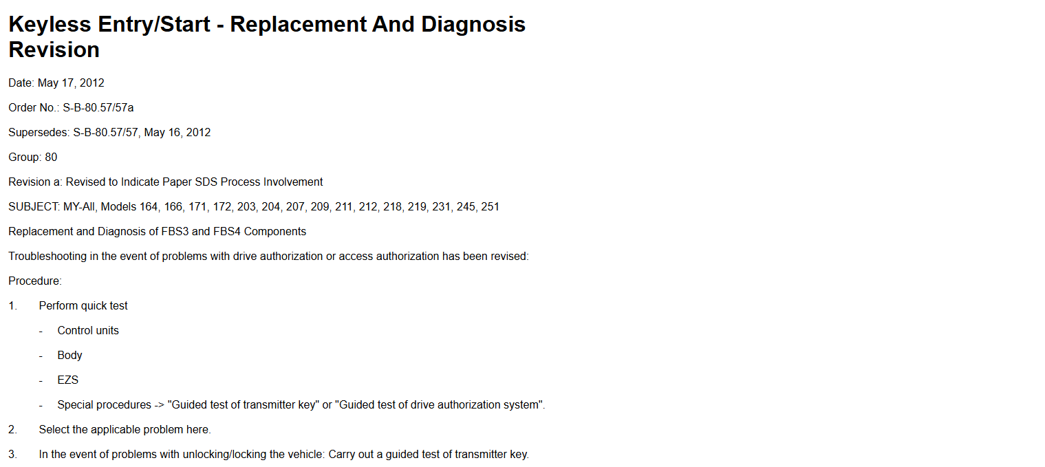

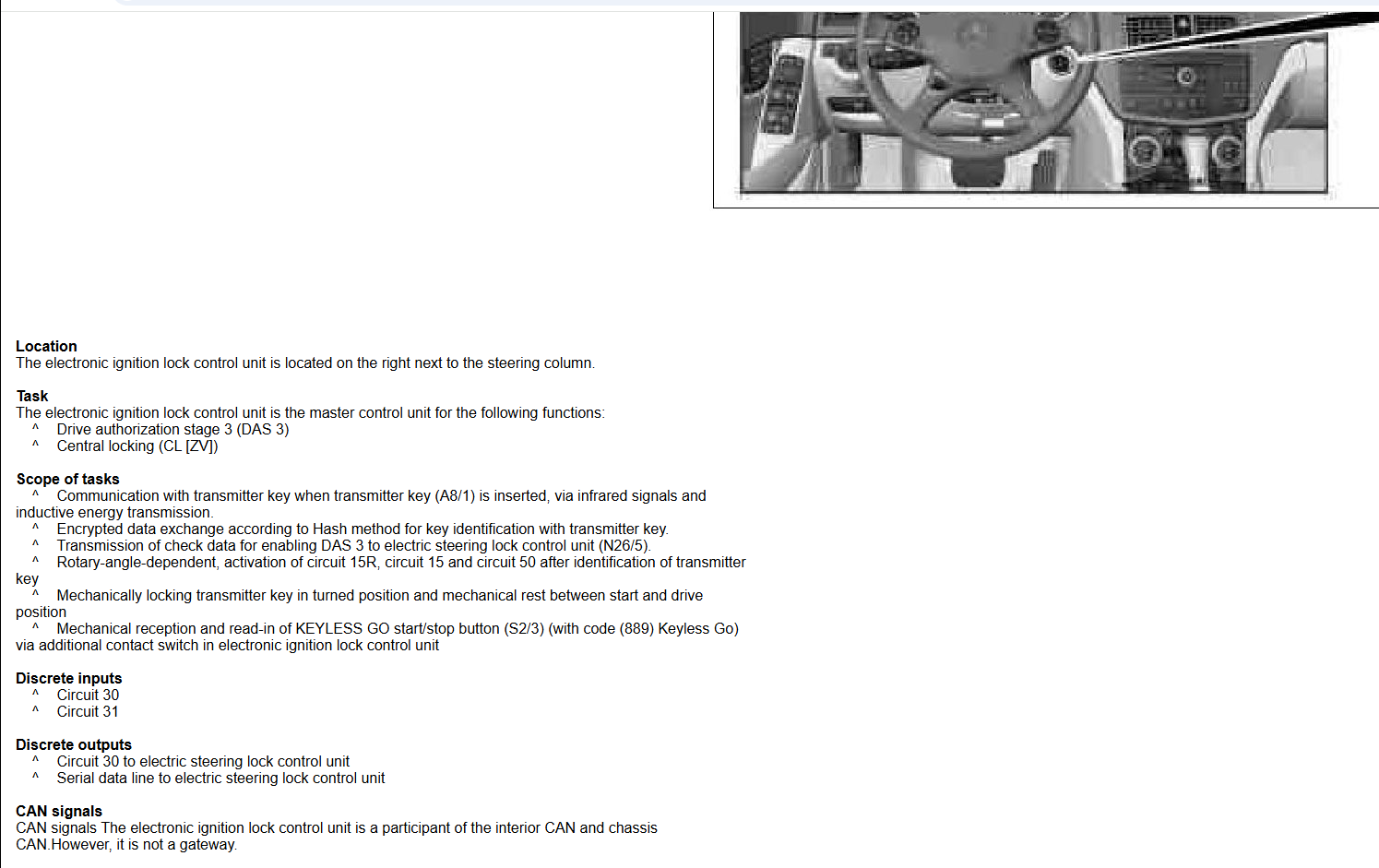

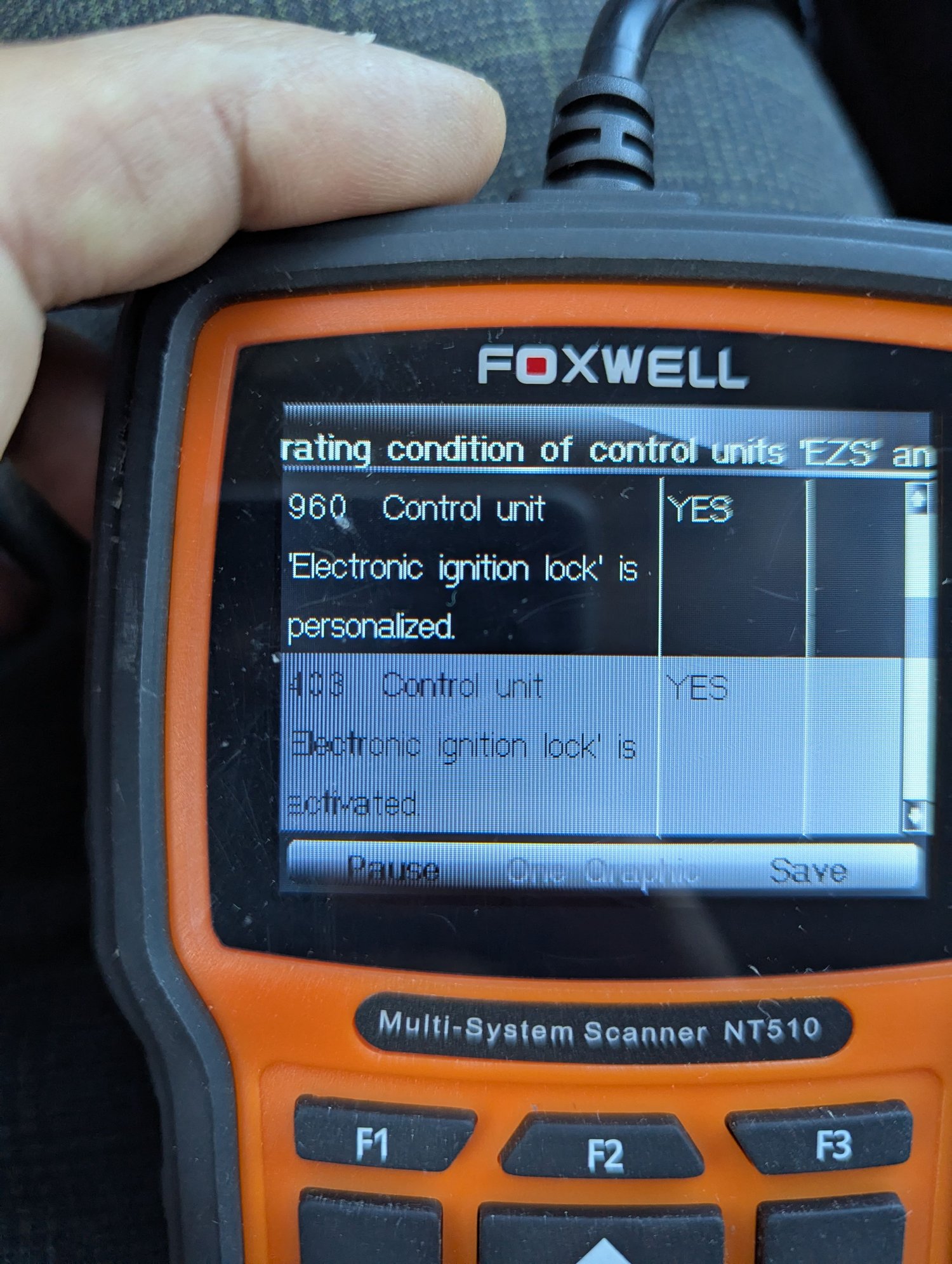

Codes, photos and a video that i thought could be intresting
Old Apr 18, 2025 | 04:17 AM
leclrec's Avatar
Joined: Apr 2025
Posts: 22
w204 c class
These two are particularly interesting
Does this mean that my key is no longer valid ? How is this possible it is the same key I've been using since I bought the car
Old Apr 19, 2025 | 12:01 AM
Odd Piggy's Avatar
Joined: Sep 2013
Posts: 2,347
Likes: 692
2021 GLB250 FWD, 2023 GLA250 FWD, 2013 C250, 2015 GLK350, 2005 ML350SE, 2003 E320

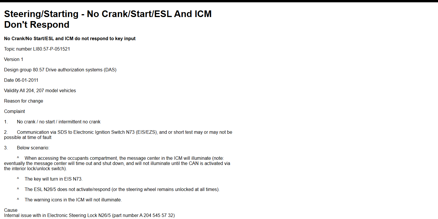

No. It means the EIS can’t see it. That could mean either the key or the EIS has a malfunction. The EIS usually will display fault codes if it fails. The key can be tested. Many independent shops and some locksmiths have the proper equipment. You have a second key, which also does not work. That would be an unusual situation.
You appear to have the set of conditions to satisfy the Steering/Starting… Diagnostics that @TimC300 sent on 16 April. You have the ESL code A25408. It appears that by that logic, your ESL emulator has failed.
As for the lock/unlock failure, have you changed the batteries in your keys? That function requires fresh batteries.
I am, however, still a bit wary because the two problems seem to have occurred simultaneously. A new emulator may not be extremely expensive, but if it is changed and the problem persists, we are back to a hidden underlying issue.

So I noticed that my ESL emulator light doesn't turn green and is always red.
Is that a definitive sign that it's broken ?
Also can I use the starter relay trick to jump start it ?
