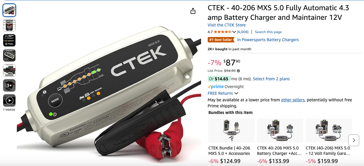

Car batteries don't last forever, and everything electrical starts with with your battery's health. Go to any auto store and ask to have your battery checked.

Most auto stores have battery load testers that they use to test batteries that fail under warranty (they don't want to give away free replacements unless certain the return is bad, not just discharged). Some other testers might not provide reliable results. Also have them check for a date code. If the battery is more than 5 years old, you're probably due for a new one anyway.

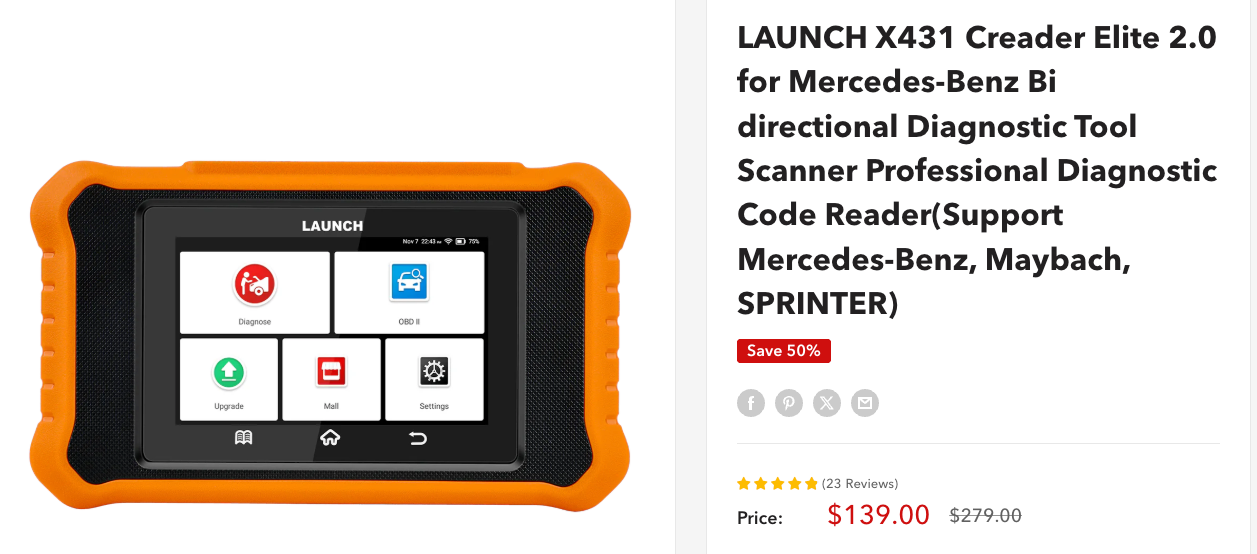

This is what you want...
https://kingbolentool.com/products/launch-creader-elite-2-0-for-mercedes-benz-bidirectional-diagnostic-tool-scanner
https://kingbolentool.com/products/l...c-tool-scanner
Or you can pay more on Amazon. KingBolenTool is the cheapest US-based supplier I've found.
https://a.co/d/dDQREyL

- I do have an OBD-II scanner but not a Mercedes specific, can’t exactly purchase one right now
I understand. But a correct scanner is the most important tool you can have for a Mercedes. Generic OBD-II scanners are useless, if not misleading. Your car has around 50 individual control modules and your generic scanner is not going to cover all of those. Here is an example of a scan report from my LAUNCH scanner.

There have been a couple Launch scanners listed for sale at discount recently on the forum marketplace. Not sure they're still available, but worth checking. An OBD MB-specific scanner is more essential than a spare tire, IMO.

BlueDriver is not a bad alternative. It will download your brand of car to the app you use on your phone. But still about $100. For extra $30 or $40, LAUNCH is a better deal. BlueDriver is limited to scanning and clearing (most) codes.
