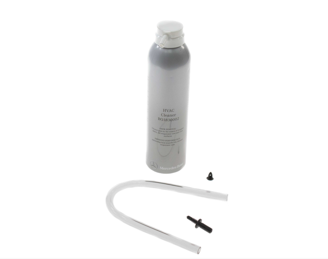

Originally Posted by TimC300
Who serviced it, what did they do? I havent worked on mine but reading thru the manuals it seems pretty complicated, the refrigerant is weighed and doesnt go by pressure.
May be a dirty evaporator. They have a procedure for cleaning it which seems fairly easy to do. Basically take apart the cabin air filter to remove the filter part, drill a hole in the base to fit the cleaner nozzle, then spray it in with it running.
Heres the procedure: https://charm.li/Mercedes%20Benz/201...k%20Procedure/
Wonder if you can remove the cabin air filter and stick a boroscope in there to see the condition of the evaporator.
https://cimg2.ibsrv.net/gimg/www.mbw...f3e06372d5.png
