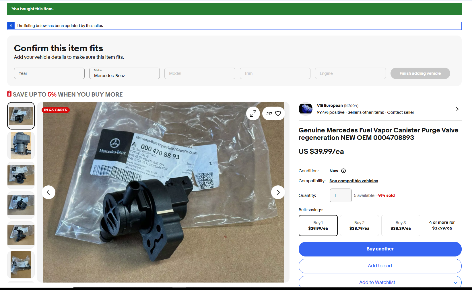

When I replaced mine I wasnt too sure if it was the issue, didnt know much about how it works. I bought an inexpensive used purge valve from an older SLK which does cross reference with the same part numbers, it was just a much bigger purge valve. It did fix the issue and the check wngine light but it was very loud and could hear it ticking away from the drivers seat. I have since replaced it again with a new purge valve i came across for a good price on eBay. Replaced it last year and its working great.

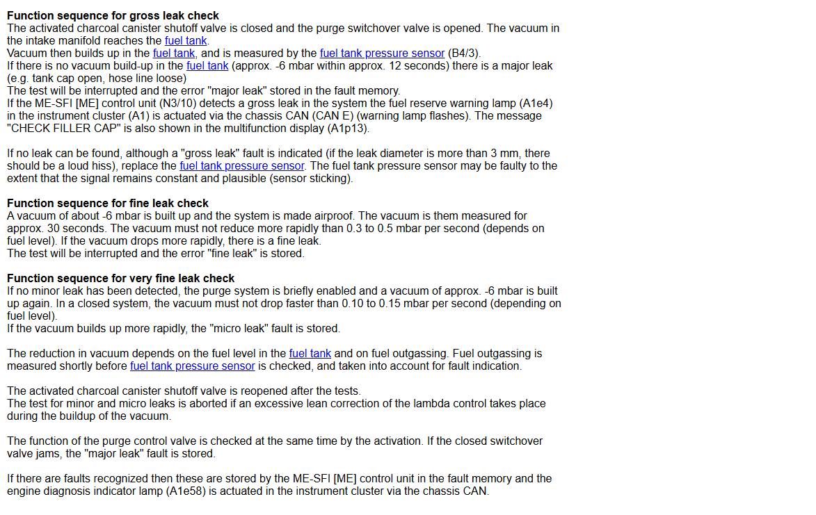

Im guessing you have the M271 engine. I dont have that manual handy but looking thru for the M272 theres info on the evap system. May be helpful to diagnose the issue. Not sure which specific purge valve you have in there, i'll show the exact one I bought.
