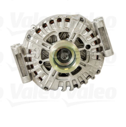

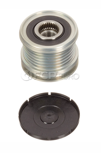

Des the alernator pulley have a clutch and is it working ?
Reply 0
Jun 16, 2025 | 09:22 AM
Quote: Des the alernator pulley have a clutch and is it working ?
You can look at the alternator. If the alt pulley has a cap, it has a clutch. If no cap, non-clutched. My M276.957 3.5 liter (non-turbo) alternator has a clutch. My M276.825 3.0 liter (bi-turbo) does not.
C350 Alternator Pulley (M276.957)
SL400 Alternator (M276.825)
Reply 0
