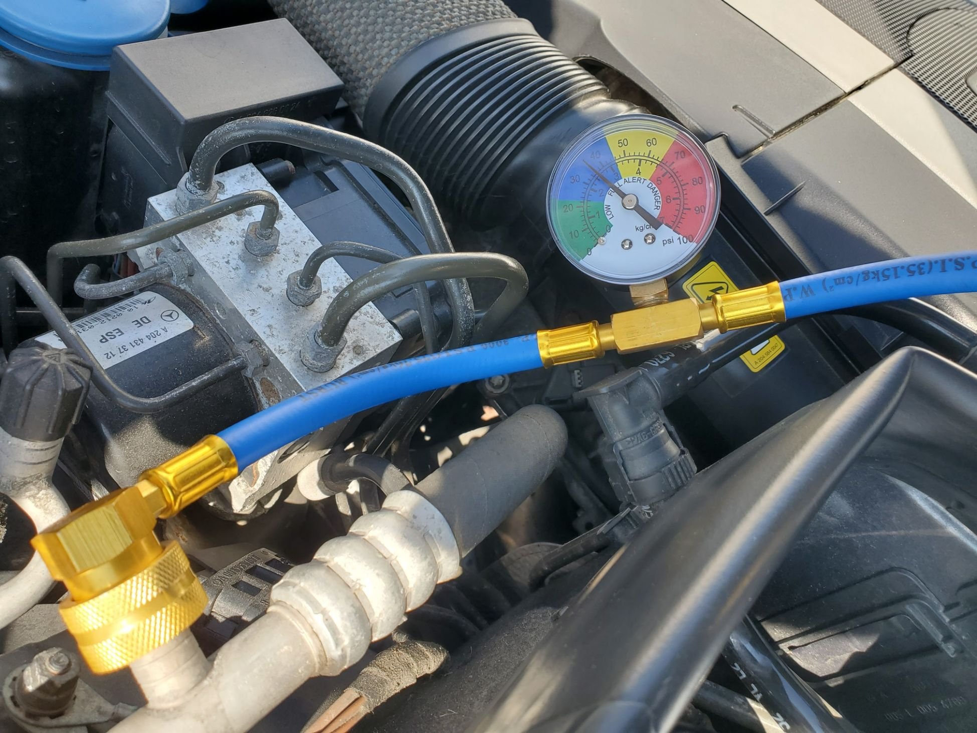

Using my Foxwell scanner allowed me to see what the ac was doing, if it was turning on, shows the refrigerant pressure, shows the evaporator temp etc. Then I bought an inexpensive refrigerant hose w/gauge which showed me the low pressure line pressure with the ac off and then on. I ended up putting around 1/2 can of R 134a in and it now works great.
Do you have a scanner can can show what the ac is doing and check for any faults in general? I would look at what the refrigerant pressure is reading with the ac off then on, see if its reading low and then has to build up. I have very little experience with ac systems so im just guessing.

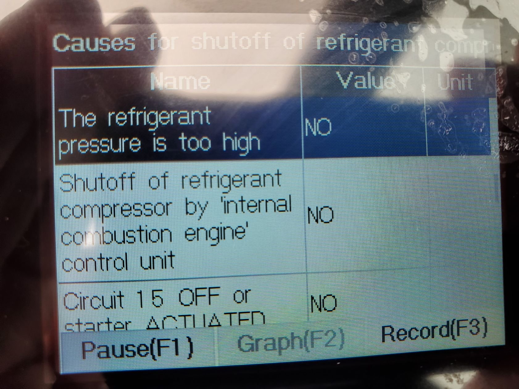

Do you have a Mercedes specific obd scanner? I hardly ever use mine but for the few times I have used it i feel it paid for itself.
You will be able to see if the ac compressor is even turning on or if there is a delay. Can see the evaporator temperature, if it is getting cold but still blowing hot air that may mean an issue with the blend air doors. Then you can see the refrigerant pressure, see if its lower than it should be.
Then use a gauge to check the low side pressure, see what it reads when the ac compressor is of, then on. With mine the low side pressure would drop to very low when the compressor was on.

I would get an inexpensive Launch Mercedes obd scanner so you can see what the ac system is doing.

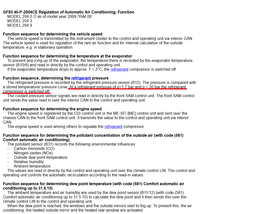

When mine was blowing only hot air I noticed the refrigerant pressure was showing at 1.7 bar. And according to the manual this is right at the min limit for the compressor to turn on.
That specific pressure sensor is at the condenser at the front bumper.
