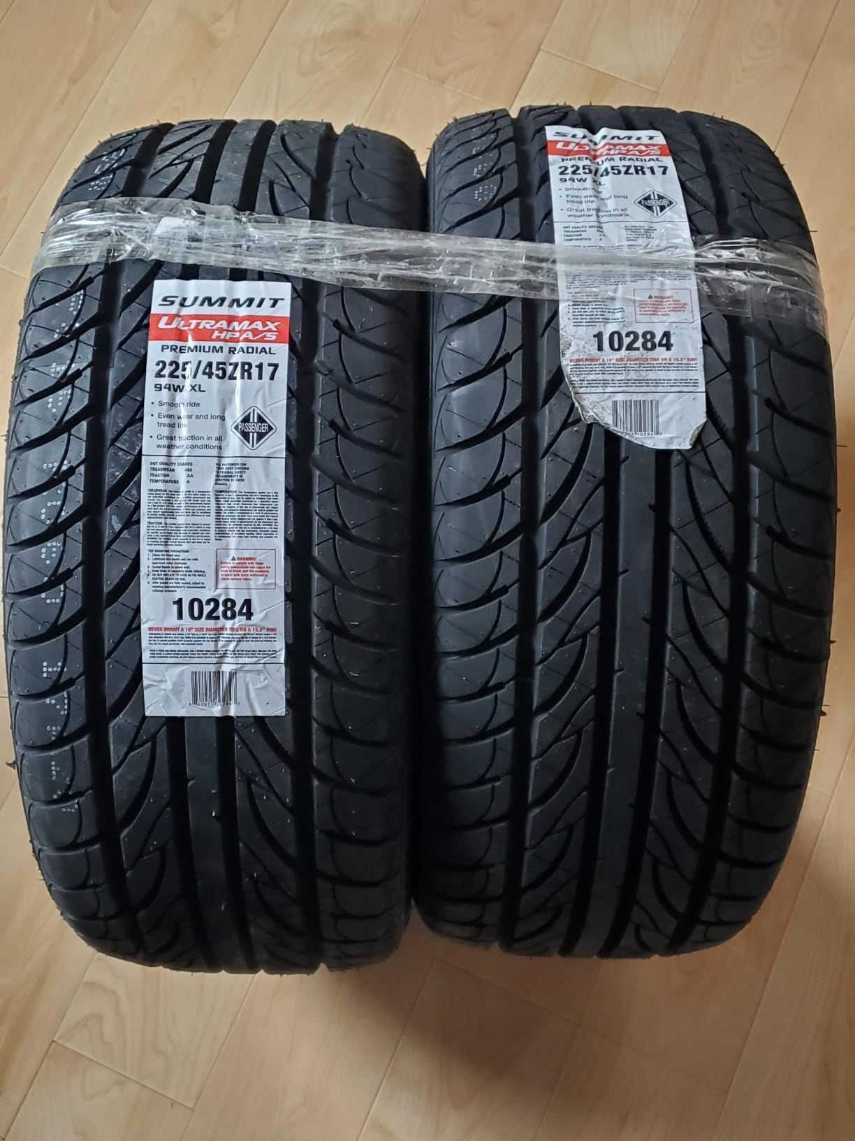

So you want to replace your worn rear tires and the new tires you want to get have a higher speed rating? Sounds good to me. I'm hardly a tire expert but its something I would do. Seems the higher the speed rating the better handling of the tire. Then next time you replace the fronts look for the W speed rating.
I had all 4 tires replaced last year and they are 95W XL M+S. I really like them. I guess the XL means extra load. I figured in my mind they are good in case of hitting pot holes they may be more durable. I have the staggered 17" rims and the tires look low profile-ish. I drive normal though, im not zipping around drifting around corners.
225/45R17 95W XL M+S front
245/40R17 95W XL M+S rear

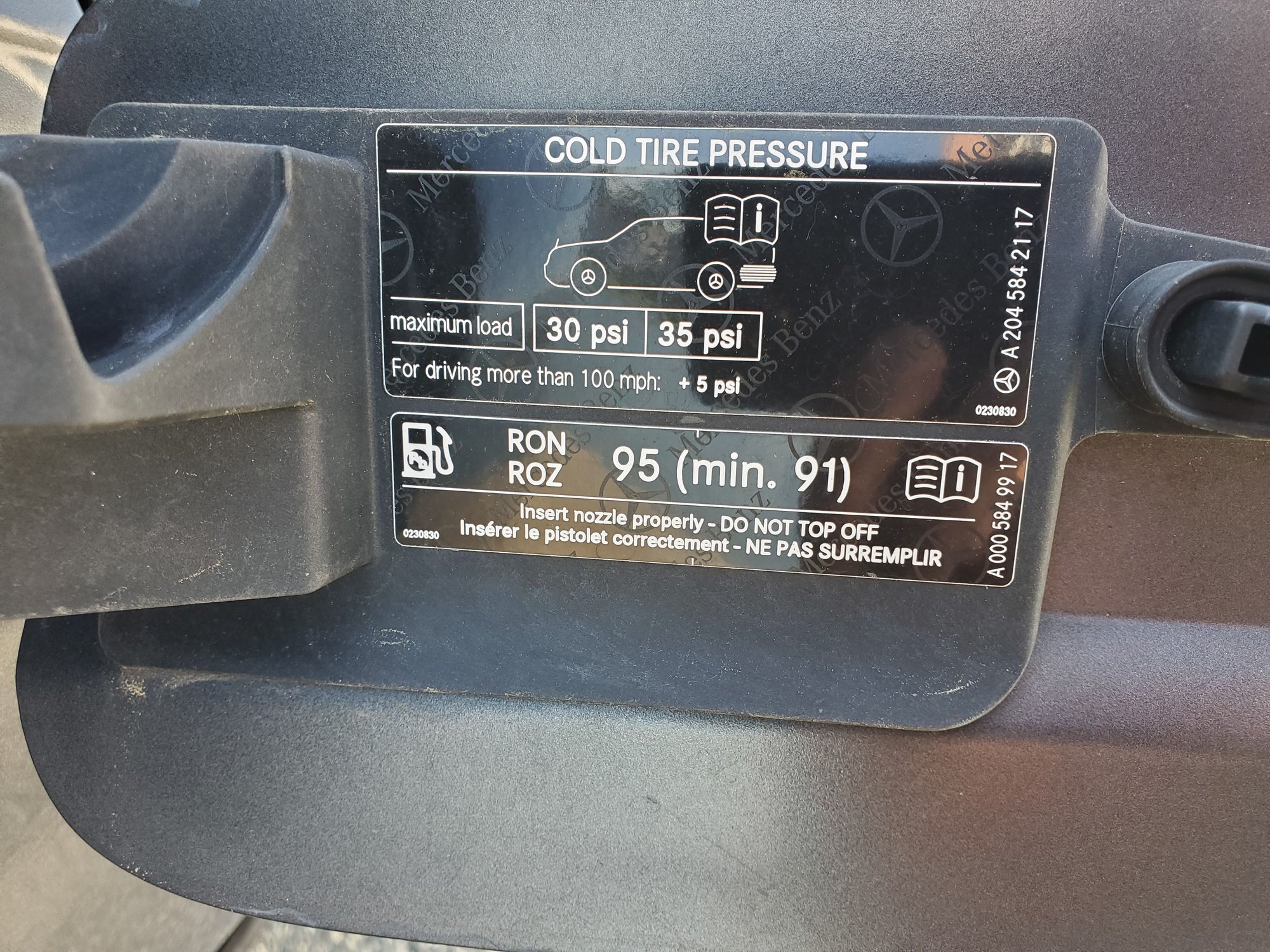

Look on the inside of the drivers door at the tire info. I would follow what it says for the tire pressure. Im assuming you will be getting the recommended size tires on that label.
Theres alot of info on tires in the Operators Manual.
Quick story about tire pressures. When I got my tires replaced last year I got in the car and started driving away. Almost immediately the tire pressure warning popped up on the dash. I figured it was due to having two of the old sensors replaced with new ones I bought for them to swap out, along with supplying them with the rebuild kits for the other two sensors I was keeping, the car had to relearn the sensors. As I was driving the ride felt extremely hard feeling every single bump, like the car was bottoming out. I was thinking the tires suck. Then the tire warning went away and it showed the pressure of all 4 tires and they were around 50psi when the front should be 30psi and the rears should be 35psi according to the label on the door. I pulled over in the first parking lot I came across and I lowered all the tires to the correct pressure and the car rode great after that. I went from hating the new tires to loving them just by correcting the pressure. This also showed me the tire shop couldnt be bothered to even look on the door to what the pressure should be. Then when I got home I was cleaning the rims because they were filthy and thats when I noticed they had broken two center caps and glued them back on with some type of clear sealant.
So as long as you are getting the recommended size tires and the tires meet the car load rating I would set the the tire pressure according to what it says in the door.

The correct tire pressures for your specific vehicle are listed on a sticker placed on the inner side of the fuel door. The sticker on the door jam are maximum for the tire. Not what to use for your car.
Old Aug 1, 2025 | 06:17 PM
TimC300's Avatar
Joined: Aug 2023
Posts: 3,870
Likes: 1,195
From: MA Coast
My drivers door and fuel filler door say the same cold tire pressure.

I bought my current tires from Amazon. The tires came out to around $310 w/tax then I bought the installation which was a little under $100. My old tires looked to be wearing fine and the car drives straight so I skipped an alignment.
Had them on for 14 months now and I love them. Quiet and smooth. I would buy them again.
