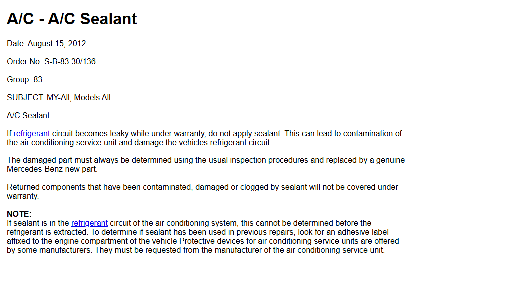

I looked up "AC Pro-R-134a" and all of the various versions im seeing say they contain a Leak sealer in the description. When I added refrigerant to mine I used just R134a refrigerant no sealer. In the MB manual it mentions not using a sealant.
Then again with the low pressure port reading 56 psi I wouldnt add any more refrigerant. when I added refrigerant to mine I stopped when the gauge was reading around 36 psi. My scanner was showing 9-12 Bar when running depending on the climate control settings.
