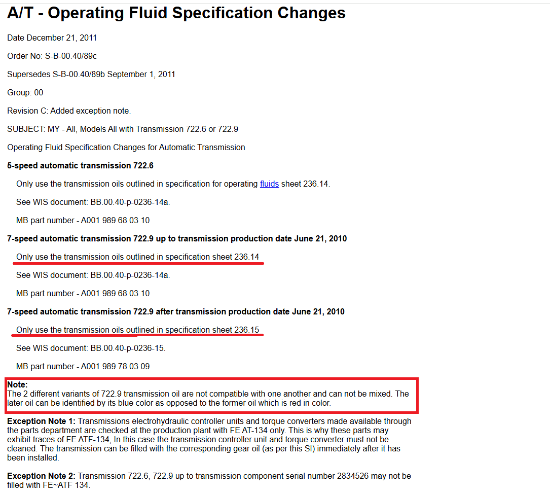

Old Aug 14, 2025 | 04:48 PM
TimC300's Avatar
Joined: Aug 2023
Posts: 3,567
Likes: 1,061
From: MA Coast

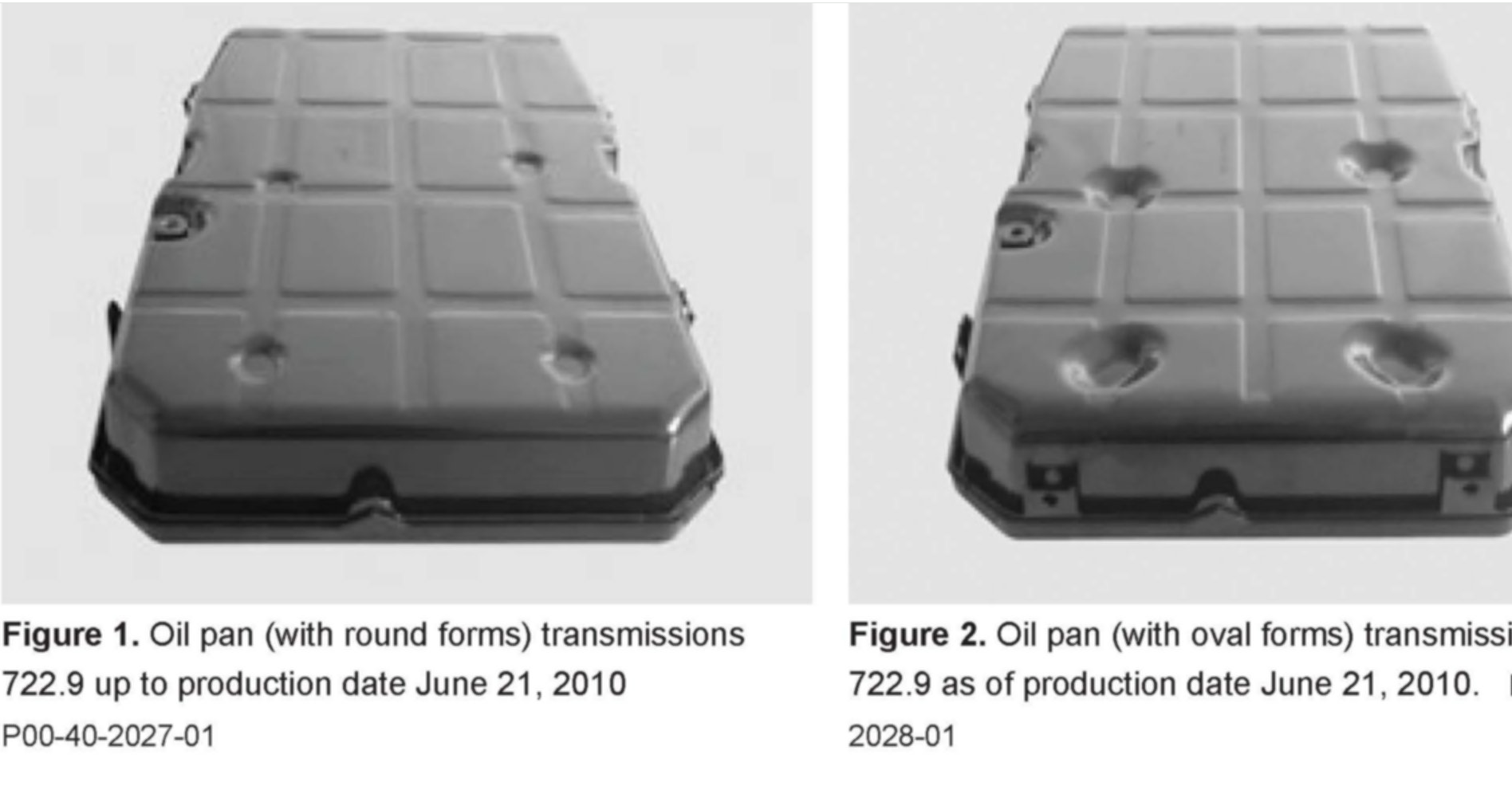

yes there is documentation from MB. The two different fluids are NOT compatible. They are clear to only use the fluid spec'd for each transmission.
Your vin would help to look up which exact transmission you have in it.
Can also look at the pan. Though I have seen some people install the later pan as an "upgrade" because it holds more fluid.

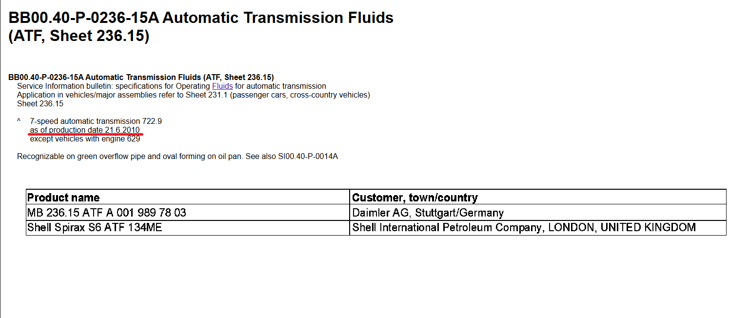

Hi, many thanks. I think this is the documentation I needed. To clarify, I know that there are specific instructions that .15 blue shouldn't go into the non-plus transmissions because of viscosity and all, but I've read anecdotes on this forum and other places saying that the .14 red was compatible with the 722.9 plus transmissions and that the only difference would be service intervals. Was just trying to pull some official documentation, specifically saying "only blue goes into 722.9 plus" to prove my point and force them to drain/flush it. Didn't mean to bring up an old topic, but honestly, they were being really stubborn about it being compatible, so yeah. Thanks for linking this. Hope this settles the argument with them.

You have found the official manufacturer’s documentation. Your shop should have honored that. The one notable issue is that they said red fluid came out. Last check would be to find the ID tag on the transmission itself and check the actual manufacture date on the transmission, not the build date of the car.
