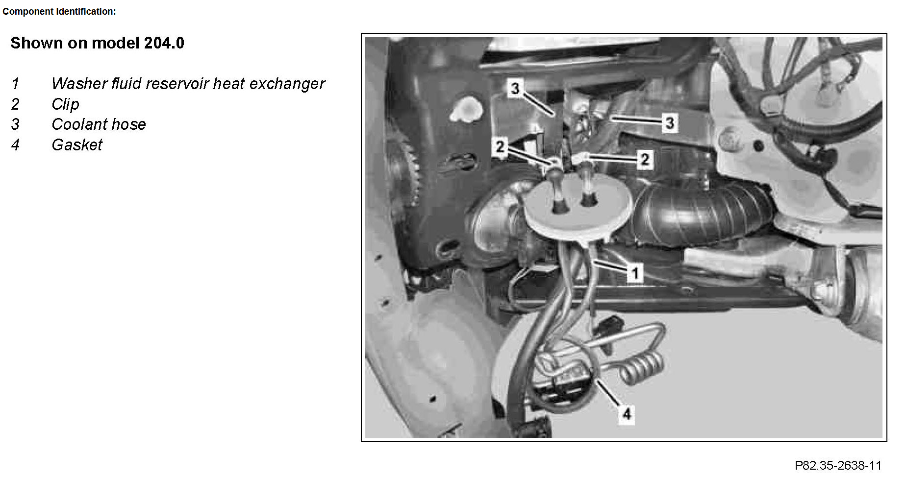

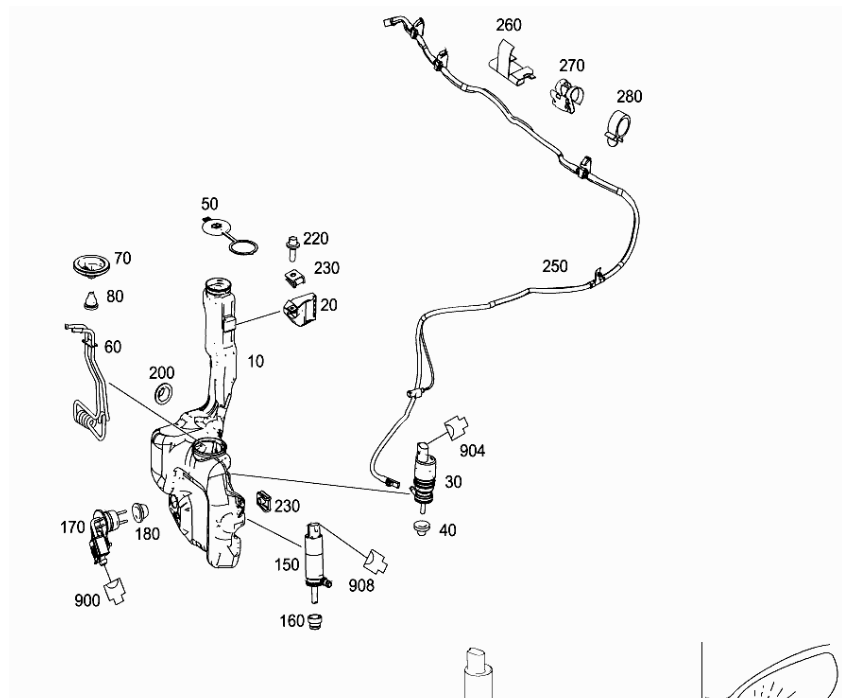

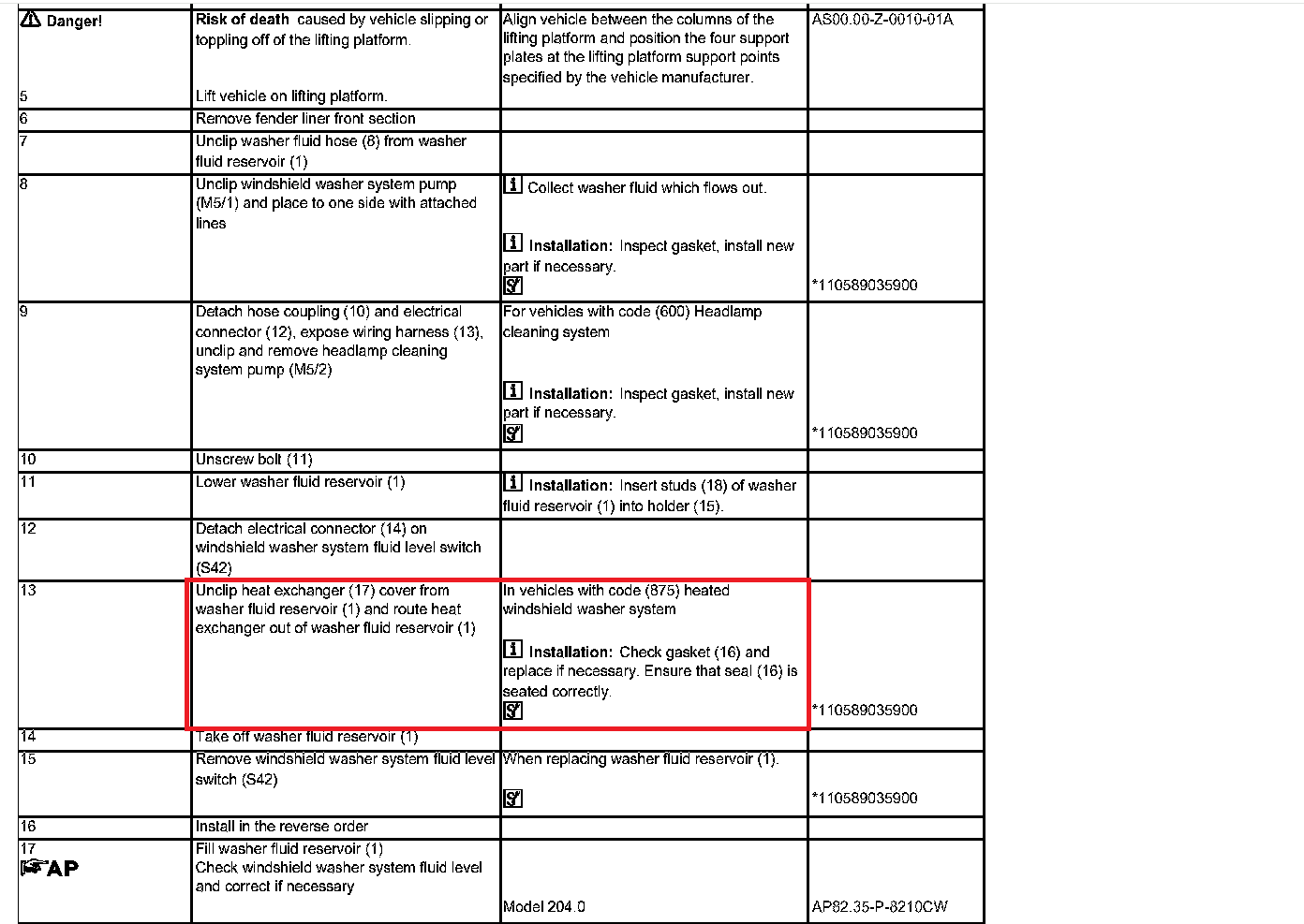

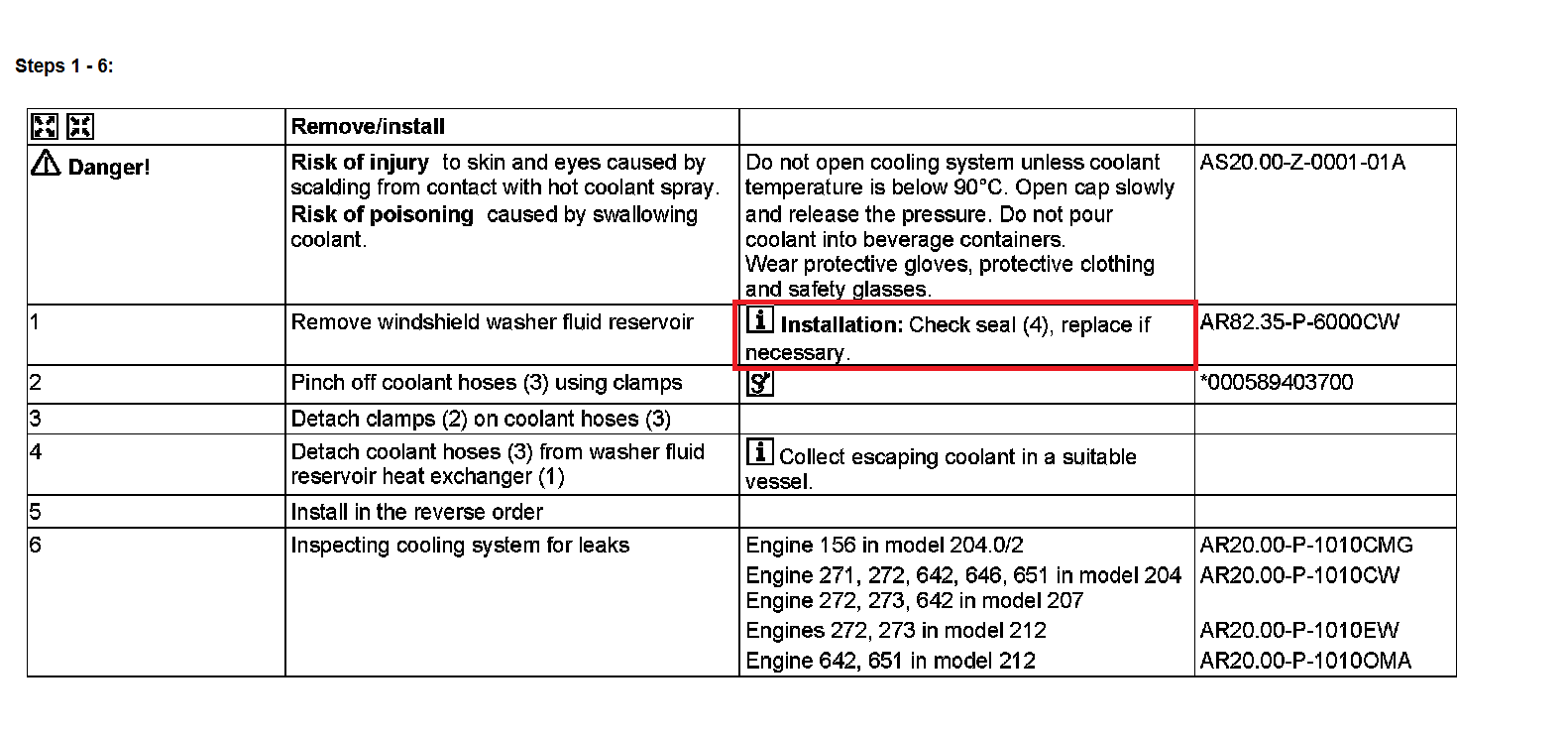

I never worked on it so not sure. Reading the manual it mentions checking the seal. (16, 4 in the diagrams below)

Thx for the response. Yes 16 the seal and 17 the lid won’t won’t snap over the lip on the reservoir 1. Really not sure it came off in the first place. What a PITA! I need a quick fix to get the car back to my daughter at college Saturday

It appears the seal is sold with the cover. Im finding it for $8.50 at my local MB dealer if theres one near you, pick-up no shipping costs. Part# 2038690208
Heres a link to the parts diagrams. Its for my 204.081 so im assuming you have the same: https://nemigaparts.com/cat_spares/e...81/62p/86/030/

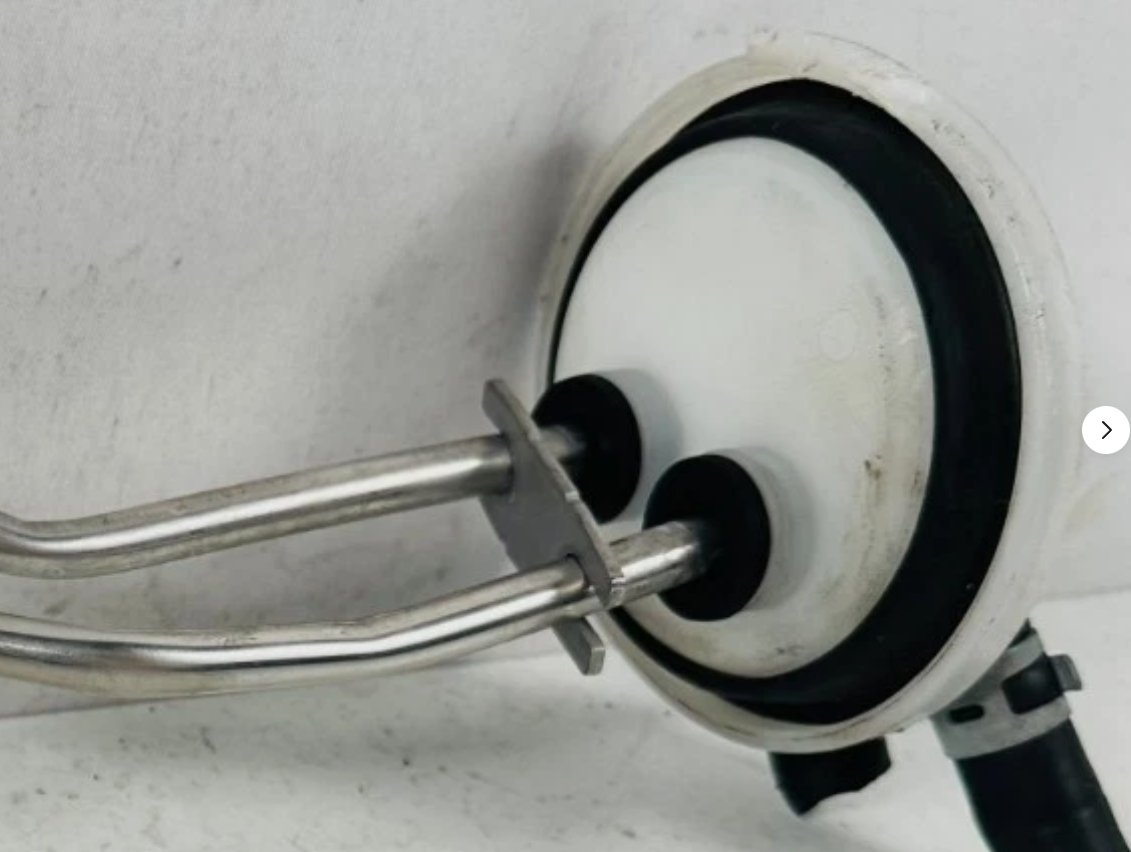

From photos the cover has two nubs, make sure those are lined up when installing.

I have those nubs aligned and that side snaps over the lip. It's the other side that won't snap closed. Even if I push that side down it will not stay?

Hard to tell without looking at it. Im assuming that cover just snaps on the same way the blue fill cover up top snaps on. How does the lip on the reservoir look, deformed at all, plastic softer than it should be?
How does the metal coil assembly fit inside, is it touching the bottom of the reservoir maybe pushing the cover back up? From photos im seeing a black nub at the bottom that may fit in the reservoir a certain way.
How does the cover fit without the seal installed.

I was looking at photos of used covers for signs of how it goes on. To me it looks like the gasket fits inside the lip of the reservoir. Im assuming that pushes outwards on the lip and the white cover can snap on?
In the manual for removing the cover it states "unclip".
