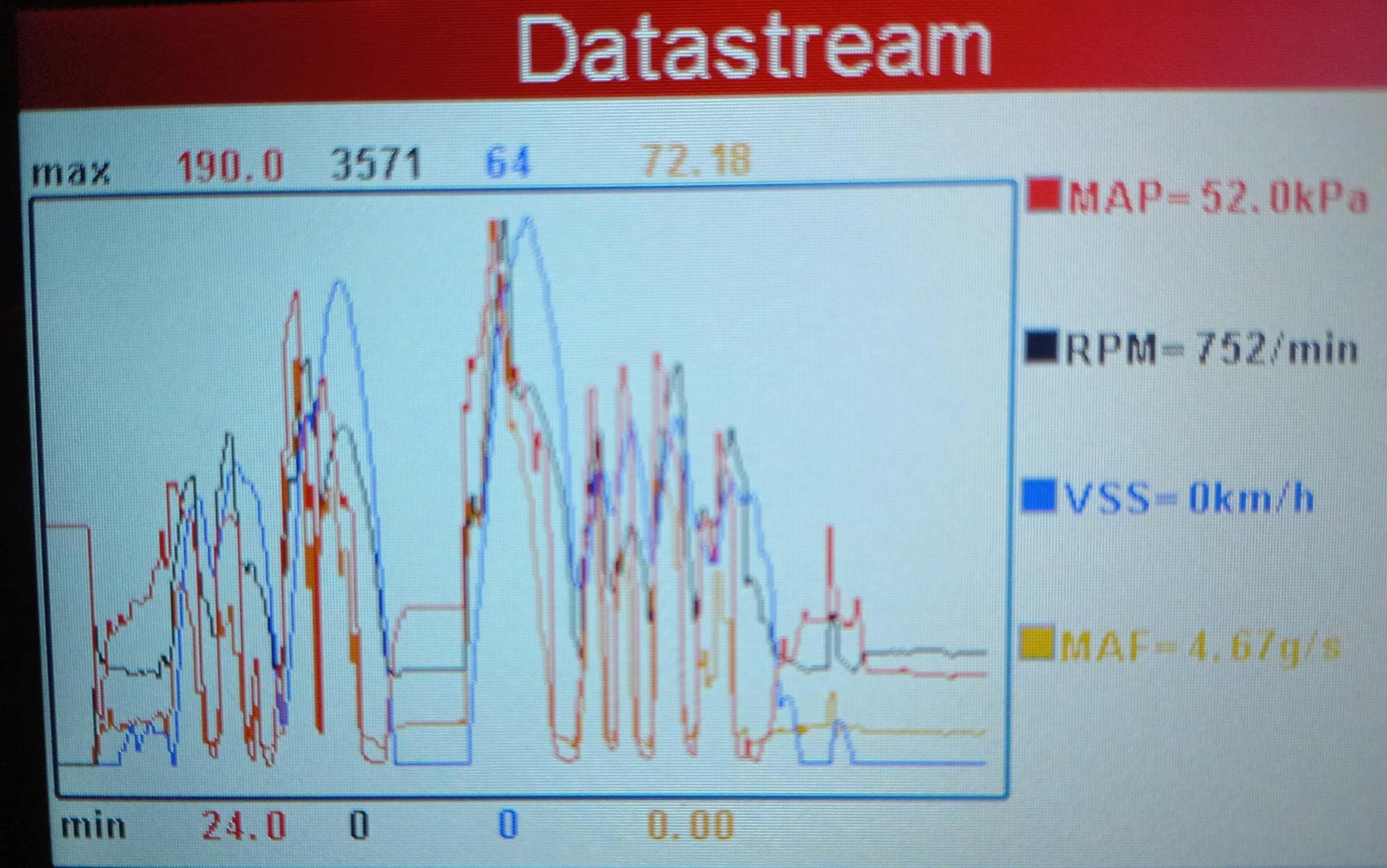

My 2010 CLC200 (M271.957 engine) is suffering from a mysterious loss of power – it can hardly drive anymore. During a short drive around the corner, the RPM goes up to just under 4000 before it shifts into the next gear. At first I thought the transmission was malfunctioning, but my highly experienced mechanic immediately determined that the engine was lacking power/torque.
I recorded the following data with my own iCarsoft MBII tool:
MAP – Manifold absolute pressure (pressure in intake)
RPM – Engine speed
VSS – Vehicle speed km/h
MAF – Mass airflow
The intake pressure goes up to 190 kPa! Is that normal?

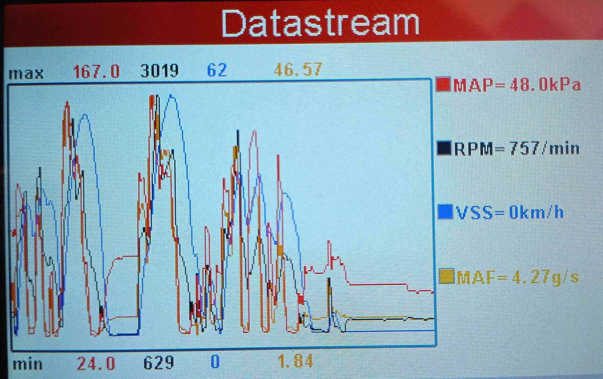

Signals driving around the block
This time cam adjuster plugs removed
Then I repeated the drive, this time with the camshaft adjuster plug removed.
It was a lot better, but still bad. This time, the pressure only goes up to 167 kPa.
Is there something wrong with the timing chain?

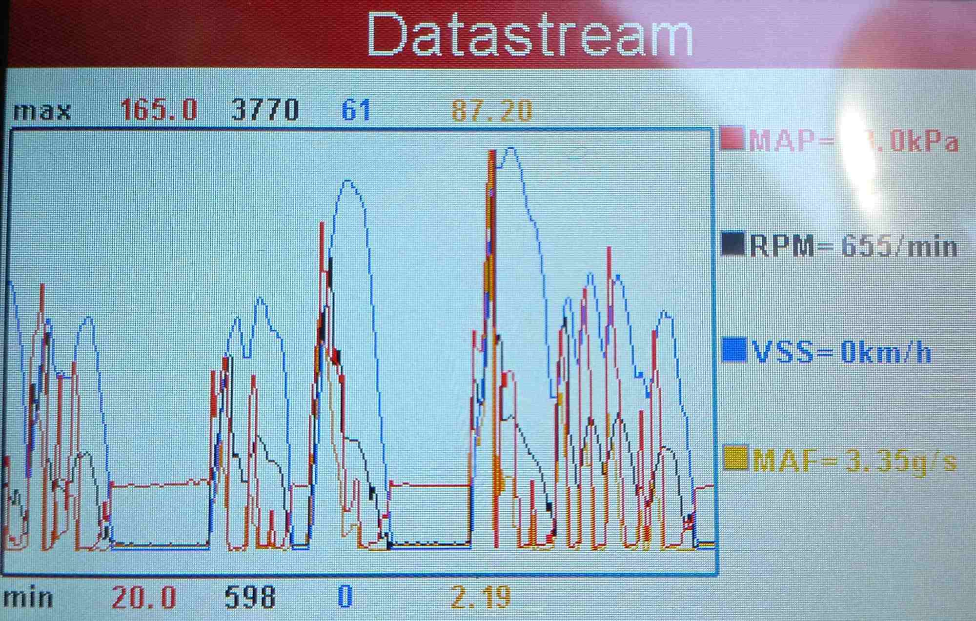

Below a trace of the vehicle driving beautifully again.
Key difference: MAP only rises for a very short moment when accelerating, dropping right back thereafter.
(the reflection conceals MAP=43, but that's just the reading at idle at the end of the graph)
