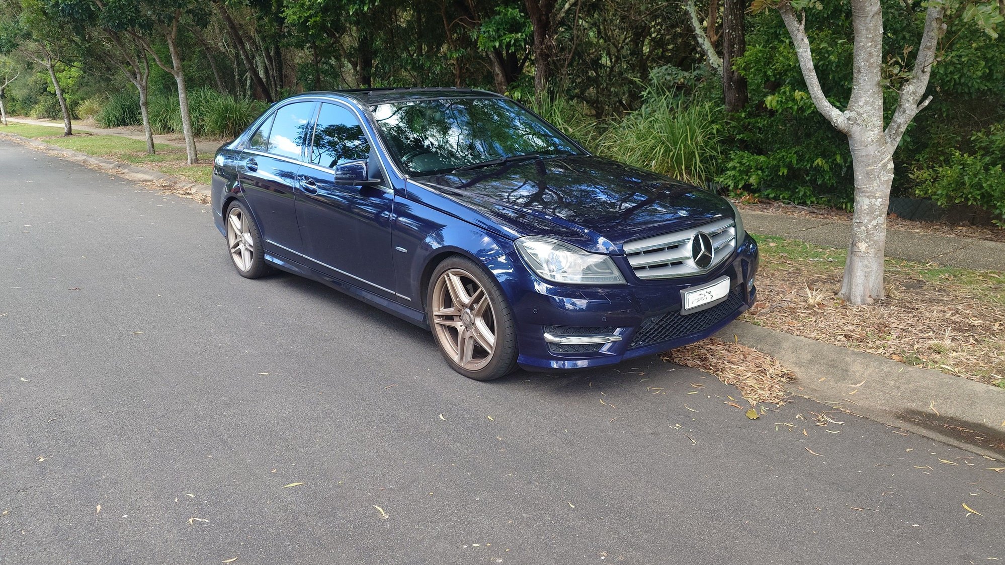

Finally got my dream car the W204 C300 with every option possible in navy.
Love the look and how much it really makes it transform with the AMG pack.
This car had literally every possible option other than rear camera so that's been great.
