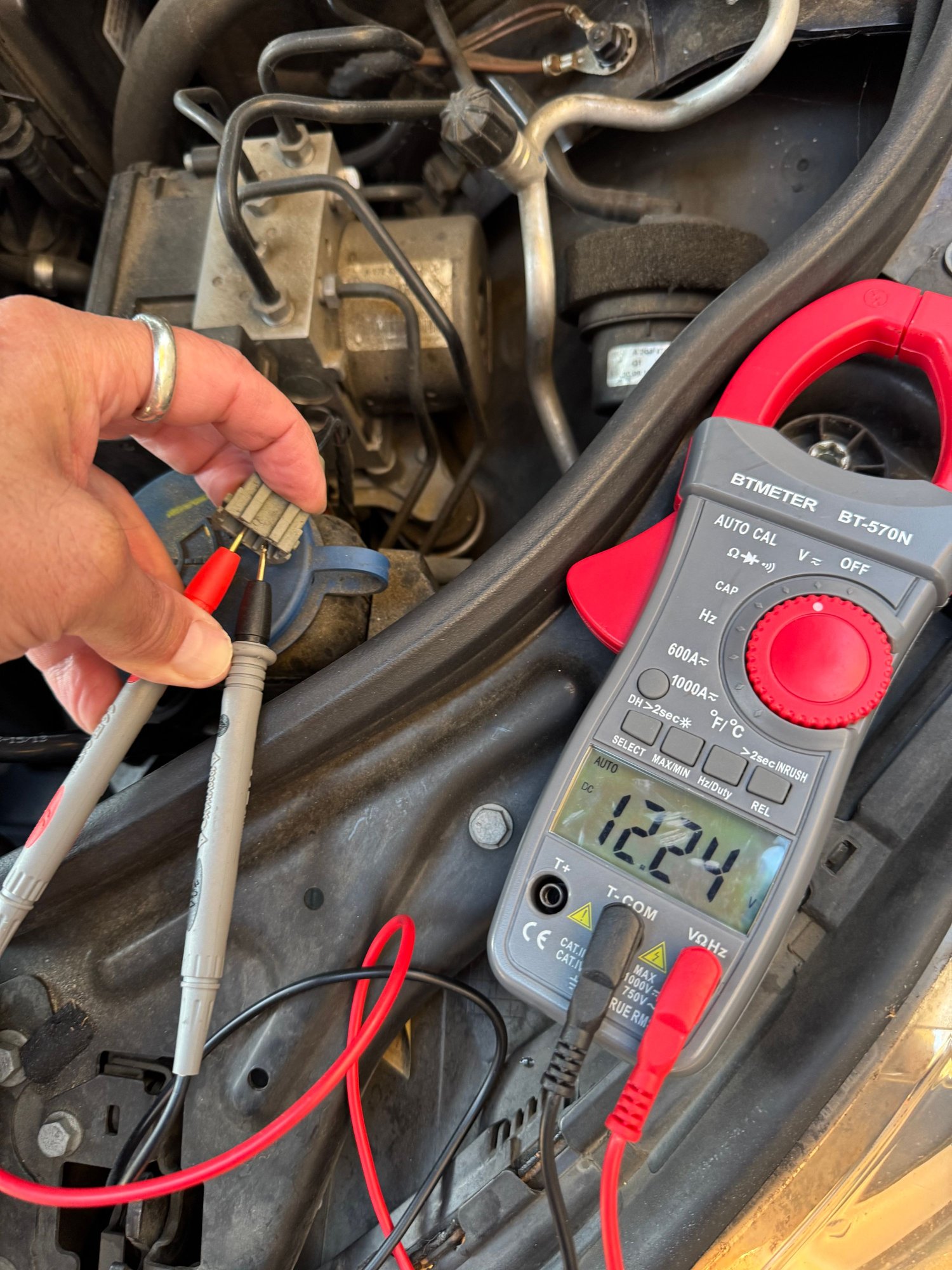

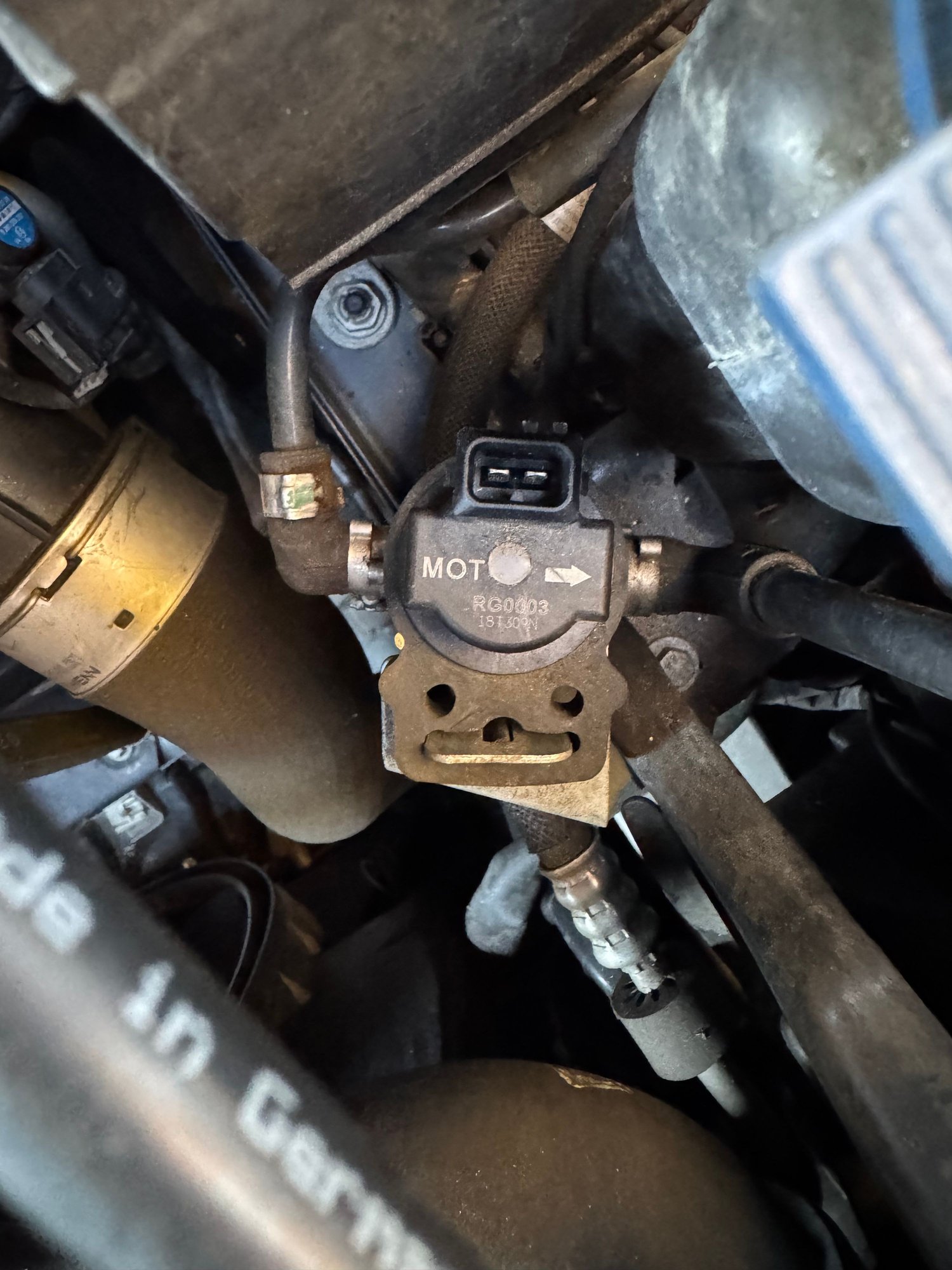

I have a 2014 c250 w204. Initially I was getting codes p0441 and p0451 with an intermittent check engine light. I replaced the gas cap (orig looked fine though) and that didn't change anything. Dealership replaced purge valve a few years ago, so I skipped that. Next I replaced the tank pressure sensor. After doing that the codes changed to: p0442, p0451, and 2422. Today I checked the purge valve, and inflow is blocked with car running or off. I connected 12 volts to the purge valve directly and could hear the click, and inflow it was no longer blocked. I then tested the connector with acc on and saw 9V, and then again with car running and got 12.25 V. If the connector has 12v with car running and purge vale opening with 12 volts hooked directly up, then what could the issue be? I included some pictures.

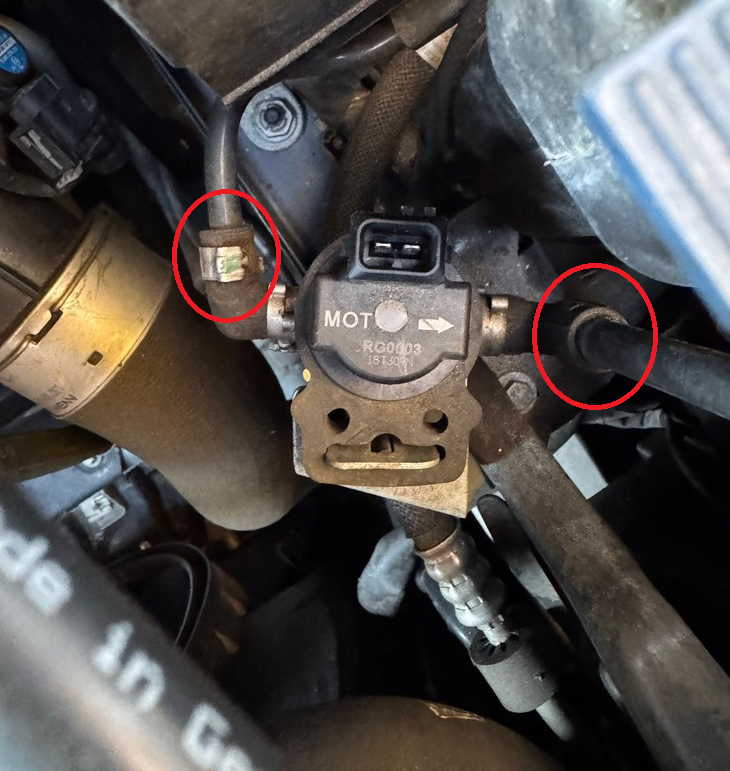

Photo looks like one of the purge valve clamps is not connected and one seems to be missing.

I hadn't noticed that before but now that you mention it, theres another clamp missing from the purge valve out to the engine intake. Dealership must have decided not to put them back on.

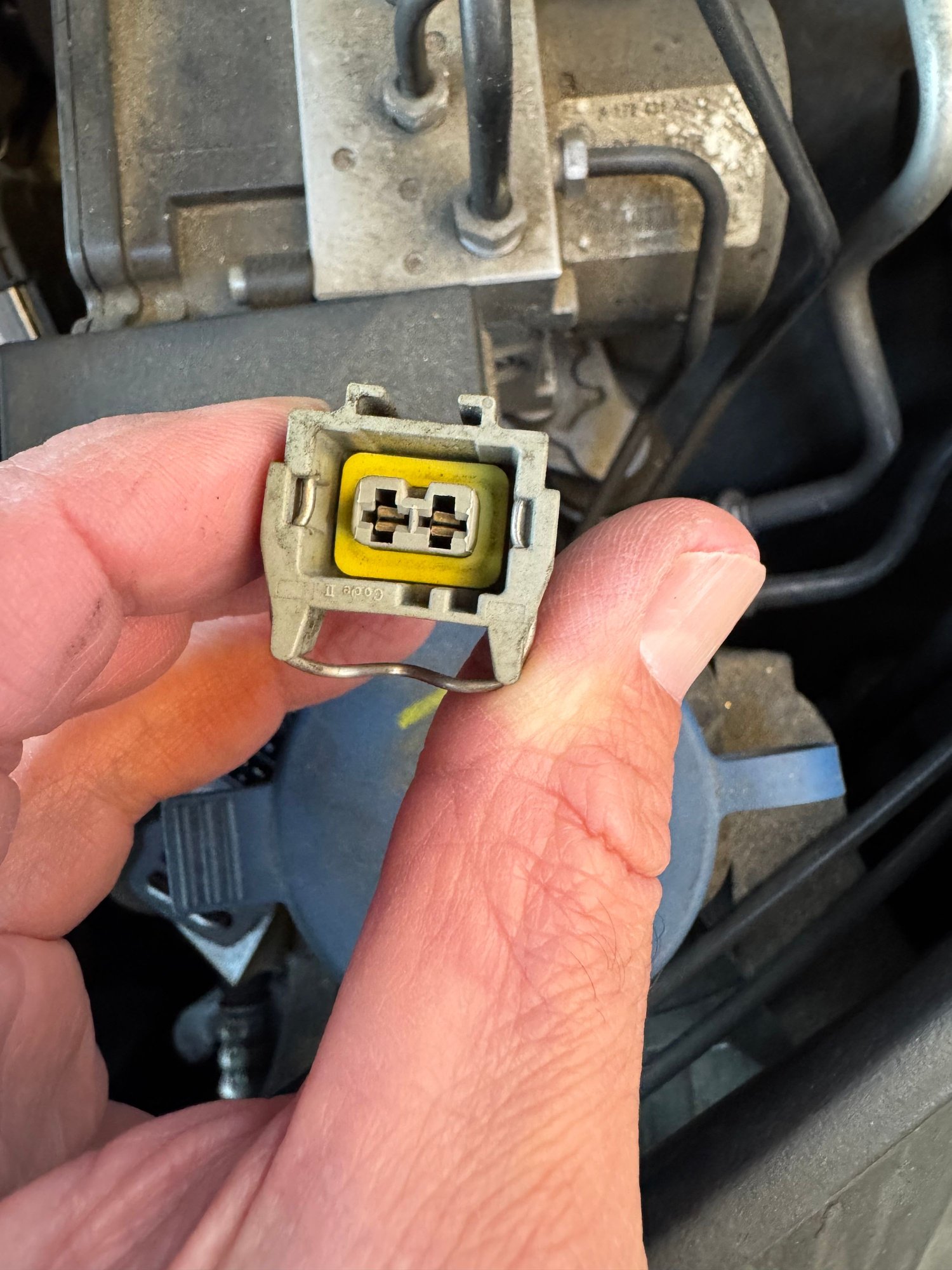

I am mostly stumped by the purge valve working when direct 12 v is connected to it, but doesnt work when I connect the harness to it and run the car. I did check the harness and its giving 12.24 v. Connectors look clean....

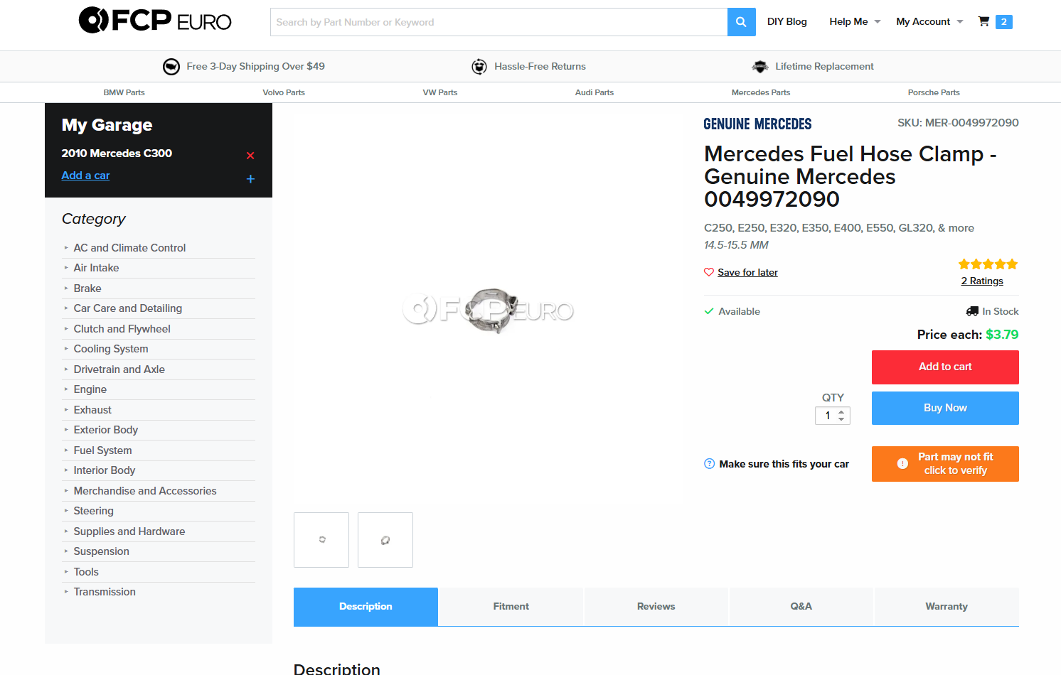

I am going to put some clamps on today to those hoses that are missing them and see if anything changes from that.

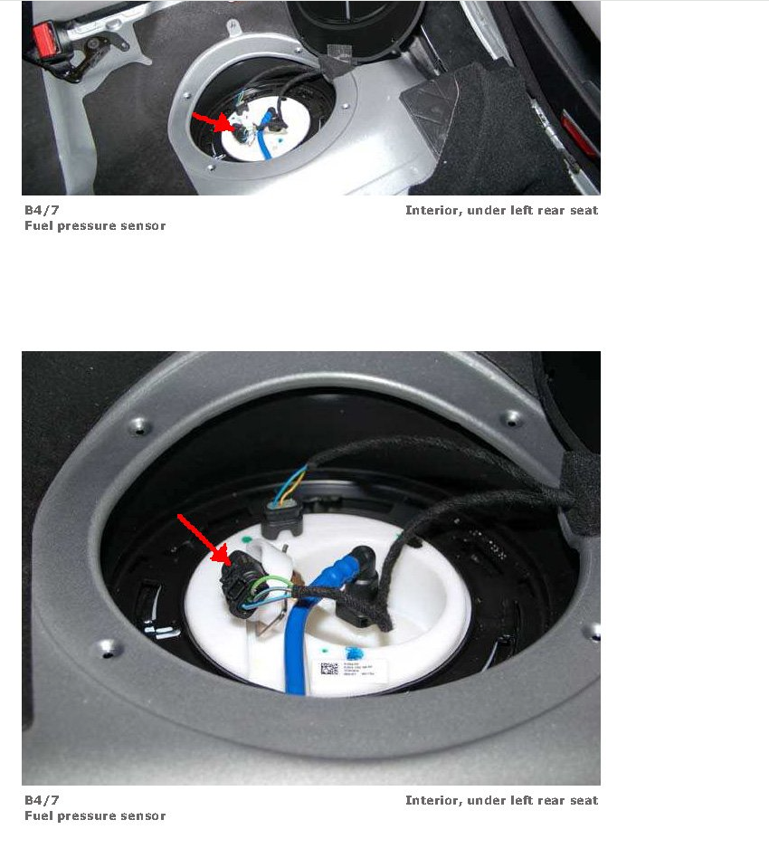

Are there two different fuel pressure sensors?
Are there really two fuel pressure sensors and which one is the problem with the codes 0441, 0442, 0451, 0452, 2422?
I replaced the fuel pressure sensor thats accessible from on top (under back seat, drivers side) twice, no change. The other fuel pressure sensor supposedly needs the tank lowered to access it.

I dont have access to the 2014 C250 manual so im trying to use comparable manuals but dont know what engine you have or what parts diagrams to look thru.
If the code is for the B4/3 fuel tank pressure sensor it looks like its on the top of the tank in the middle. Not the sensor near the pump/filter.
