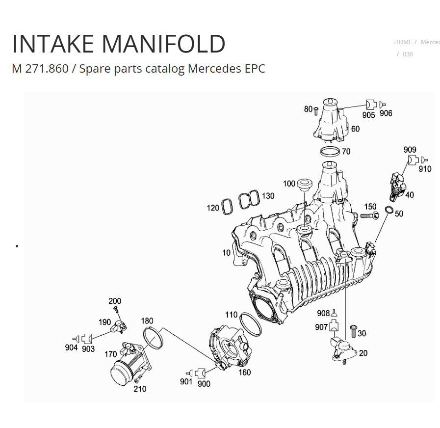

I am totally guessing on what may be the issue. The charge movement flap in the codes listed may be the swirl flap motor (part 60 in diagram)

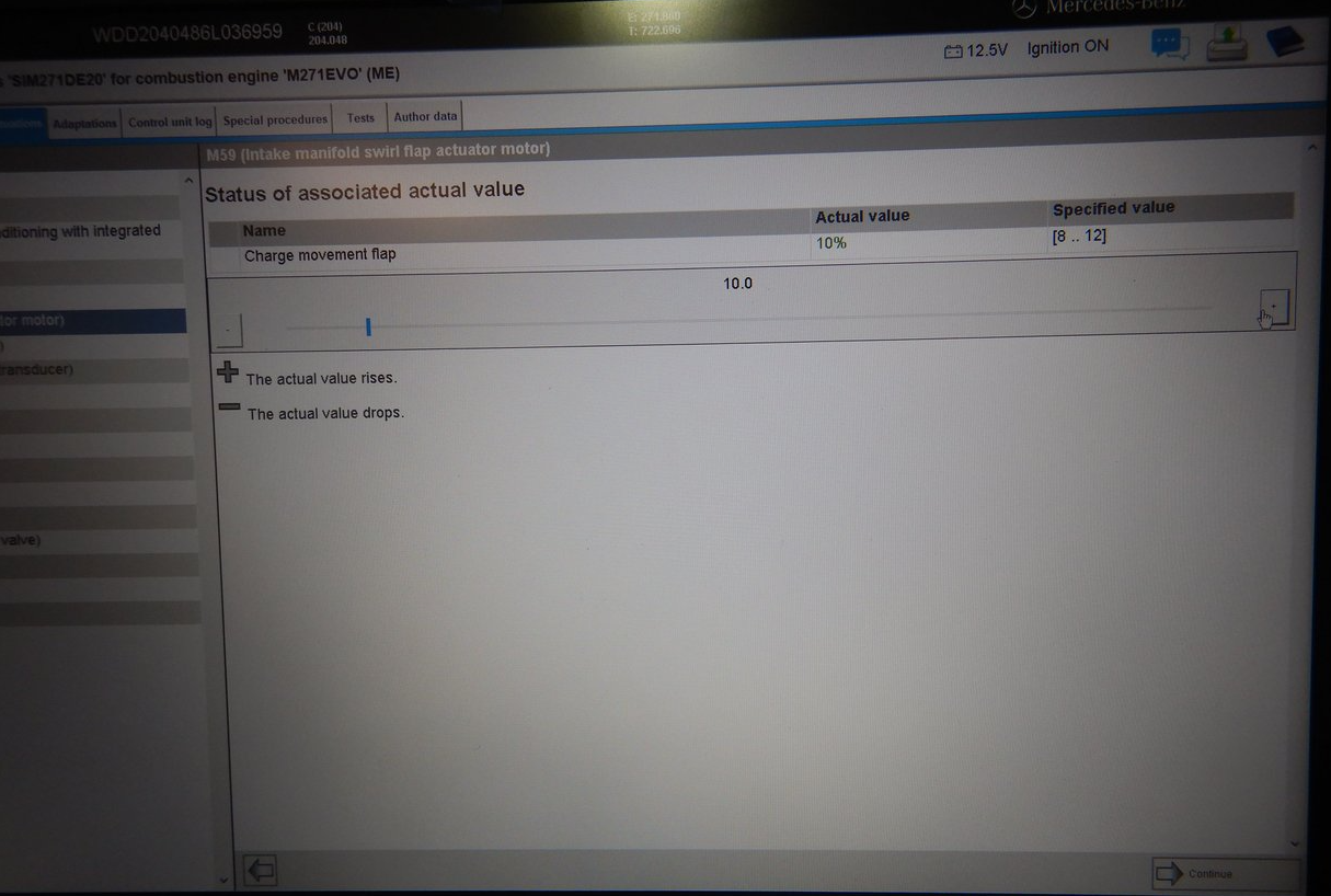

Appears confirmed the swirl flap position sensor is in the motor housing. The motor looks to have 5 pins which matches the electrical diagram kindly posted in the above linked thread..
I think with the appropriate Mercedes specific scanner you can see what the sensor is reading, is it within spec or is it not reading at all. Can also actuate the motor it seems 0-100% with the scanner and see if it is functioning.

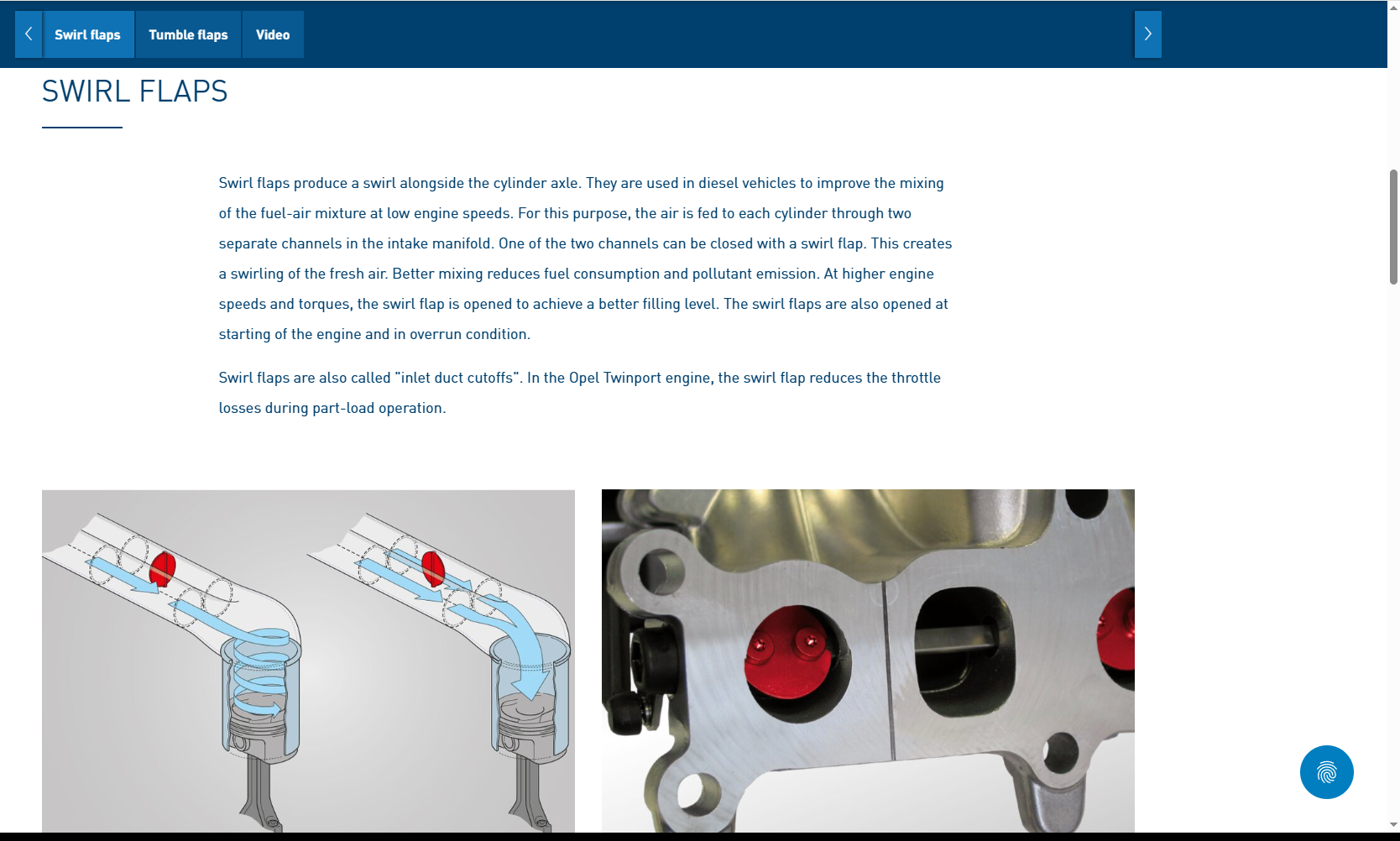

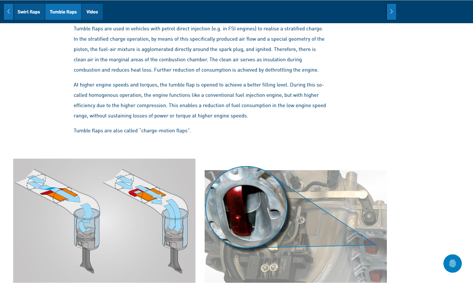

Quick overview of swirl and tumble flaps:
