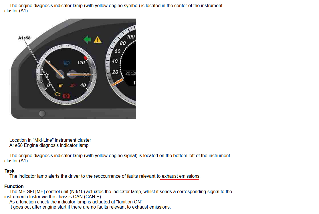

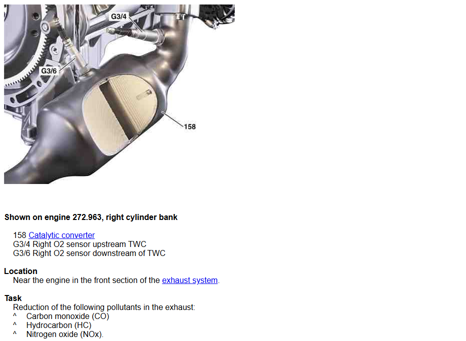

Seems the EPA has restrictions on installing used cats and they have to be tested and properly labeled which I doubt anyone will go thru that trouble. And then certain states have additional laws about it. Im in MA where they test for emissions so im sure the laws on salvage/resell/install are long.
Ive seen new aftermarket replacements for around $400 simple bolt on. Can find used "downpipes" for around the same price. No idea how good they are.
I havent seen cats failing being a big issue. They are expensive parts just because what they are made of so it is important to maintain the car in good running condition. Make sure to address anytime the check engine light comes on which indicates possible damage to the exhaust.
