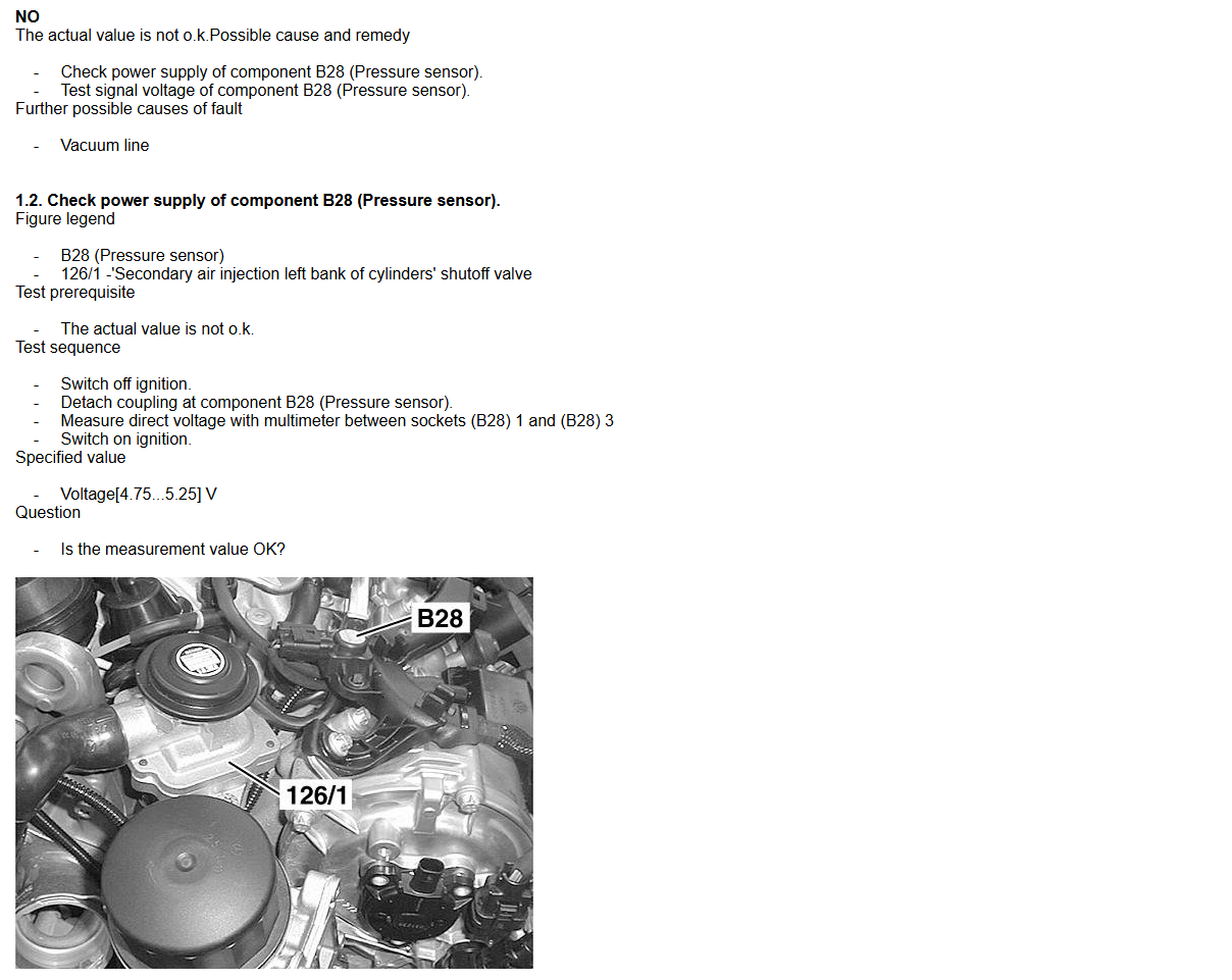

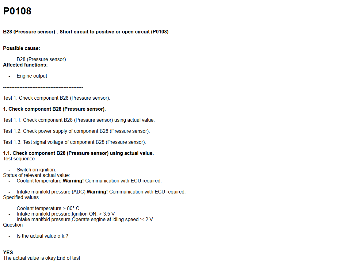

Here is what I see for the P0108 fault code. Its under info for my M272 though should be similar to your engine.
