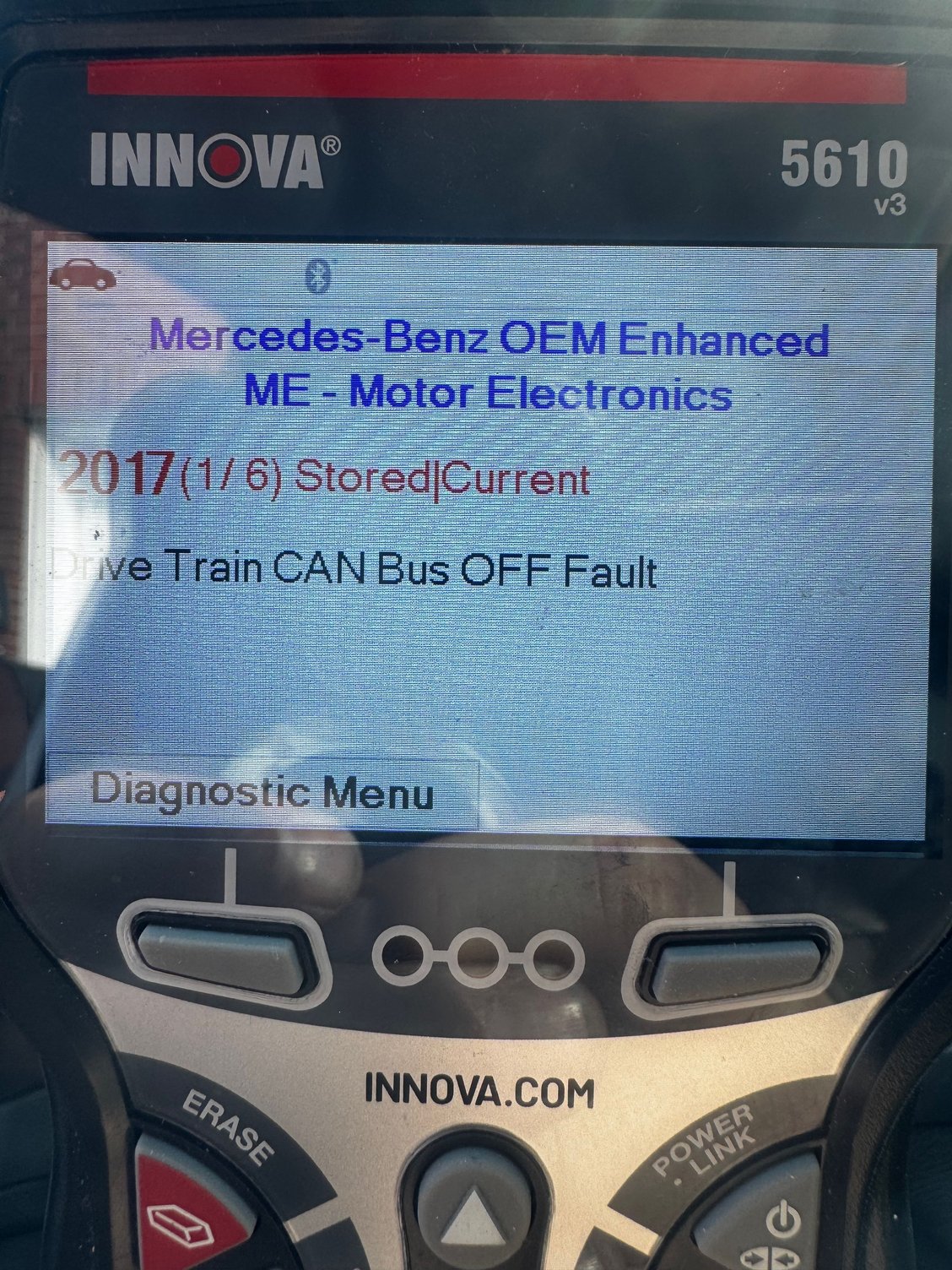

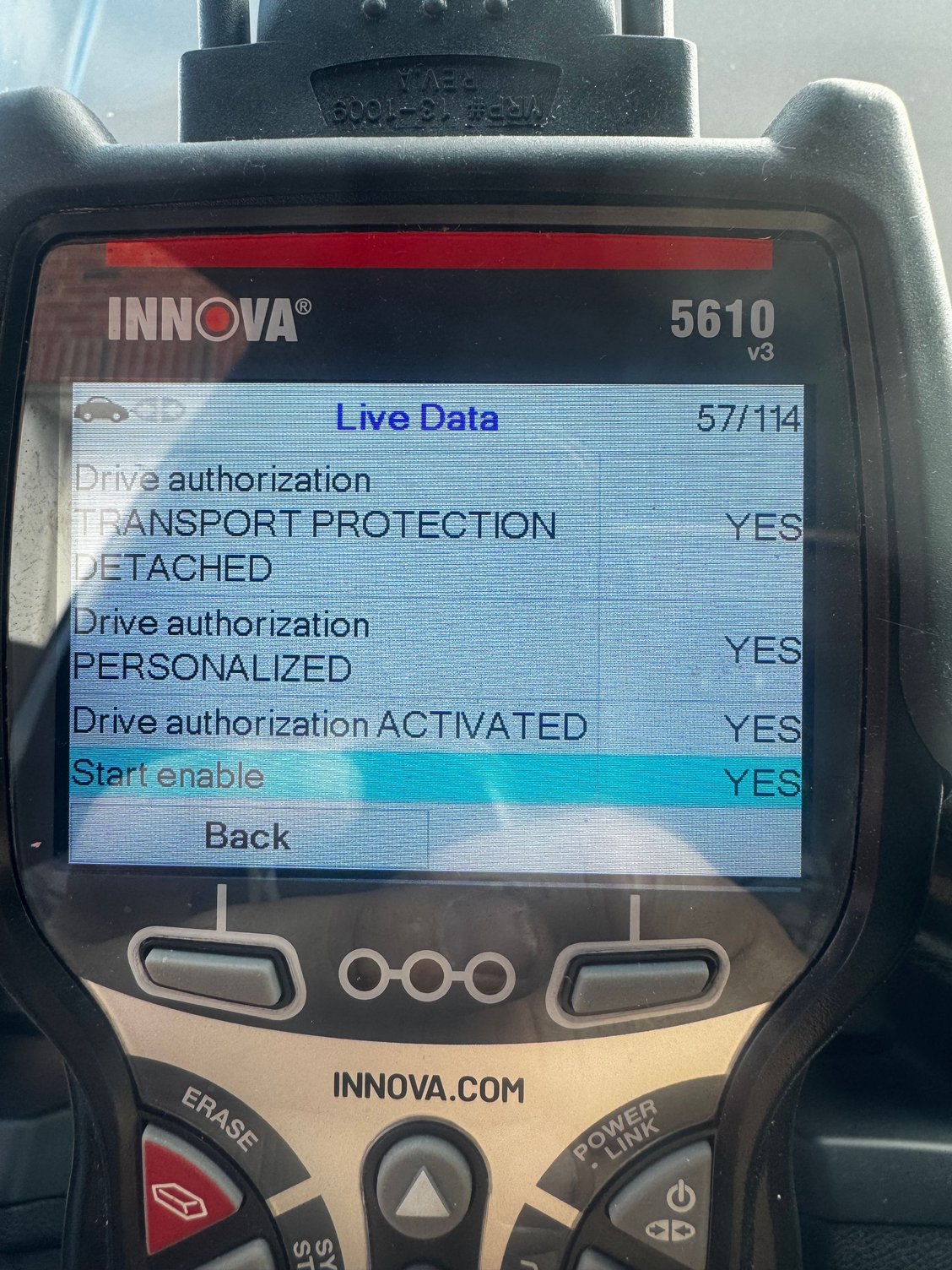

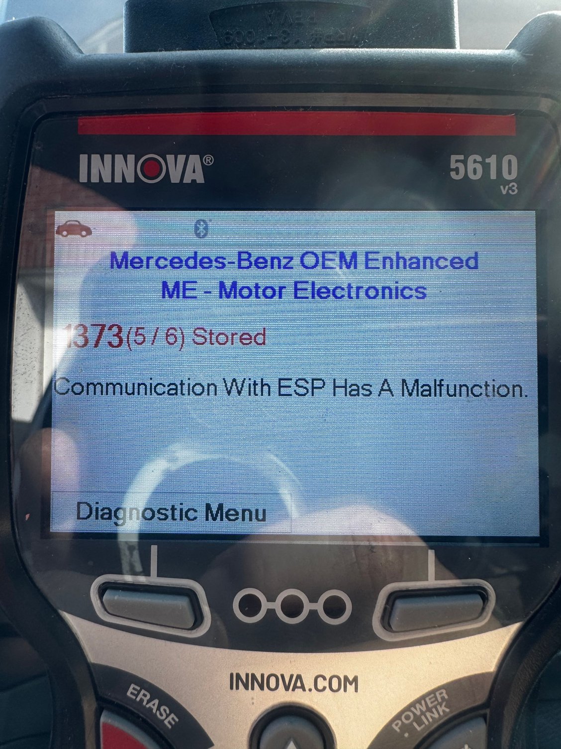

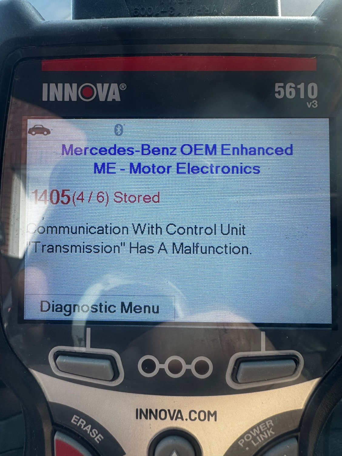

I know this isn’t as detailed as a good diagnostic tool but it’s what I currently have. After clearing the codes, only the first one shows.

I think your scanner is fine. Drive train CANBUS OFF fault can result in a no start and maybe even a no crank situation. The paper wad in the shifter indicates a mechanical issue in the shifter that may affect the selector and the CANBUS OFF could point to corroded CANBUS connector. Ask the neighbor if the car ever had an A/C drain clog that got the front carpets wet. That’s a common place for this to occur. The connectors under the driver side door frame plate are also prone to moisture and corrosion. This can be a difficult issue to chase to ground, but ultimately solvable.

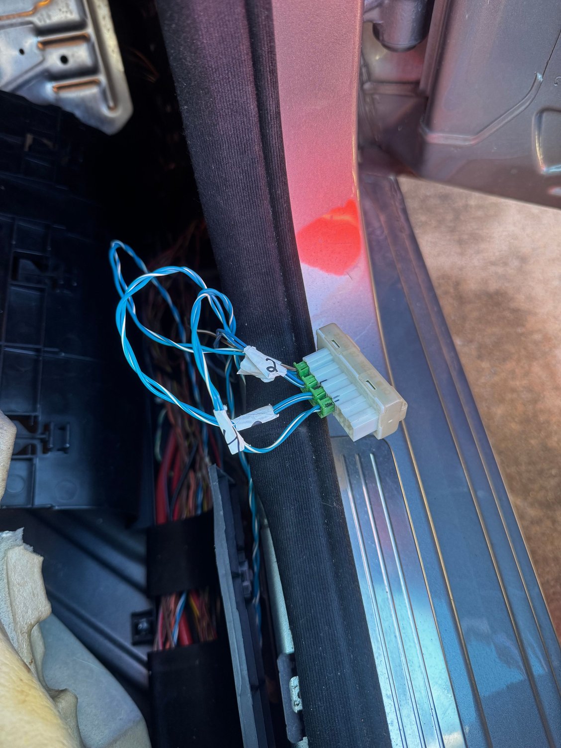

So... I found the CANBUS on the drivers side and cleaned it. No change...
I found one of the CANBUSs on the passenger side. Cleaned it and it started. Took it for a quick drive and the transmission was shifting HARD. I brought it back home, turned it off and tried to start it again. Nothing...
Wanted to really clean that CANBUS again, but didn't know if the wires were specific to that port so I labeled them. Took all the wires out at once, removed that plastic bottom part, scrubbed the h3ll out of the bottom with a brush and alcohol again, used a precision flathead screw driver to scrape the pins, then used the largest tip cleaner that would fit in the 2wire plugs and scraped the inside as well. Put the wires back on in order, stuck it in a small zip bag with silica, zipped it to the wires and then used electrical tape to seal the wires and bag the best I can. Put it back in the car with the bag opening on the bottom and then ran the car around town for some weekend errands, starting and stopping multiple times and shifting smoothly. All seems to be good now (as far as it starting). Thank you everyone for your help. I will be starting new threads for the other issues if I can't figure them out on my own. See you guys there...
