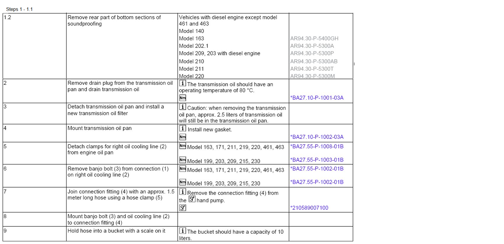

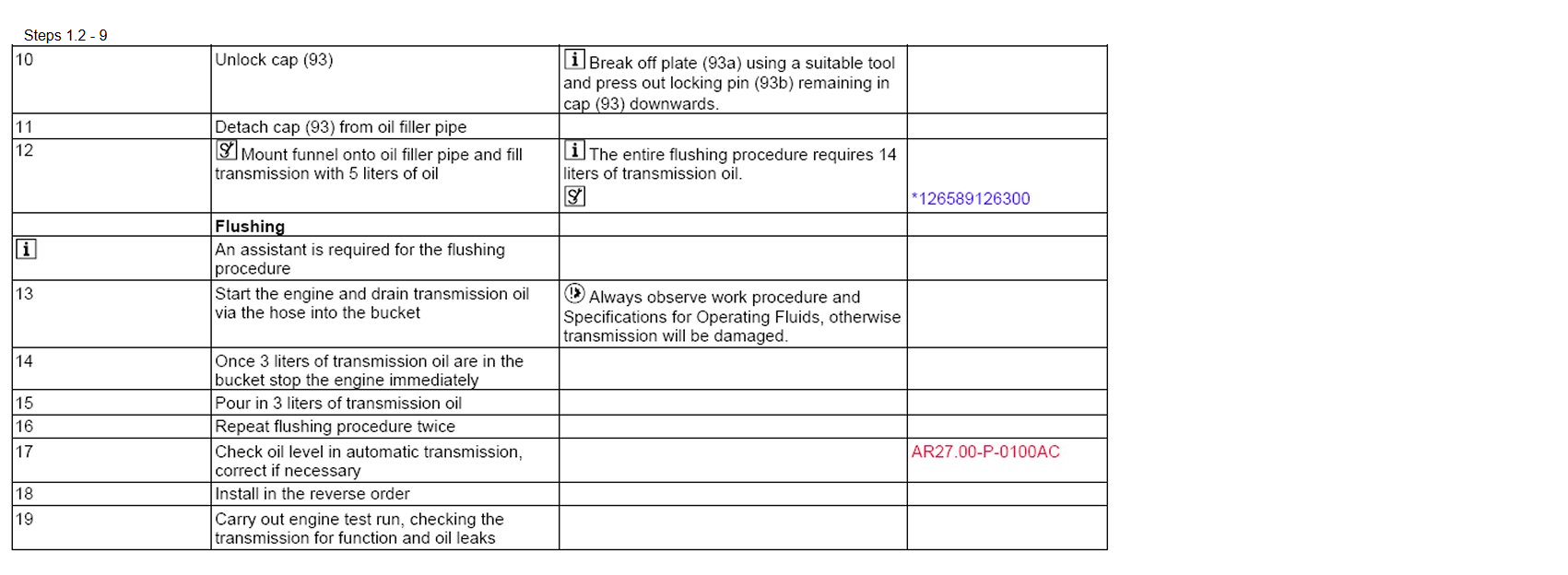

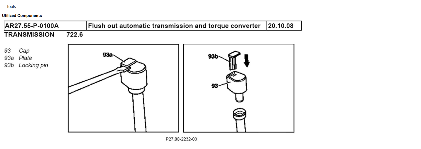

The procedure to flush the 722.6 transmission and torque converter is fairly straight forward and nothing special is needed with the torque converter.
You have the transmission dipstick correct/filler pipe correct?
Manual says basically drain the fluid, remove pan and replace the filter, reinstall the pan.

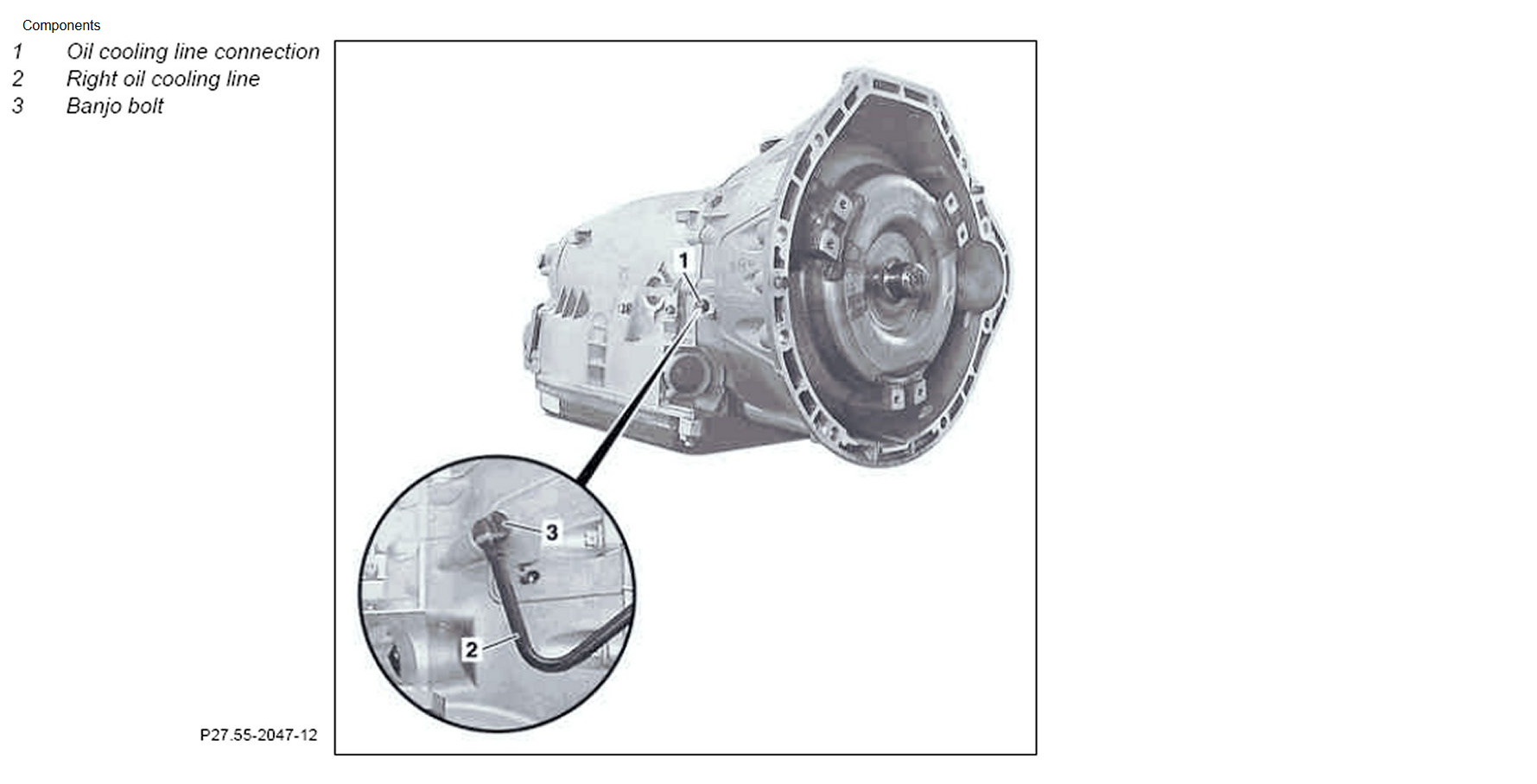

Remove the right side cooling line on the transmission and connect it to a hose to allow fluid to drain into a bucket. using the filler pipe add 5 quarts fluid, run engine until 3 quarts fluid are drained out the hose, shut off engine, add 3 more quarts, repeat.
Heres a link to what I was looking at: https://charm.li/Mercedes%20Benz/200...e%20Converter/
