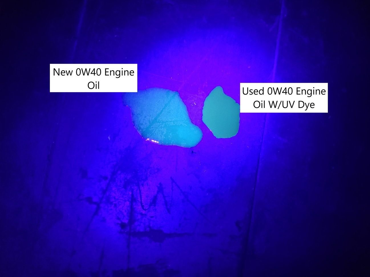

Can always try a UV dye to try and detect the fuel leak. But if you do I recommend using a UV light and look all around the engine bay first to see what it looks like in there. I used a dye in my engine oil only to realize the oil I use glows green on its own nevermind with a dye in it, so for me it was useless.
