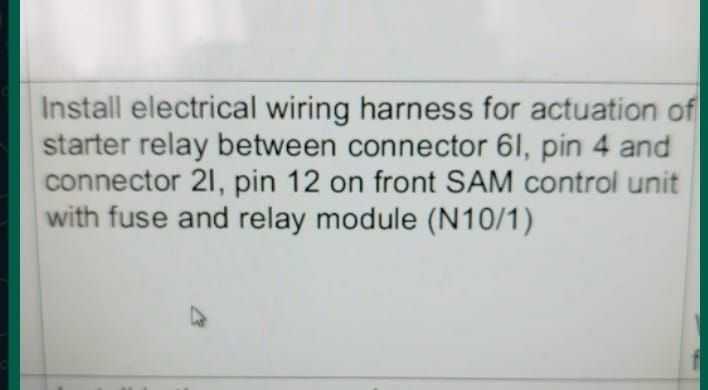

I went ahead and went the direction of getting another SAM module with same part number as the original. So now I would like to know HOW plug and play is this option? Do I not have to do anything for the SAM to know that it lives in a car with a different VIN or anything? Also, from what I was told the LAUNCH X431 Pro I currently have has a feature where you can do a backup of the coding on the original SAM and the restore that to the new SAM. Anybody know if that works or of anything else I would need for completing this process of a SAM module swap out with same part number?

If you have the same part number, then the coding can be copy/paste with any tools, even with generic Autel/Launch, supposing that none of the SAM's received any SW updates. This can be checked reading the SW version from SAM and CGW ( both are inside of the SAM module)
Generic tools, can't determine the Diag Versions of any Mercedes module as they are based on a generic version of the Software. So, sometimes read and write different or incomplete parts of the coding if those tools missed the correct version.
On the other hand, a 15$ Openport and a specialised old Program like Vediamo 4 free on internet or very cheap, can read the codings ( SCN codings) in human real text and can write with help of the user into any SAM, even if the the reference number or HW / SW differ.
