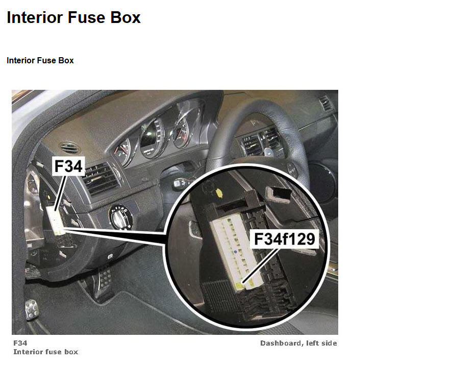

I really dont know the answer. I usually install aftermarket stereos in my vehicles but gave up after seeing how complicated it would be with a mercedes.
I wonder if you can tap in at the fuses to the left of the steering wheel? See if one of the slots is always on.

Thank you for your reply.
My car doesn't have this fusebox, however by running through there, I have found an entrance through the firewall into the engine bay (driver side, EU) fuse box.
