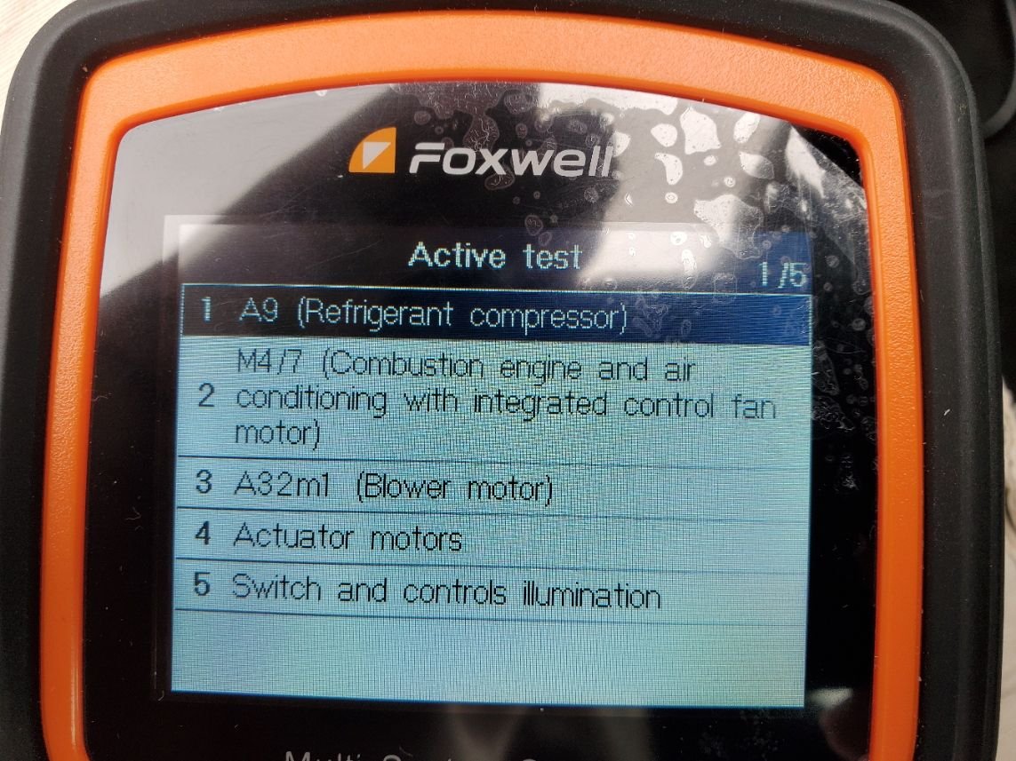

I'm assuming you have a Mercedes specific obd scan tool you are using.
My Foxwell has an option to show causes for shutoff of the compressor. Tests for various reasons. one thing it shows mention the break-in of the compressor. Im not sure what that is, but did you do some type of break-in with the new compressor?
What about fault codes, does it show any related to the ac or climate control?
You mention you can see the amps at 0.98-1.0. I have only seen mine go up to 0.950 mah. And thats at Max setting. My scanner has an option to function test the compressor. Use the scanner to control the compressor, starting at 0% up to 100%.
And the overhead N70b1 sensor shows very high on mine. Doesnt seem to have any effect on the ac working properly.

What type of refrigerant was installed, R134a plus oil? I had warm air coming out last summer and the pressures appeared low so I added a few grams straight R134a. After doing some more research I think I should have also added a little bit of oil also. But thats besides the issue here.
With the climate control ac light blinking it means the car is detecting some type of fault and shutting the compressor down. Have to see what that fault is. I'm sure a scan tool can show what the fault is and reason for the shut down.
The climate control unit (N22/7) itself could be faulty.
You mention replacing the pressure sensor. I'm assuming that is the sensor (B12) located on the condenser? With the engine off and car parked for awhile what does the high pressure read and low pressure read? From my understanding the pressure should be equalized, high and low reading same pressures. I could be wrong but mine seems to be that way. For high side I use my scan tool that shows bar, low side I use a gauge connected to the line, gauge shows psi. So have to convert bar to psi.
