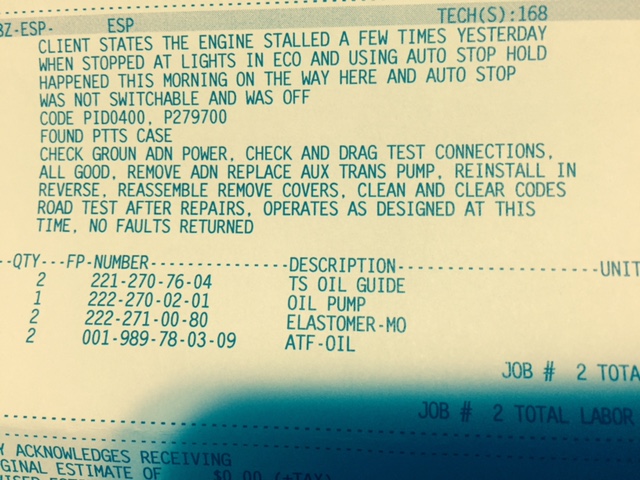

Yes, see my post above. The dealer, working with Germany, found it to be the aux transmission pump. Let me know if you need me to look up error codes the car had.
Since the repair in late June, no issues.

Awesome, I'll let them know next time I'm there. Would you mind sending me a PDF or image of you work order? that would be amazing! my dealer never trusts any internet diagnostics. lol. Had issues in the past.

Tried to PM - didn't see where you can attach. I have the relevant part (codes and what they did) of the work order in an attachment to this message
Awesome, thank you!
