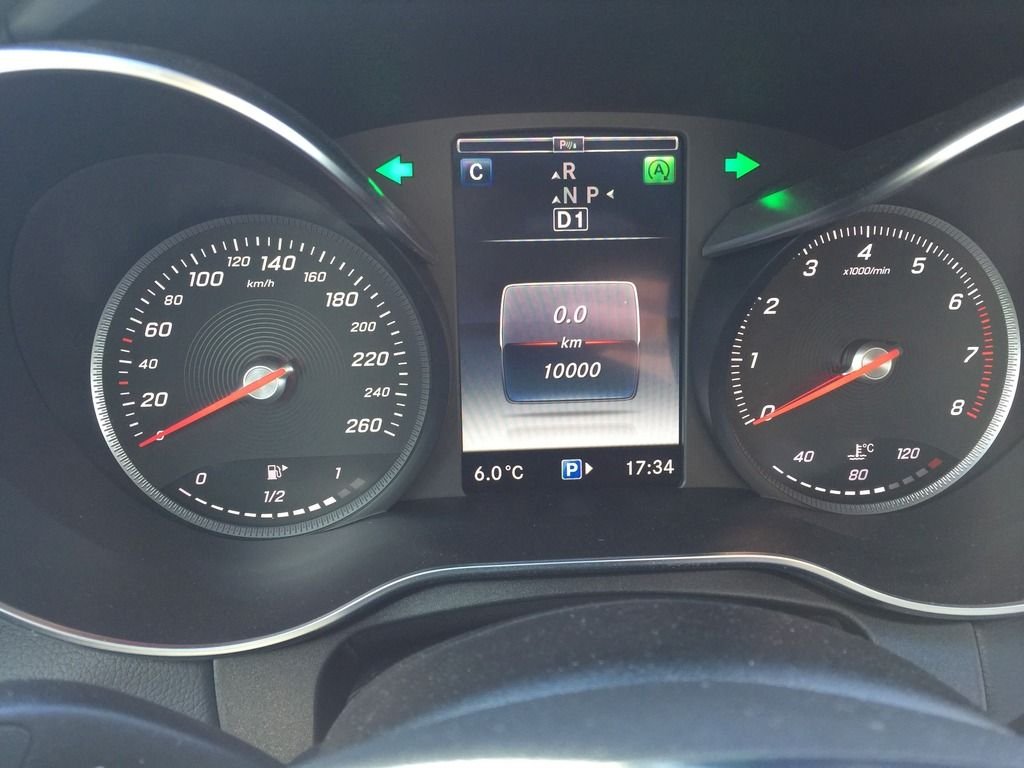

Took these pictures yesterday. Car has now done 10.000km in 10 months.
Only one arrow whilst in speed. You can shift from Drive to Neutral.
Standing still or in low speed all arrows for all actions available. Push up gently for Neutral, or push harder for Reverse, or click button for Park.
